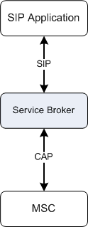

Figure 3-1 shows a SIP charging application that interacts with the MSC through Service Controller.
Figure 3-1 Architecture for Interacting with an MSC
The application communicates with Service Controller using a Service Controller's SIP interface provided by an IM-ASF interworking module. An MSC uses a Service Controller's CAP interface provided by an IM-SCF CAP interworking module.

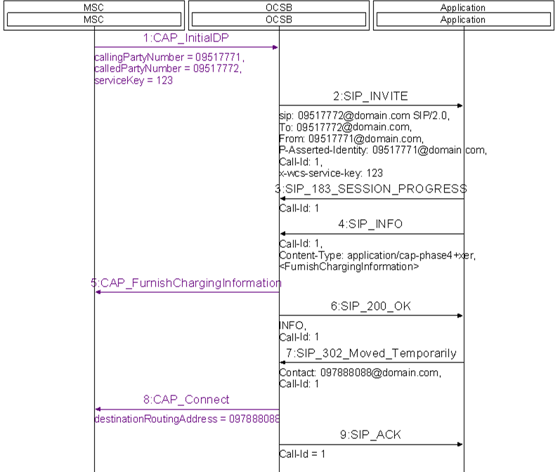

Performing FurnishChargingInformation Operation
To perform a CAP FurnishChargingInformation operation, the application sends a SIP INFO message through the SIP dialog created by Service Broker. The application attaches a XER representation of FurnishChargingInformation operation to the SIP INFO body.
Figure 3-4 shows a SIP initial call control application that performs a CAP FurnishChargingInformation operation.
Figure 3-4 Initial Call Control Application Performs CAP FurnishChargingInformation
Initial Call Control App: CAP FurnishChargingInformation

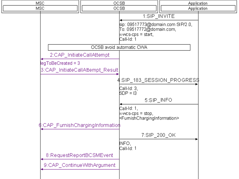

Performing FurnishChargingInformation in an Application Initiated Call
To perform a CAP FurnishChargingInformation operation, the application sends a SIP INFO message through the SIP dialog created by the application. The application attaches a XER representation of the FurnishChargingInformation operation to the SIP INFO body.
When performing CAP FurnishChargingInformation in an application initiated call, the application should perform the following steps:
  1. To set a SIP INVITE sent to Service Broker (for creating a new leg) with an x-wcs-cps header that holds the value of "start".
  2. To receive a SIP 183 SESSION PROGRESS message from Service Broker
  3. To send a SIP INFO message (carrying the CAP FurnishChargingInformation) and set the SIP INFO with an x-wcs-cps header that holds the value of "stop"
The application uses the x-wcs-cps header (with the value of "start") to instruct Service Broker to avoid continuing call processing towards the MSC immediately after the CAP InitiateCallAttempt is sent and instead, to consider the SIP INFO sending CAP FurnishChargingInformation. The CAP ContinueWithArgument is sent by Service Broker only upon receiving an x-wcs-cps header that holds the value of "stop".
Figure 3-7 shows an application that performs a CAP FurnishChargingInformation operation in an application initiated call.
Figure 3-7 Application Performs CAP FurnishChargingInformation in an Application Initiated Call
CAP FurnishChargingInformation in Application Initiated Call

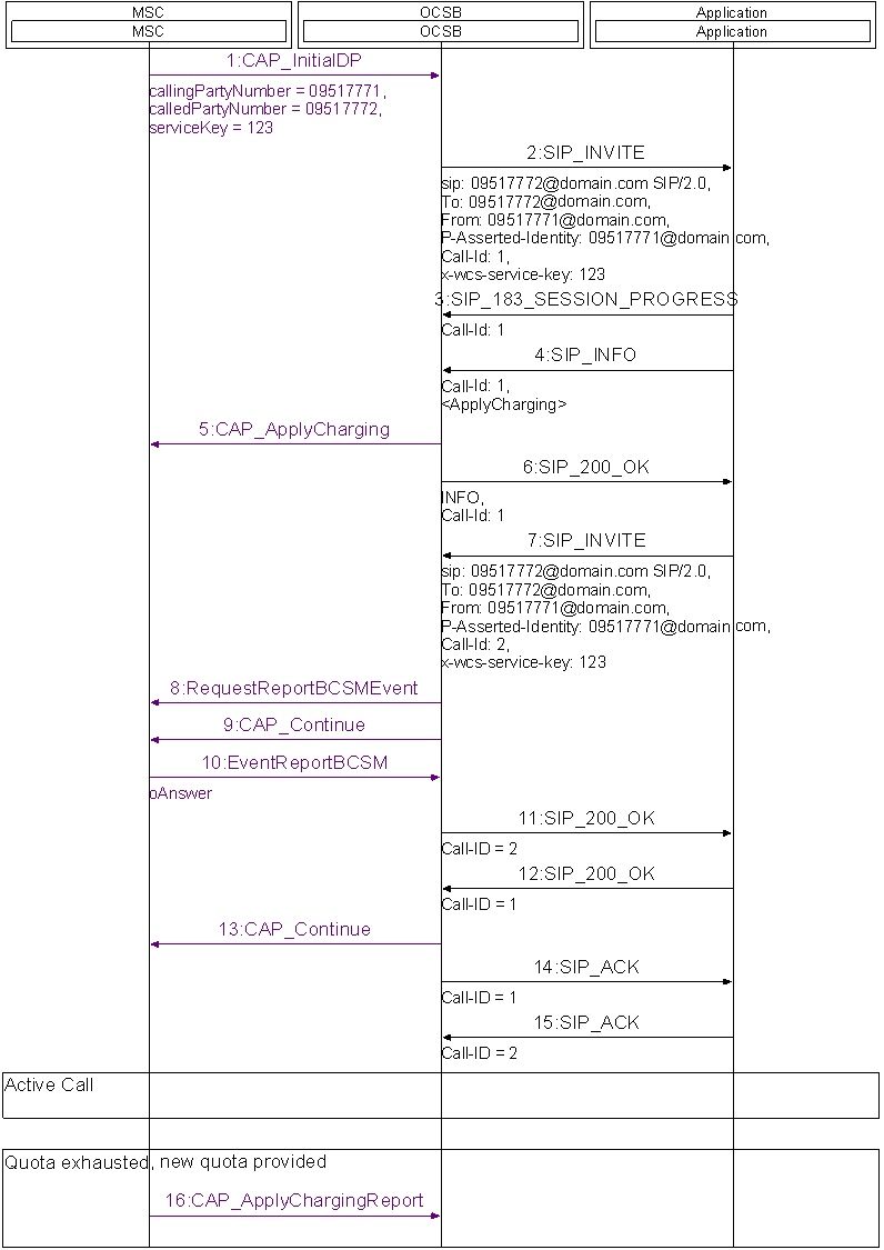

Performing ApplyCharging Operation
To perform a CAP ApplyCharging operation, the application sends a SIP INFO message through the SIP dialog created by Service Broker. The application attaches a XER representation of ApplyCharging operation to the SIP INFO body.
The following example shows a XER representation of the CAP phase 4 ApplyCharging operation.
<Cap4>
 <applyCharging>
   <aChBillingChargingCharacteristics>
   A004800204B0
   </aChBillingChargingCharacteristics>
 </applyCharging>
</Cap4>

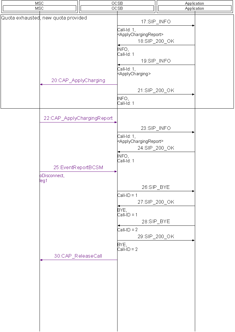

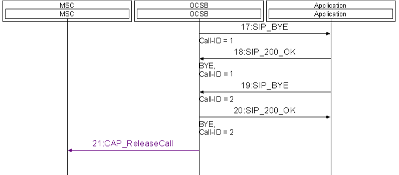

Figure 3-8 and Figure 3-9 show a SIP full call control application that performs a CAP phase 4 ApplyCharging operation.
In the example shown on Figure 3-8, the application reserves quota for the call. When the first quota is exhausted, Service Broker sends a report towards the application which reserve an additional quota.
Figure 3-8 Full Call Control Application Performs CAP ApplyCharging
Full Call Control Application: CAP ApplyCharging
Figure 3-9 Full Call Control Application Performs CAP ApplyCharging (cont'd)
