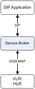

Figure 6-1 shows a SIP application that interacts with an HLR or VLR in a legacy mobile network.
The application-facing side of Service Broker provides a SIP application with a standard SIP interface. The interface is based on the SIP SUBSCRIBE and SIP NOTIFY messages. Implementing the interaction between a SIP application and a network entity does not require any network-specific customization.

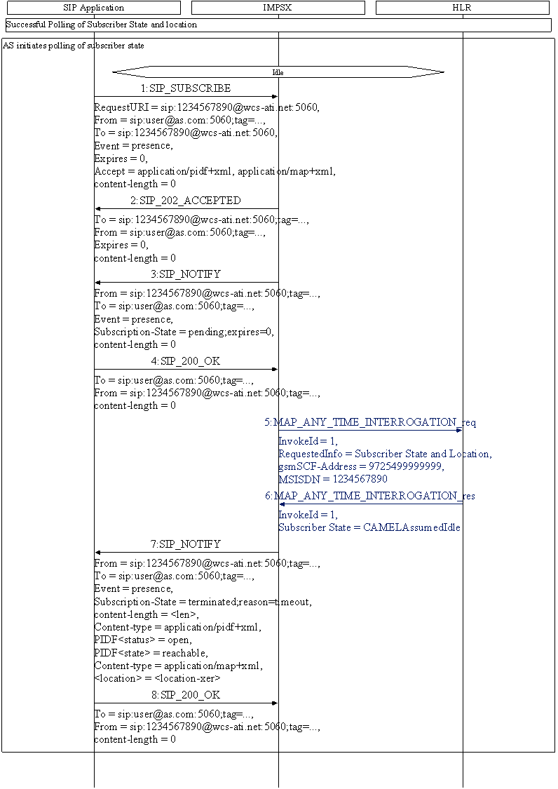

A SIP application interacts with Service Broker through a standard SIP interface using the subscribe and notify mechanism. Figure 6-2 shows a typical call flow in the solution:
The SIP application subscribes to Service Broker for a specific type of operation, such as obtaining the subscriber's status. The application performs the subscription by sending a SIP SUBSCRIBE message to Service Broker.
The SIP SUBSCRIBE message triggers Service Broker to perform an appropriate operation on the SS7 network entity.
After Service Broker received a response from the entity, Service Broker sends the application either a SIP NOTIFY message or a failure response. In both cases, Service Broker terminates the subscription by
Setting the Subscription-State header of the SIP NOTIFY message to "terminated"
Setting the "reason" token of the Subscription-State header of the SIP NOTIFY message to "timeout"
