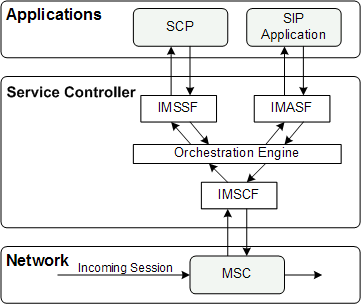

A session arrives to the Orchestration Engine through a network-facing module.
The Orchestration Engine routes the session sequentially through various applications by using application-facing modules. You define the applications that the Orchestration Engine invokes, the order in which the Orchestration Engine invokes the applications, and conditions for invoking applications using a special notation known as the orchestration logic.
After the session passed all applications in the chain, the Orchestration Engine returns the session back to the session control entity in the network.
Figure 1-1 shows an example of how the Orchestration Engine routes a session that arrives from the network through an SCP, then through a SIP application, and then back to the network.
