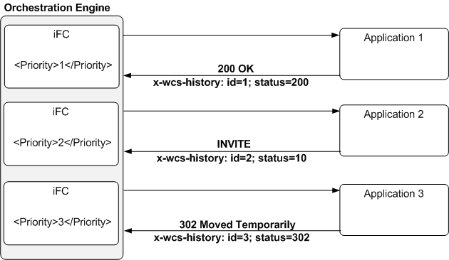

For example, you can specify that the OE triggers an application only if the previous application returns INVITE to the OE. Alternatively, you can define that the OE triggers an application only if the previous application returns the response code 302 Moved Temporarily.
The information about a response or request which the previous application returns is stored in the x-wcs-history header of the message. This header has the following format:
x-wcs-history: id=application_identifier; status=status_code
The parameters are defined as follows:
id
This is an identifier of the previous application in the orchestration chain. The application sets this parameter to the value of the <Priority> element of the iFC that triggered that application.
status
This is the status of the previous application in the orchestration chain.
The application status is an integer. It represents the message that the application returns to the OE. This message can contain one of the following:
Response code, such as 200 or 302. In this case, the application sets the status parameter to the response number.
Request name, such as INVITE or SUBSCRIBE. In this case, the OE maps the name of a request to an integer as you configured using the OeHistoryMBean (see "Mapping Request Names to Status" for more information).
Figure B-4 shows a scenario in which the OE routes the session as follows:
The OE routes the session to Application 1. The <Priority> element of the iFC that triggers this application is 1. Application 1 returns to the OE the response code 200 OK. Application 1 sets the x-wcs-history header as follows:
id=1
status=200
Then the OE routes the session to Application 2. The <Priority> element of the iFC that triggers this application is 2. Application 2 returns to the OE the INVITE request. This request is mapped to 10 using OeHistoryMBean. Application 2 updates the x-wcs-history header as follows:
id=2
status=10
Finally, the OE routes the session to Application 3. The <Priority> element of the iFC that triggers this application is 3. Application 3 returns to the OE the response code 302 Moved Temporarily. Application 3 updates the x-wcs-history header as follows:
id=3
status=302
The status parameter of the x-wcs-history header is the integer that describes the message that an application returns to the OE. If an application returns a request (for example, an INVITE), you need to map this response to an integer using the OeHistoryMBean. For example, you can map an INVITE message to 10.

status=10
<iFCs>

You can set up an application to run based on the previous route of the session. For example, you can set up a bill shock prevention application to run only if the session was previously routed to an online charging application based on the From header.
To enable applications in the orchestration chain to get the information about applications through which the session is routed, you need to tag the session when it passes through an application. For example, if the OE routes the session to an online billing application, you can tag the session with the tag OnlineBillingTriggered. This allows next applications in the orchestration chain to be aware of the online billing application was triggered.
Then you can set up one of the next applications in the chain (such as a bill shock prevention application) to run only if the session contains the OnlineBillingTriggered tag.

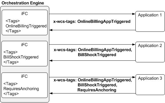

The following sections explain how to tag a session and trigger an application only if the session contains the specified tags.
Service Controller does not support this feature when the Diameter-based orchestration mode is enabled. For more information on the Diameter-based orchestration mode, see the discussion on improving performance in Diameter-only environments in Service Broker Online Mediation Controller Implementation Guide Release 6.1.To tag a session, you use the <Tags> element. This element is an extension to the standard iFC. You need to place the <Tags> element under the <Extension> element.
You can add into <Tags> as many tags as you need. The tags must be separated by comma.

The OE adds the contents of the <Tags> element to the x-wcs-tags header of the message that the OE routes to the next application in the orchestration chain. This header has the following format:
x-wcs-tags: comma_separated_tags_accumulated_from_all_previous_applications
The application returns the message to the OE with the x-wcs-tags header intact. As the message passes through applications in the orchestration chain, the x-wcs-tags header accumulates the contents of all <Tags> elements defined for applications in the chain.
Figure B-5 shows a scenario in which the OE routes a session from Application 1 to Application 2 to Application 3. The session is tagged as follows:
When the OE routes the to Application 1, the tag OnlineBillingTriggered is added.
When the OE routes the session to Application 2, the tag BillShockTriggered is added.
When the OE routes the session to Application 3, the tag RequiresAnchoring is added.
Because the x-wcs-tags header accumulates added tags, after triggering Application 3, the header contains "OnlineBillingTriggered, BillShockTriggered, RequiresAnchoring".
