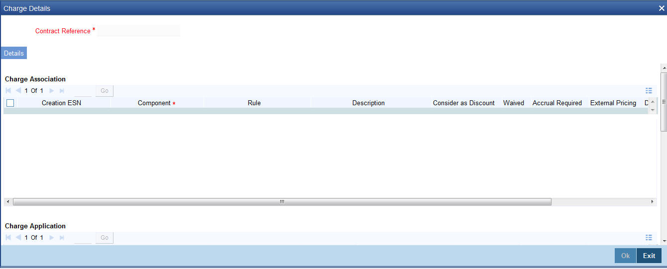

Charges |
Click this link to invoke the Contract Charge Details screen. The Charges and Fees manual details the entire procedure of applying charges to a bill. |

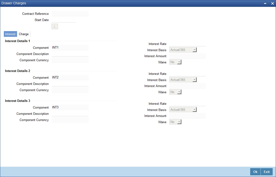

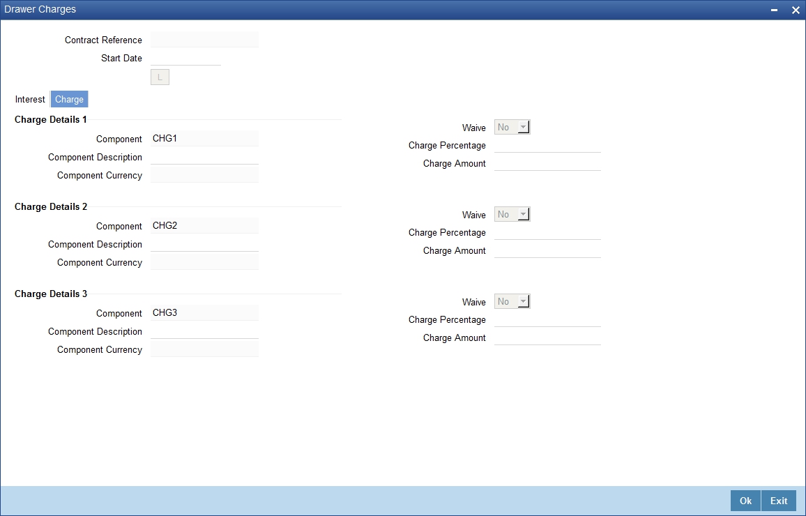

Drawer/Drawee IC |
Click this link to invoke the ‘Drawer/Drawee Interest and Charges’ screen. You can define the charge and interest components at the time of initiation of contract. |

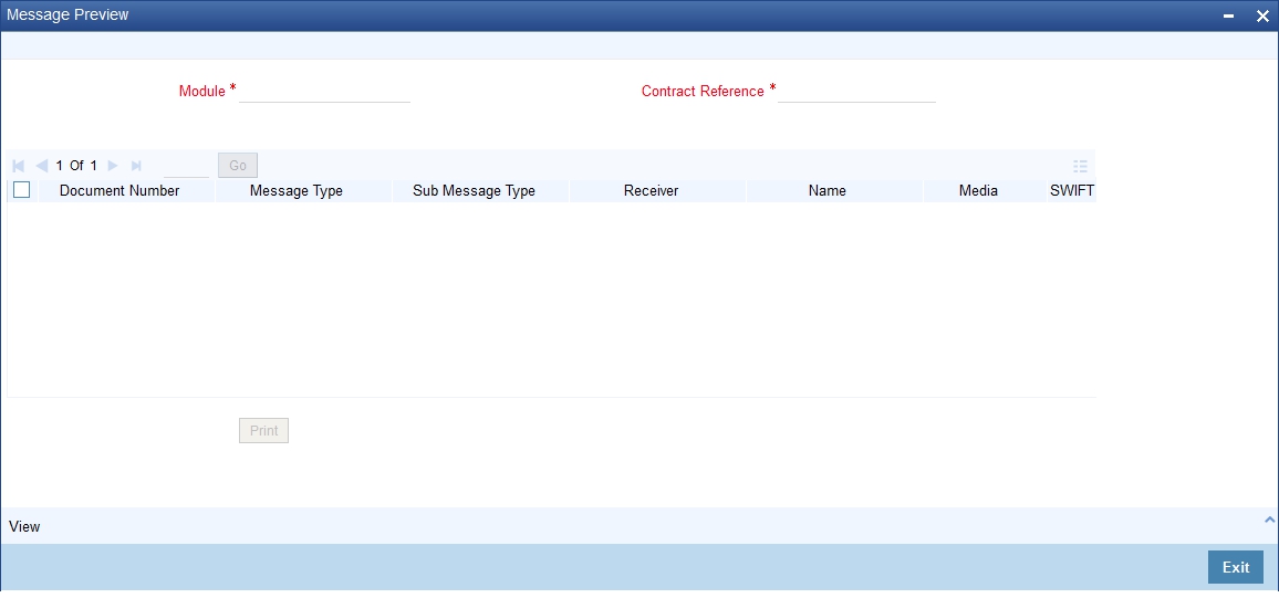

Message Preview |
Click this link to view the messages or advices generated for the contract. |

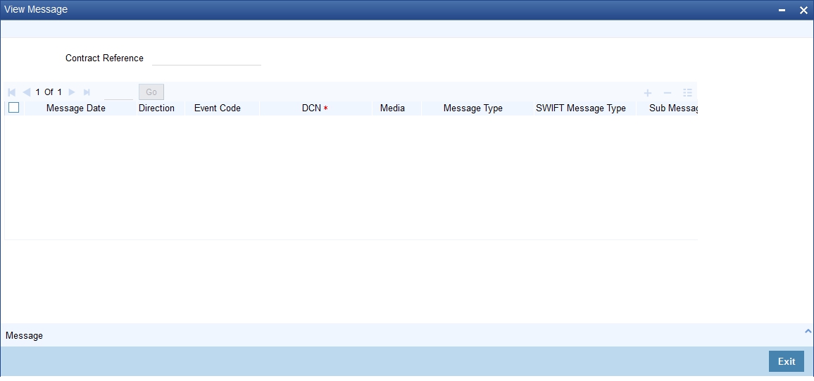

All Messages |
Click this link to view all messages associated to contract. |

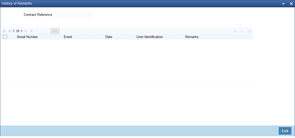

Remarks |
Click this button to view the ‘History of Remarks’ screen |

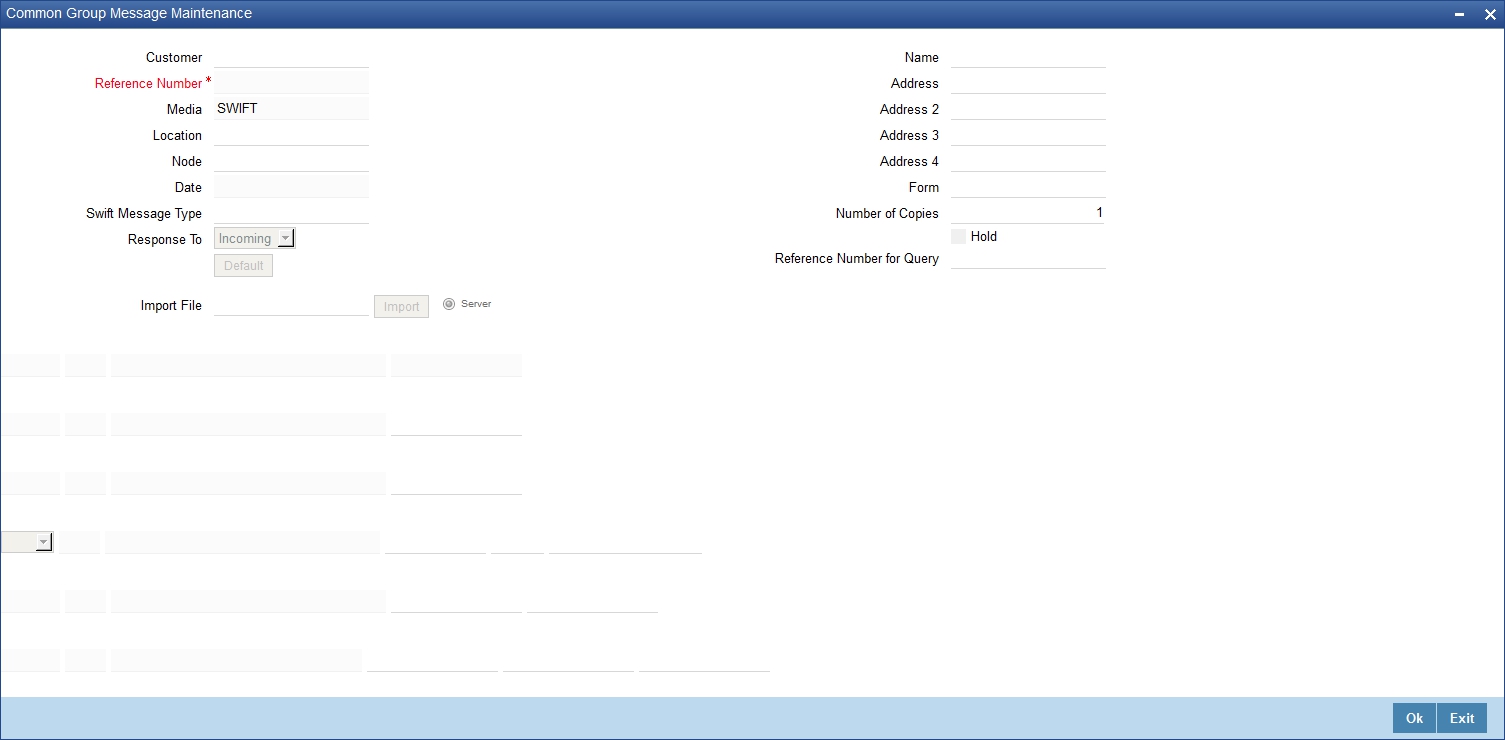

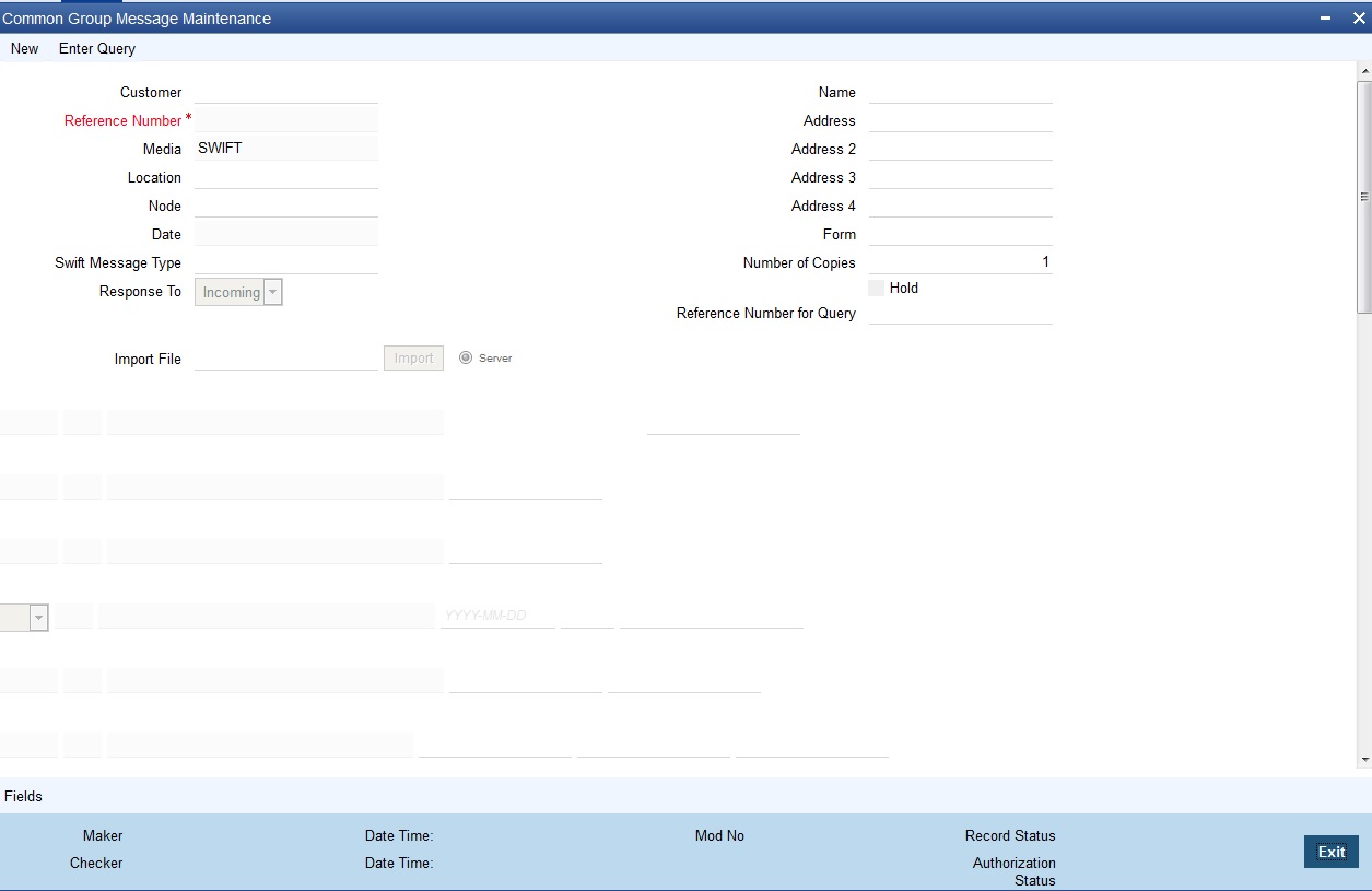

Common Group Message |
Click this button to open the common group message call form |

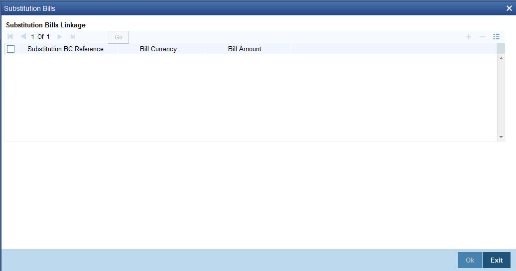

Substitution Bills |
Click this button to open the Substitution Bills sub screen. |

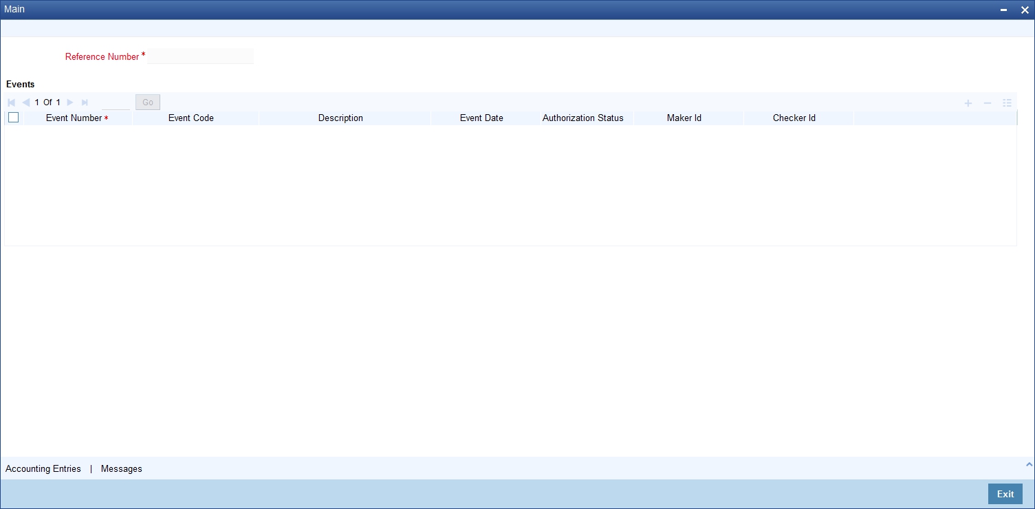

Click ‘Events’ button in the ‘Bills and Collections - Contract Input - Detailed’ screen and invoke the ‘Event Details’ screen. The details of events, that have already taken place on the contract, will be displayed along with pending events. The date on which the event took place will also be displayed.

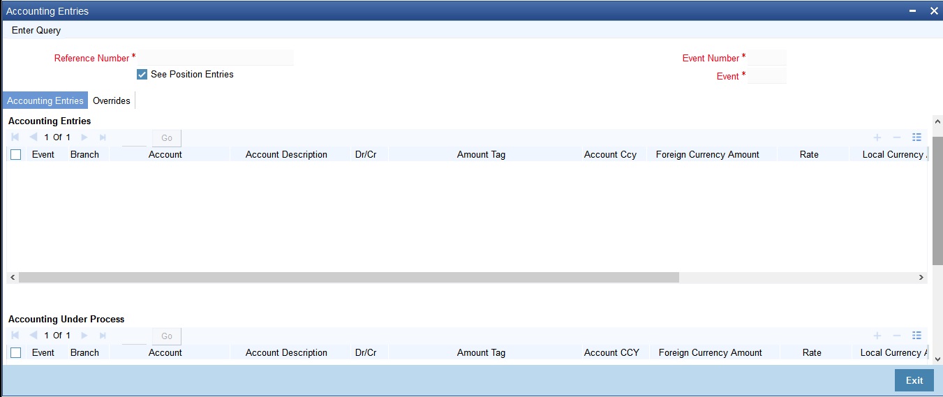

Click ‘Accounting Entries’ button to view the accounting entries for the event. Click ‘Message’ button to view the messages applicable to the event. Click ‘Exit’ or ‘Cancel’ button to return to the Bills Contract Detailed screen.
From the ‘Event Details’ screen, click ‘Accounting Entries’ button and view the ‘View Details’ for the event. The details of the accounting entries that were passed for the event can be viewed here. The accounting entries that are passed depend on the type of bill you are processing.
The following information is provided for each event:

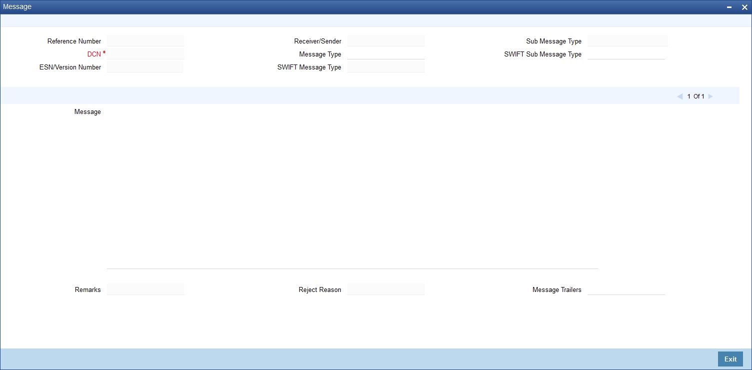

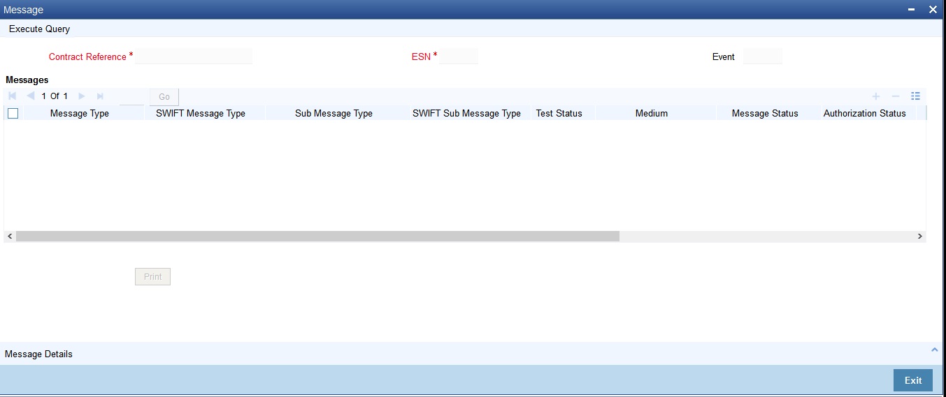

Click ‘Message’ button from the ‘View Events’ screen and view the list of advices applicable to a particular event in the lifecycle of the bill.
The following details of a message are displayed:
To view the text of a message, highlight the message and click ‘Message’ button. Click ‘Exit’ or ‘Cancel’ button to exit the screen.

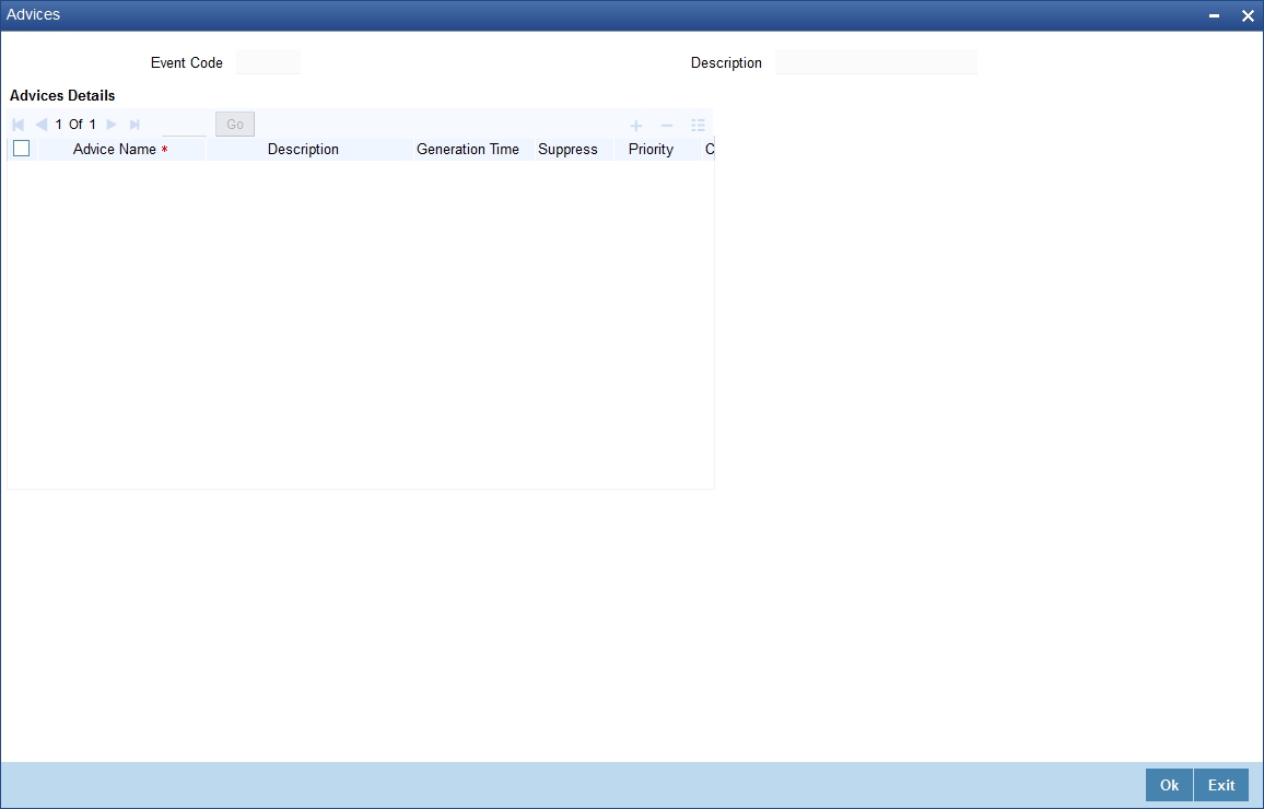

The advices that have to be generated for an event during the lifecycle of a bill are specified for the Product involved in the bill. While processing a bill, you can:
From the ‘Bills and Collections - Contract Input - Detailed’ screen, click ‘Advices / FFT’ button. The ‘Advices / Free Format Text’ screen is displayed.
The advices inherited from the product involved in the bill you are processing will be displayed in the Advice Code field.
Suppress
By default, all the advices that have been defined for a product will be generated for the bills involving it. As certain advices may not be applicable to the bill you are processing, you can suppress its generation by indicating the same in this screen.
Priority
For messages sent through media like SWIFT or TELEX, you can specify the priority with which the advice should be generated. By default, the priority of all advices is marked as Normal. You have the option to prioritize advices to one of the following options:
However, you can change the priority of an advice to Urgent only for Payment Advices.

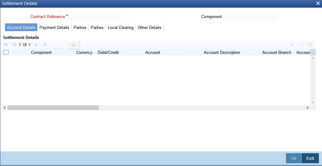

You can capture the settlement details of a bill in ‘Settlement Details’ screen. Click ‘Settlement’ button in ‘Bills and Collections - Contract Detailed’ screen to invoke the ‘Settlement Details’ screen.
The bill gets settled based on the details specified in the settlement screen.
For more details on this screen, refer the section titled ‘Processing Settlements’ in Settlements user manual.

Click on ‘Charges’ link of the ‘Bills and Collections Contract Detailed’ screen to view the charge details.
The system displays the charges configured for the event at product definition here.
For more details on the Charges Details screen, refer section ‘Contract Charge Details’ in Charges and Fees User Guide under Modularity.

When a new loan contract is created the following accounting entries are passed:
Event Code |
Dr/Cr Indicator |
Accounting Role |
Amount Tag |
DSBR |
DR |
LOAN ASSET GL |
PRINCIPAL |
DSBR |
CR |
BRIDGE GL |
PRINCIPAL |
If a bill contract is booked with ‘Advance by Loan’ option is not checked at the contract level, then the following accounting entries are passed:
Event Code |
Dr/Cr Indicator |
Accounting Role |
Amount Tag |
LIQD |
DR |
BC CUSTOMER |
BILL_AMOUNT (or) BILL_AMT_EQUIV |
LIQD |
CR |
NOSTRO |
If a bill contract is booked with ‘Advance by Loan’ option is checked at the contract level, then the following accounting entries are passed:
Event Code |
Dr/Cr Indicator |
Accounting Role |
Amount Tag |
LIQD |
DR |
BRIDGE GL |
BILL_LIQ_AMT (or) BILL_LIQ_AMTEQ |
LIQD |
CR |
NOSTRO |

Click ‘Charges Transfer’ button to invoke the ‘Charges Transfer’ screen. This screen displays charge components transferred from LC and component wise outstanding charges for the LC against which the Bill is being availed.
Following details are displayed:
The total amount transferred onto the Bill for a component is internally allocated amongst the various events of the LC during which the component was charged. System transfers the charge from LC completely and the same gets marked as liquidated.
You have to input the charges transferred as a part of the bill being input and it is mandatory to input the amounts in the current transfer field of this screen if the bill is under an LC and there are charges defined for the LC to be collected as a part of the bill.
Any event which is triggered in LC (where the charges are applicable and charge components is marked as Collect LC Charges in Bills) before the bill booking will be allowed for transfer.
In case of a bill lodged under an LC where partial shipment is allowed and an event occurred in LC for which Collect LC Charges in bills is selected, then during subsequent bill booking these charge components will be available for transfer.
This screen does not display any waived components.

Click ‘Drawer/Drawee IC’ button to invoke the ‘Drawer/Drawee Interest and Charges’ screen. In this screen, you can define the charge and interest components at the time of initiation of contract.
Specify the following details in this screen:
Contract Reference Number
Contract Reference Number is displayed.
Start Date
Specify the Start date for interest details. Start date cannot be less than bill booking date.
Specify the following details pertaining to interest:
Specify the following details:
Component
Specify the interest component.
Component Description
Specify the description of the interest component.
Component Currency
Specify the currency of the interest component.
Component
Component Currency
Component
Component Currency
Interest Rate
Specify interest rate. Interest rate cannot be greater than 100.
Interest Basis
Select the interest basis from the drop-down list. You have the following options:
Interest Amount
The interest amount is the interest to be levied on drawer.
Waive
Select the waiver from the drop-down list. You have the following options:
System considers the period between the start date and the date of liquidation for calculating interest amount.
During liquidation, system calculates and displays the amount for each of the defined component.
In the ‘Drawer/Drawee Interest and Charges’ screen click ‘Charge’ tab to maintain the charge details.
Specify the following details pertaining to the charges:
Component
Specify the charge component.
Specify the description of the charge component.
Component Currency
Specify the currency of the charge component.
Component
Component Currency
Component
Component Currency
Waive
Charge Percentage
Specify charge percentage. It cannot be greater than 100.
System calculates the final charge based on this value.
Charge Amount
The charge amount is the charge to be levied on drawer.

You can preview the messages or advices that will be generated for the contract using ‘Message Preview’ screen. To invoke this screen, click ‘Message Preview’ button.
For the contract, you can view the following details of the messages:
If the contract is authorized. you cannot use the message preview feature. The ‘Message Preview’ button will be disabled in that case.
Message preview functionality is available on save for all the BC transactions. Along with the preview option, you will be allowed to print the required message/advice from the preview screen.
Select a message/ advice and click ‘View’ button to view the complete message/advice. The system will display the following details in a new window.
You can view the following details:
From the ‘Message Preview’ screen, you can print or spool a message/advice using ‘Report Options’ screen. Select the message/advice and click ‘Print’ button to print the message/advice.
Click ‘All Messages’ button to invoke the ‘View Message’ screen. This screen displays all the incoming and outgoing messages associated to the contract.
The following details are displayed:
Contract reference number
Displays Reference number of the contract, for which messages are generated.
Message Date
Displays the message generation date or received date
Direction
Displays whether the message is an incoming or outgoing message
DCN
Displays document reference number of a contract.
Media
Displays whether the message is a swift message or mail message
Message Type
Displays the type of message
Swift Message Type
Displays the Swift MT number of the message sent or received
Receiver/Sender
Displays Receiver or Sender ID.
Name
Displays the name of the Sender or Receiver
Message Status
Displays current status of message
Test Status
Displays the test status
Authorized
System displays whether the status is authorized or unauthorized.
Acknowledgement Status
Displays the Ack/Nack status of a message
PDE Flag
Displays the PDE flag
Select a message and click on Message button to view details of the message.

Click Remarks button to view all the instructions captured on every transaction of the contract in ‘History of Remarks’ screen.
The system displays the following:
The system displays the contract reference number
Serial Number
The system displays the serial number.
Event
The system displays the event code of the event.
Date
The system displays the date on which the instructions were captured
User Identification
The system displays the user id of the user who created the notes
Remarks
The system displays the instructions that the user captures
You can enter details of common group messages using the Common Group Message screen. Click on ‘Common Group Message’ to open this screen. .
For field descriptions of the above screen refer the section ‘Common Group Message Maintenance’ in chapter titled ‘Defining Free Format Messages’ in ‘Messaging System User Guide’.
You can enter the details of the message and the message is saved when the contract is saved.. The saved messages can be viewed in the message preview subsystem before authorization. On authorization of the contract, the message is generated. After authorization, the messages can be viewed from ‘All Messages’ subsystem and ‘Events’ subsystem.
The common group messages which are supported are listed below:
MT |
MT Name |
n90 |
Advice of Charges, Interest and OtherAdjustments |
n91 |
Request for Payment of Charges, Interest and Other Expenses |
n92 |
Request for Cancellation |
n95 |
Queries |
n96 |
Answers |
n98 |
Proprietary Message |
n99 |
Free Format |
You can enter details of ancillary structured message using the Common Group Message Maintenance screen. Click on ‘Common Group Message’ to open this screen.
MT759 – Ancillary Trade Structured Message has been added to the existing list of SWIFT Message Types.
You can enter details of ancillary trade structured message using the Common Group Maintenance BCDTRONL subsystem screen. Click on ‘Common Group Message’ to open this screen.
You can enter details of ancillary trade structured message using the Common Group Maintenance LCDTRONL subsystem screen. Click on ‘Common Group Message’ to open this screen.
Provision to generate MT759 common group messages in LCDTRONL and BCDTRONL is enabled by enhancing Common Group Messages screen (MSCCOMPM)
LCDTRONL – Click on Common Group Message subsystem. Type LOV and few fields
are added to 759 in Swift Message
BCDTRONL – Click on Common Group Message subsystem. Type LOV and few fields are added to 759 in Swift Message
You can capture the import bill reference details in the Substitution Bills sub screen. You can invoke this screen by clicking ‘Substitution Bills’ button in the BC Contract screen.
You can specify the following here:
Substitution BC Reference
Specify the substitution bill reference number. Alternatively, you can select the reference from the option list. The list displays all the bills which are created under the product category 'Bill under transferred LC' and are linked to LC contract which are created on transfer of the parent LC contract to which the export bill is linked.
You cannot link an import bill which is already linked to another export bill.
Bill Currency
The system displays the bill currency.
Bill Amount
The system displays the bill amount.

Click Remarks button to view all the intructions captured on every transaction of the contract in ‘History of Remarks’ screen.
For more details on this screen refer Section 6.1.22, "Remarks" in this user manual.
