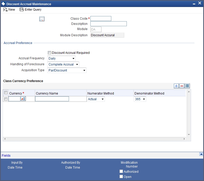

Before defining the attributes of a discount accrual fee class, you should specify the following:
Class Code
Specify a unique identifier for the class.
Description
Enter a brief description for the class. A description would help you easily identify the class.
Module
Specify the module to which the class is associated.
Module Description
A brief description of the module is displayed here.
When building a discount accrual fee class, you define the following attributes:
Discount Accrual Required
Specify whether Discount accrual should be performed for the class.
Accrual Frequency
Specify the frequency at which discount accrual should be performed. This can be either Daily or Monthly. For monthly accruals, the discount accrual will be done on the last day of the month.
Acquisition Type
The Acquisition Type determines whether the initial cash flows for a C contract can be more (Premium) or less (Discount) or equal (Par) to the bill amount.
The ‘Acquisition Type’ is determined by the cash flows of interest, charges and fees for which 'Consider as Discount' option is checked.
The drop down list comprises of the following values:
If the incoming cash flows of all the above components are greater than outgoing cash flows considering Incoming flow as Positive (In case of bills), the acquisition type is considered as Discount.
If the incoming cash flows of all the above components are less than outgoing cash flows considering Incoming flow as Positive (In case of bills), the acquisition type is considered as Premium.
If the incoming cash flows of all the above components are equal to outgoing cash flows considering Incoming flow as Positive (In case of bills), the acquisition type is considered as Par.
Note
The acquisition type of a contract can change from premium to par/discount or otherwise depending on the charges getting liquidated during the life cycle of the contract.
Handling of Foreclosure
Specify how foreclosures with respect to the contracts using the class must be handled. You can opt for the completion of pending accruals, or refund. In case the ‘Acquisition Type’ is ‘Par’, there are no refunds. Only the pending accruals are completed.
You can specify the day count methods for each currency using the class. You can define the day count methods for both the Numerator and the Denominator.

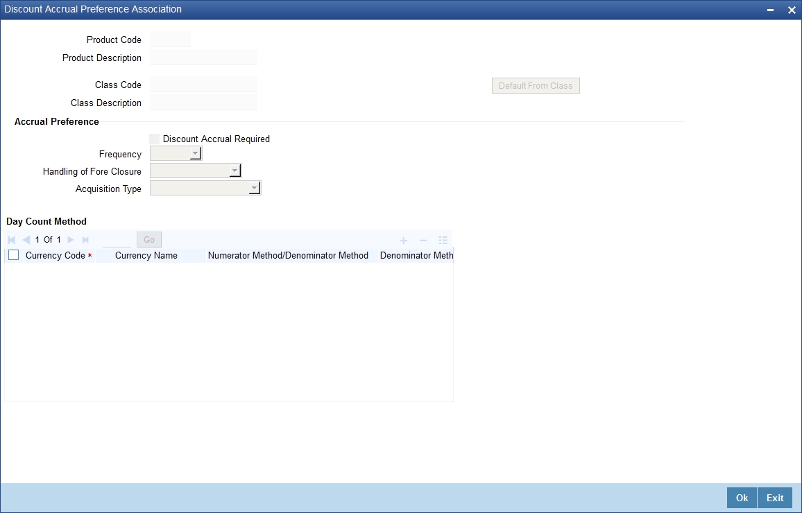

After building discount accrual fee classes you can associate the class with loans or bills products. Click ‘Discount Accrual’ button in the Product Definition screen. The ‘Discount Accrual Preference Association’ screen is invoked.
To associate discount accrual fee class with a product, click ‘Default From Class’ button in the Discount Accrual Preference Association screen. Select the appropriate discount accrual fee class from the list of classes.
The attributes defined for the discount accrual fee class defaults to the product. You have the option to modify the attributes defined for the class, to suit the requirement of the product you are creating. Alternatively, you can choose to define the discount accrual details for the product.
