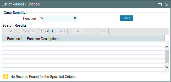

Function Identification
Choose the function ID of batch that you wish to run. The adjoining option list displays all batch processes available for the module.
You can configure the batch to be run at various stages of day like EOD, EOTI etc.
