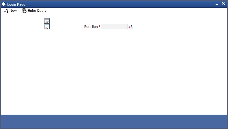

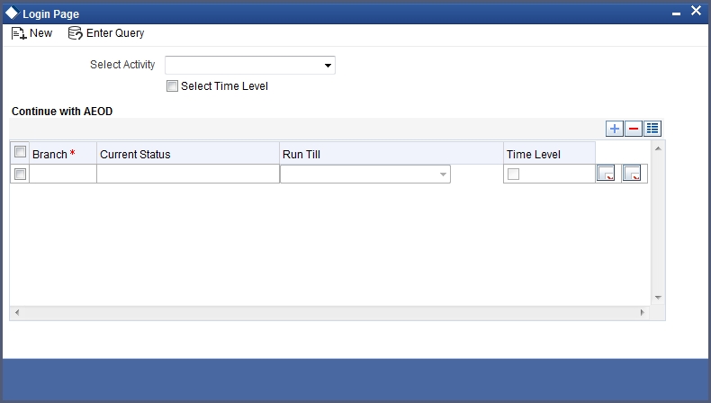

To run the Batch process, use the ‘End of Day Batch Start’ screen. You can invoke this screen by typing ‘AEDEODST’ in the field at the top right corner of the Application tool bar and clicking on the adjoining arrow button.
Thereafter, click ‘Ok’ button, to start the batch process at the EOD.
To exit the screen without running the batch click ‘Exit’ or ‘Cancel’ button.
Note
You cannot cancel an EOD Batch process once it has begun.

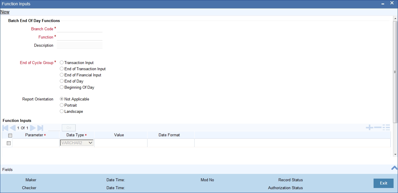

To run the Instrument Batch Handoff process automatically at EOD, you must maintain two mandatory programs – for instrument detail and instrument price detail - under the batch operations. You can do this using the ‘Mandatory Batch Program Maintenance’ screen.
Prior to maintaining the mandatory programs, you must first maintain the function inputs for Batch EOD Functions. You can do this using the ‘Batch EOD Function Inputs’ screen. You can invoke this screen by typing ‘BADEODFE’ in the field at the top right corner of the Application tool bar and clicking on the adjoining arrow button.
Here you can maintain the function inputs for Batch EOD Functions by specifying the following details:
After specifying the above details, you can add the functions input for the function in the ‘Function Inputs’ table. You must mandatorily specify the Parameter and Data Type for each function. Now you can proceed with maintaining the Instrument Batch Handoff process as a mandatory program.
You can maintain the Instrument Batch Handoff process as a mandatory program using the ‘Mandatory Batch Program Maintenance’ screen. You can invoke this screen by typing ‘EIDMANPE’ in the field at the top right corner of the Application tool bar and clicking on the adjoining arrow button.
Here you can maintain the details of the batch program by specifying the following:
