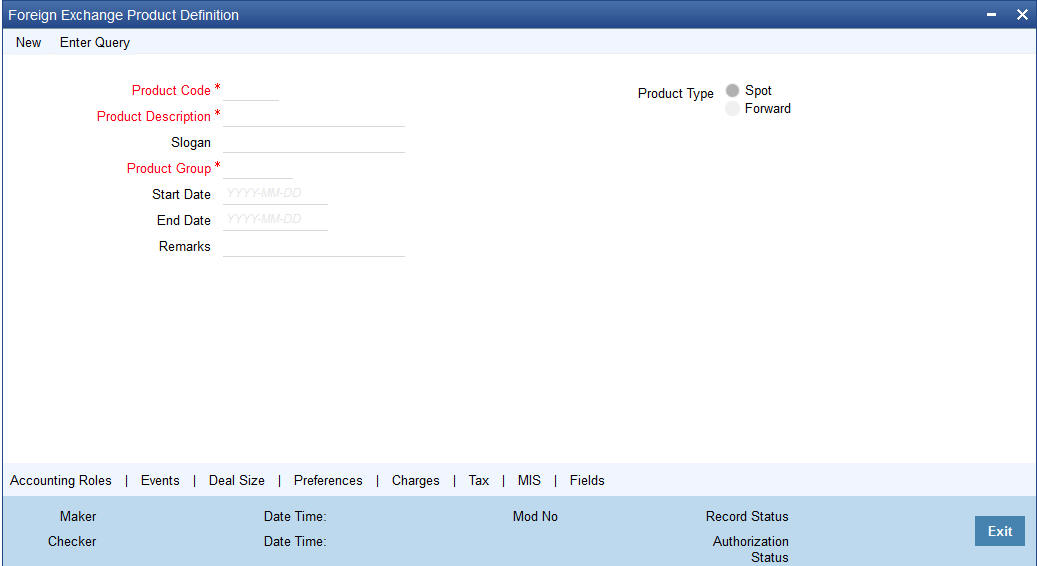

You can create FX products using the ‘Foreign Exchange Product Definition’ screen. You can invoke the ‘Foreign Exchange Product Definition’ screen by typing ‘FXDPRMNT’ in the field at the top right corner of the Application tool bar and clicking on the adjoining arrow button.
In this screen, you can enter basic information relating to a deposits product such as the Product Code, the Description, etc.
For any product you create in Oracle FLEXCUBE, you can define generic attributes, such as branch, currency, and customer restrictions, interest details, tax details, etc., by clicking on the appropriate icon in the horizontal array of icons in this screen. For a foreign exchange product, in addition to these generic attributes, you can specifically define other attributes. These attributes are discussed in detail in this chapter.
You can define the attributes specific to a deposits product in the ‘Foreign Exchange Product Definition Main’ screen and the ‘Foreign Exchange Product Preferences’ screen. In these screens, you can specify the product type and set the product preferences respectively.
For further information on the generic attributes that you can define for a product, please refer the following Oracle FLEXCUBE User Manuals under Modularity:

Code
Specify the code of the FX product.
Description
Enter a small description for the product.
Type
The first attribute that you define for a product is its type. You can broadly classify products into two types in the Foreign Exchange module of Oracle FLEXCUBE - Spot and Forward.
For example, you want to create a product for GBP/USD spot (buy) deals called BuyGBP. When you define the product you would indicate that the product type of this product is Spot.
Under each product type you can create any number of products.
Slogan
Enter a slogan for the product.
Group
Select the group to which the product belongs.
Start Date
Select the date from which the product is effective.
End Date
Select the date till which the product can be used.
Remarks
Enter any additional remarks about the product.

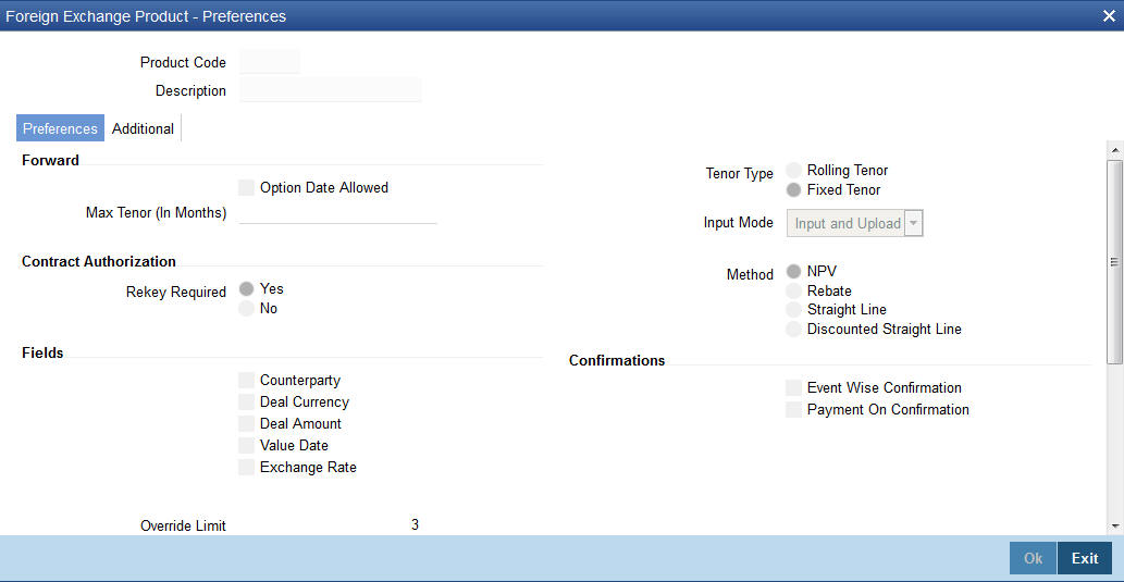

Preferences are the attributes or terms defined for a product that can be changed for a deal involving the product. By default, an FX deal acquires the attributes defined for the product to which it belongs.
However, the attributes that are defined as the product’s “preferences” can be changed for a deal. To invoke the ‘Preferences’ screen click ‘Preferences’ button.
You can define the preferences for a product in the ‘FX Product Preferences’ screen. The following are the preferences that you can define for a product.

Option Date Allowed
For a product, you can indicate whether an Option Date can be specified for forward deals during deal processing. If you specify an option date, then you can change the contract value date to any date between the option date and the original value date, This means that the contract may be liquidated anytime between the option date and the value date of the contract.
To allow an option date, check this box.
However, if you have allowed an option date for a product, you need not necessarily enter an option date during deal processing.
Max Tenor (In Months)
When you create a product, you can specify the maximum tenor for forward deals involving the product. You cannot enter a deal with a tenor that exceeds that specified for the related product. However, you can enter an FX deal with a tenor that is less than that specified for the product.
To specify the maximum allowed tenor for a product, enter an absolute value (in months) in the ‘Max Tenor’ field.
All contracts entered in the system should be ratified or ‘authorized’ by a user with the requisite rights. This is a security feature.
When creating a product, you can indicate if the authorizer of contracts involving the product needs to rekey important contract details. This is to ensure that the contract is not mechanically authorized. If you opt for rekey of details click on the button against ‘Yes’ under Rekey required field.
Rekey Required
Select ‘Yes’ if you want to rekey the details, else select ‘No’.

Under Rekey Fields you can indicate which of the details that you would like the authorizer to rekey. Click on the box adjacent to each contract detail to indicate that it should be rekeyed.
Specify the mode through which product can be used to book contracts. The options available are:
Tenor Type
Select the tenor for calculation of risk weighted amount. It can be either ‘Fixed’ or ‘Rolling’.

Event wise Confirmation
Check this box to move the confirmation status of FX deal to ‘Unconfirmed’ during amendment/cancellation/reverse/rollover, if outgoing confirmation message is configured for the event.
Payment on Confirmation
If this field is checked, the External Payment System will send the payment messages.

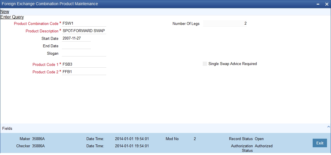

A swap deal is usually a combination of two foreign exchange contracts. These contracts could be Spot - Forward or Forward - Forward contracts. It involves a simultaneous buying and selling of currencies, wherein, the currencies traded in the first deal are reversed in the next.
A swap deal would be defined in Oracle FLEXCUBE as a Product Combination - that is, involving two different products (a particular spot or forward product and another spot or forward product).

You can define products that are a combination of two other products through the ‘Foreign Exchange Combination Product Maintenance’ screen.
You can invoke the ‘Foreign Exchange Combination Product Maintenance’ screen by typing ‘FXDPRDCO’ in the field at the top right corner of the Application tool bar and clicking on the adjoining arrow button.
You can enter the following details relating to FX Product Combination Definition
Product Combination Code
In this field, you should specify the code by which the product combination is identified in the system. If you are defining a new product combination, enter a new code in this field. You can define a product that is a combination of two different products.
Description
Enter a description for the product.
Start Date
You can create a product such that it can only be used over a particular period. The starting date for this period should be specified in this field. The system defaults to today’s date. Enter a date that is the same as, or later than, today’s date.
End Date
You can create a product that it can only be used over a particular period. The End Date of this period is specified in this field.
Number of Legs
This field identifies the number of contract legs that can be defined under this product combination. The system defaults to a value of two legs. This cannot be changed.
Slogan
This is the marketing punch line for the product. The slogan that you enter here will be printed on the mail advices that are sent to the counter parties who are involved in deals involving the product.
Product Code 1
If the product is a combination of two other products, each leg of the deal corresponds to one product in the combination. Specify which product corresponds to which leg in the ‘Product Combination’ screen. For deals involving such a product, select the product for the first leg of the deal.
Product Code 2
Select the product for the second leg of the deal.
Single Swap Advice Required
Even if you have specified swap advices for both products in a combination, you can generate a single swap advice by choosing this option.

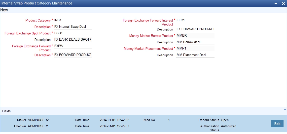

You can maintain product category details for internal swap transactions through the ‘Internal SWAP Product Category Maintenance’ screen. An internal swap transaction is a combination of FX and MM transactions generated for a deal between the FX desk and the MM desk. Such deals are usually done to take advantage of prevailing market conditions.
You can invoke the ‘Internal SWAP Product Category Maintenance’ screen by typing ‘FXDISPCM’ in the field at the top right corner of the Application tool bar and clicking on the adjoining arrow button.
Specify the following details.
Product Category
You need to specify the Product Category for internal swap transactions.
Product Category Description
Enter a small description for the Product Category.
Foreign Exchange Spot Product
You need to specify the FX Spot Product for internal swap transactions.
Foreign Exchange Spot Product Description
Enter a small description for the Foreign Exchange Spot Product.
Foreign Exchange Forward Product
You need to specify the FX Forward Product for internal swap transactions.
Foreign Exchange Forward Product Description
Enter a small description for the Foreign Exchange Forward Product.
Foreign Exchange Forward Interest Product
You need to specify the FX Forward Interest Product for internal swap transactions.
Foreign Exchange Forward Interest Product Description
Enter a small description for the Foreign Exchange Forward Interest Product.
Money Market Borrow Product
You need to specify the MM product for Borrowing for internal swap transactions.
Money Market Borrow Product Description
Enter a small description for the Money Market Borrow Product.
Money Market Placement Product
You need to specify the MM Placement product for internal swap transactions.
Money Market Placement Product Description
Enter a small description for the Money Market Placement Product.
