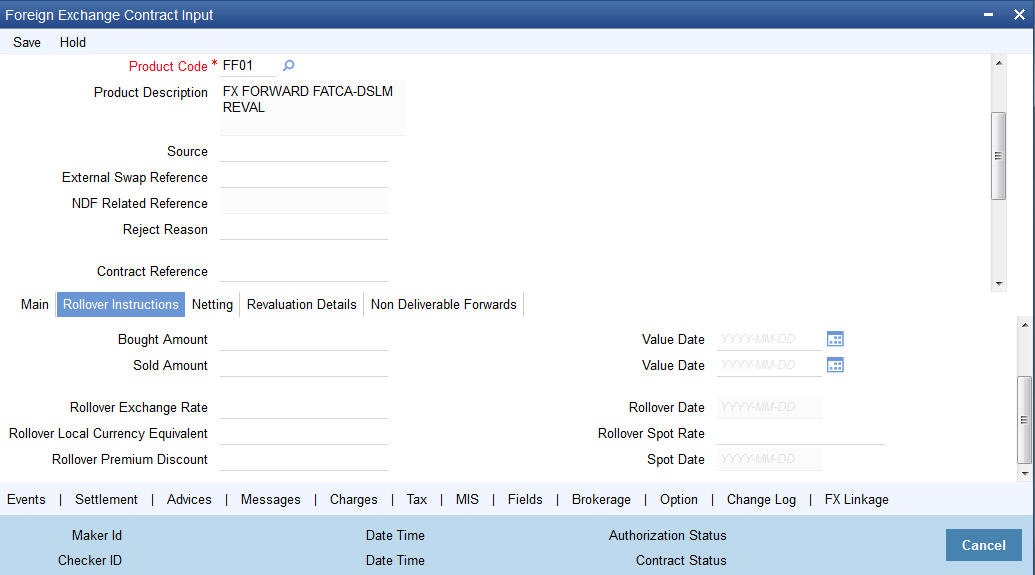

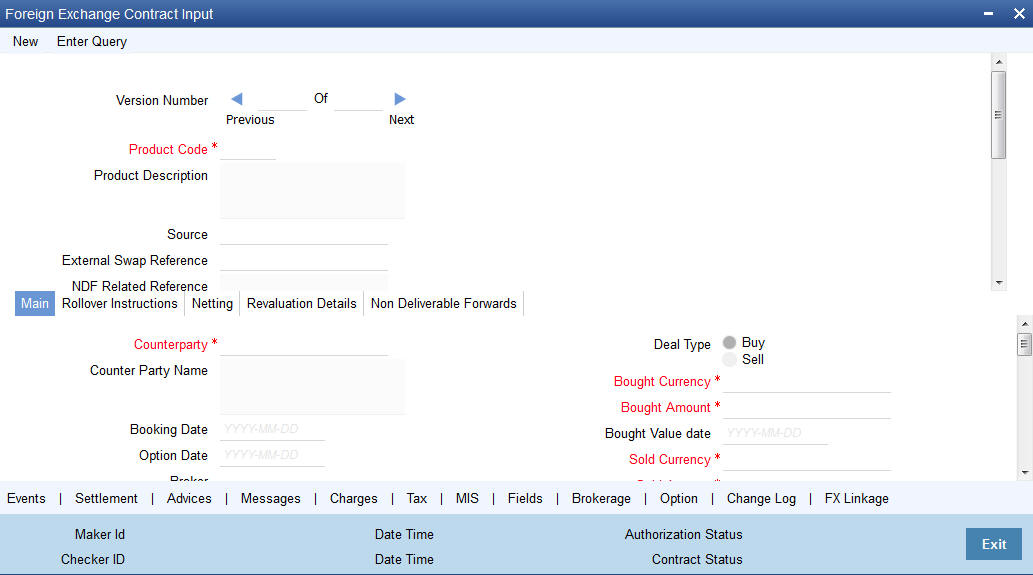

To enter a foreign exchange contract you must invoke the ‘FX Contract Input’ screen. You can invoke the contract input screen from the Application Browser. You can also go to the ‘FX Contract Input’ screen from the following screens:
You can invoke the ‘Foreign Exchange Contract Input’ screen by typing ‘FXDTRONL’ in the field at the top right corner of the Application tool bar and clicking on the adjoining arrow button.
Now, to input a contract in the screen, select ‘New’ icon in the Application tool bar or click new icon.
You can enter the details of a contract in two ways. You can:
Based on the type of contract that you are entering, you have to select a product or a product combination that you have maintained in the branch.
To select a product, click on option list icon in the Product Code field. A list of the products that you have maintained in the branch will be displayed. Click on the product which you would like to offer the counterparty.
When you select a product the transaction acquires the attributes that you defined for the product. On entering the Product code and tabbing-out, the product details get populated.

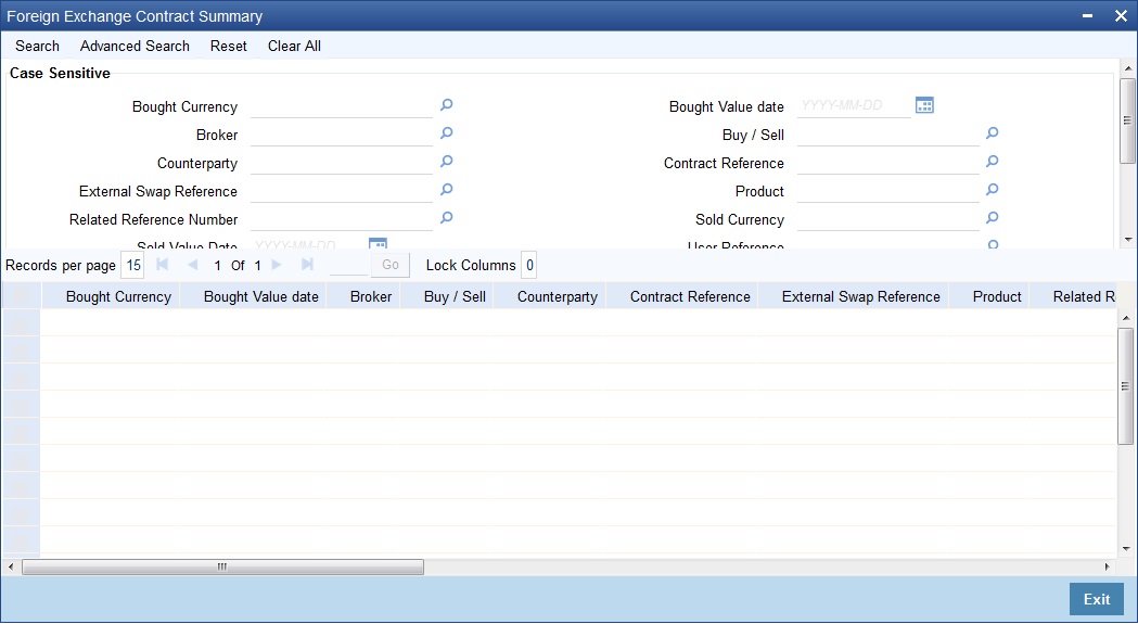

The External SWAP ref no. can be viewed in the ‘Foreign Exchange Contract Summary’ screen.

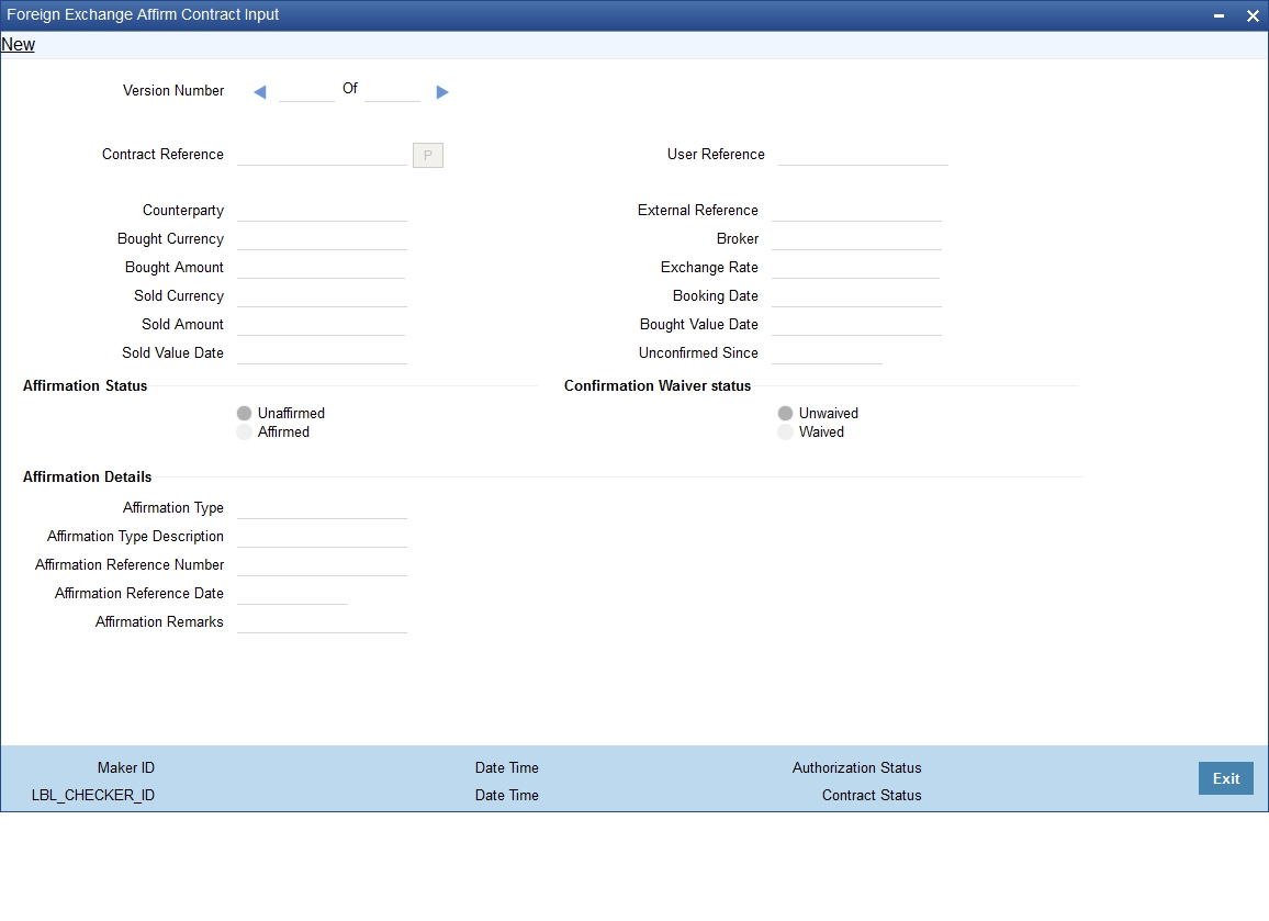

Confirmation Status
The system displays the confirmation status.
Confirmation status will be ‘Unconfirmed’ for a contract at the time of booking or after any amendment. The status will be moved to ‘Confirmed’ when the confirmation is done for the contract by auto/manual matching or manually. A deal which is already confirmed by message matching can be marked as unconfirmed manually from the Manual Matching screen and the confirmation status will be changed to Unconfirmed.
If affirmation is done for an FX contract with an Affirmation Type for which the field for ‘Consider for contract confirmation’ is checked, then also the contract status will be moved to ‘Confirmed’. If after such an affirmation, unaffirm action is done for the contract, then confirmation status will change back to unconfirmed.
Entering the Confirmation waiver will change the confirmation status of the deal as ‘Waived’. If the confirmation is un-waived for such a deal, then confirmation status will be moved back as ‘Unconfirmed’. Confirmation can be unwaived for a deal with confirmation status as ‘Waived ‘only. The system will validate the same.
If the confirmation received or affirmation received with affirmation type is checked for ‘Consider for Contract Confirmation’, then Confirmation Status is ‘Confirmed’ for the deal.’
If confirmation status of a deal is ‘unconfirmed’ and confirmation waiver is not marked for a deal then related payment messages will be generated in ‘Confirmation Pending’ status.

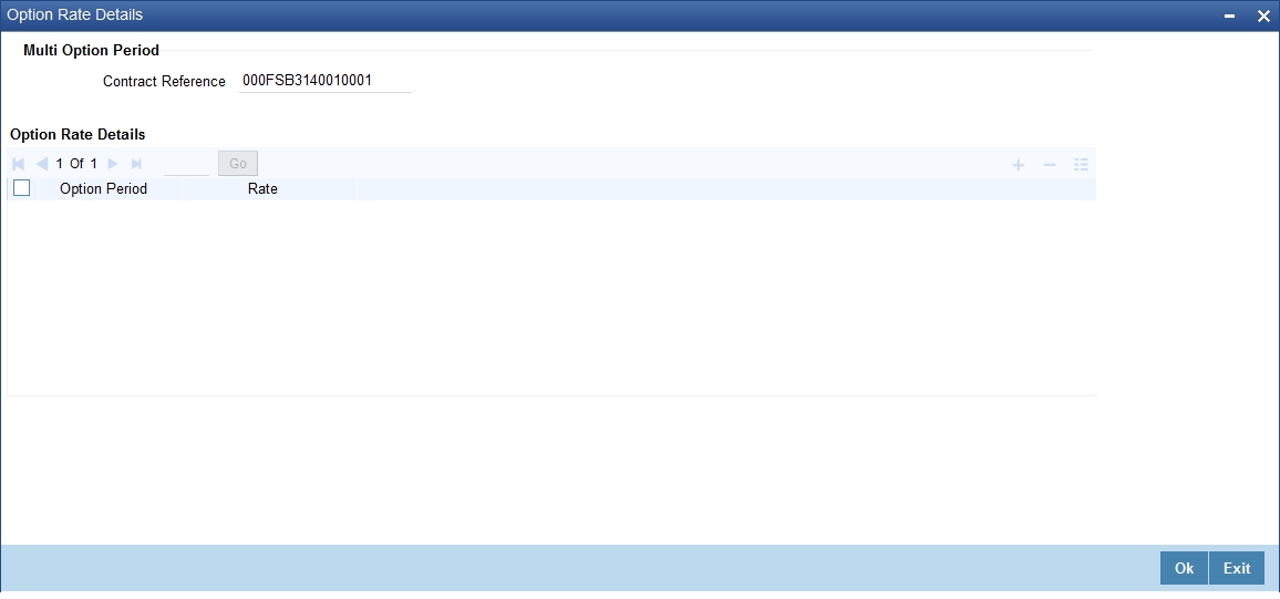

Option Date
You can specify an option date for forward deals if it has been allowed for the product it involves.
If a value date is specified then the maturity date of the deal can be changed to any day on or before the option date.

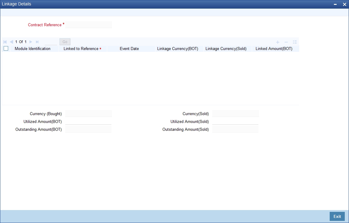

Linked Deal Details
After entering the combination deal and clicking on Linked Deal, the system displays an information message “Only 1st leg request processed successfully” and defaults the second.

By default, a forward contract that is marked for roll-over will be rolled-over with the terms of the original contract. However, you can change certain terms by specifying them in the ‘Roll-over Instructions’ screen. Click on Roll-over In the FX Contract to go to the ‘Roll-over Instructions’ screen.
Roll-over instructions (for forward contracts) can be input only through the Unlock operation. You cannot input them when you are entering the contract details through the New or Copy operation.
Auto Rollover
While setting up a product, you should specify whether contracts involving the product should be rolled over on the maturity date. If rollover is applicable, you can specify in this field whether contracts involving this product should be rolled over automatically or manually.
If you want the contract to be automatically rolled over, click on the check box against this field. The contract will be automatically rolled over on its Value Date (settlement date).
If you do not click on the check box, you should manually roll over the contract. To manually roll over a contract, enter the date on which the contract should be rolled over in the Rollover Date field.
Rollover Required
In this field, you can specify whether rollover is required or not, for contracts involving this product.
If check this box, rollover is allowed for contracts involving this product. During contract processing, you can specify whether such contracts should be automatically or manually rolled over.
If you do not check this box, rollover is not allowed for contracts involving this product.
Note
If you have selected Yes in the Auto Liquidation field, the Rollover Allowed field should be set to No. In other words, if contracts involving this product are to be automatically liquidated on the maturity date, these contracts cannot be automatically rolled over.
Sold Amount
This is the Sold amount of the new contract. The Sold amount of the old contract will default here if the Deal Type is Sell.
Sold Value Date
This is the settlement date of the Sell contract as specified in the Contract Details table.
If Split Value Dates are allowed for the contract, the Bought and Sold legs of the contract can have different settlement dates
Bought Amount
This is the Bought Amount of the new contract. The Bought Amount of the original contract defaults here if the Deal Type is Buy.
Bought Value Date
This is the settlement date of the new contract. Enter a date that is later than the Value Date of the original contract.
For forward contracts, enter a date that is later than the Spot Date of the currency. If an Option Date is allowed for the product involving the contract, enter a date that is later than the Transaction Date and earlier than the Value Date of the contract.
Rollover Exchange Rate
The Exchange Rate between the currency pair involved in the contract is displayed here.
You can change the Exchange Rate that is displayed here. Since the rate that you enter here would be different from the Standard Exchange Rate it is referred to as a Exchange Rate Variance.
You cannot enter a rate that exceeds the Maximum Exchange Rate Variance that you have defined for the product (in the ‘Product Preferences’ screen).
Rollover Spot Rate
For contracts involving local currency, the Spot Rate of the foreign currency is taken as the default Spot Rate.
For cross currency contracts, the rate between the two currencies as maintained in the Currency table is taken as the default Spot Rate. If the rate between the two currencies has NOT been maintained, the Spot Rate of the P & L Currency against the local currency is taken as the default Spot Rate.
You can change the Spot Rate displayed in this field.
Rollover Date
This is the date on which the contract is to be rolled over.
Spot Date
For contracts involving the local currency, the Spot Date of the foreign currency in the pair is taken as the default Spot Date.
For cross currency contracts, the Spot Date of the P & L Currency is taken as the default Spot Date. For example, if the currency pair involved is GBP/USD and if you are buying GBP, the Spot Date of GBP is displayed here.
You can change the Spot Date displayed in this field.
Rollover Local Currency Equivalent
The local currency equivalent of the amount involved in the contract is displayed here. This amount can be changed. This is calculated according to the rate maintained in the Currency table. For cross currency contracts, this amount is calculated as:
(Bought Amount * Spot LCY Rate for Bought CCY) * (Sold Amount * Spot LCY rate for Sold CCY)/2
Rollover Premium Discount
For forward contracts, this is the Premium or Discount Amount that is applicable as on the date the contract was initiated. It is calculated as the difference between the amount in Term Currency (as on the Transaction Date) and the amount in Term Currency (as on the Value Date).
The following terms can be different for the new contract:
After you enter the details click on the ‘Yes’ button. If you do not want to save the details you entered, click on the ‘No’ button.

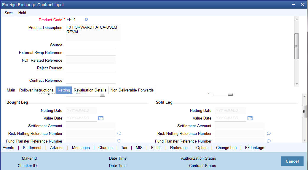

You can specify the netting preferences in the ‘Netting’ tab of the ‘FX Contract’ screen.
The following details can be captured here:
Netting Type
In this field you must first indicate the type of netting. You can net the contracts involving a customer in two different ways. Contracts can either be netted
If you choose to net contracts pair wise, the system selects all contracts that have been specified for pair wise netting, for the counterparty. Contracts that have the same currency pair, irrespective of whether they are bought or sold, will be netted.
If you choose to net contracts currency wise, the system selects all contracts that have been specified for currency wise netting, for the counterparty. The value date of the bought currency leg and that of the sold currency leg are considered individually to arrive at the netting date.
Netting Customer
The FX netting customer of the contract’s counterparty will be displayed here. This would be defaulted from the FX Netting Customer which you have specified for the Counterparty in Customer Information maintenance for the Counterparty. A reference is made to the Customer Maintenance while entering a new contract or amending an existing one.
For every customer, FX contracts are collated based on the FX Netting Customer during the Netting Process-Automatic and Manual.
Netting Status
The status of netting is displayed in this field. Depending on whether the netting type is currency-wise or currency pair-wise, the status will be displayed as any of the following:
Mode of Netting
Mode of netting is defaulted from the netting agreement maintenance of the FX Netting customer. You cannot override the value of this field for the specific contract. But by changing the value of ‘Netting Type’, Mode of Netting will undergo certain alterations.
If you choose Currency Wise or Pair wise netting as the ‘Netting Type’, a reference is made in the netting agreement maintenance of the counterparty and the corresponding mode is reflected here also.
If you choose ‘No Netting’ as the Netting Type, Mode of Netting will be reset as a blank value.
Specify the following details.
Netting Date
Specify the date on which you want to net the bought leg of the deal.
Value Date
This is the date on which the bought leg of the contract is to be settled.
Settlement Account
Specify the settlement account to be used while netting the Bought leg of the deal.
Risk Netting Reference Number
The reference number being used to utilize the limit for the netted amount for the bought leg will be displayed here.
Fund Transfer Reference Number
The reference number of the funds transfer used for netting the bought leg is displayed here.
The netting reference number of the bought leg is displayed here.
Related Foreign Exchange Contract
Specify the related FX contract for netting.
Netting Date
Specify the date on which you want to net the sold leg of the deal.
Value Date
This is the date on which the sold leg of the contract is to be settled.
Settlement Account
Specify the settlement account to be used while netting the sold leg of the deal.
The reference number being used to utilize the limit for the netted amount for the sold leg will be displayed here.
The netting reference number of the sold leg is displayed here.
You can also specify if Netted Limit Tracking is required for the FX contract.
Settlement Risk
You can specify whether settlement risk tracking should be done on the netted amount for all FX being netted for the customer. This will be defaulted from the Limits netting agreement.
Risk Weighted Risk
You can specify whether risk weighted limit tracking should be done on the netted amount for all FX being netted for the customer. This will be defaulted from the Limits netting agreement.
Pre-Settlement Risk
You can specify whether pre-settlement risk tracking should be done on the netted amount (net of revaluation gain/ loss) for all FX being netted for the customer. This will be defaulted from the Limits netting agreement.
Risk Netting Type
The netting type will be displayed here. This will be defaulted from the limits netting agreement of the counterparty or FX netting group customer.
The limits tracking options will be defaulted from the limits netting agreement maintenance applicable for the counterparty. You can modify the limits tracking options during FX contract input.
The process for defaulting from the limits netting agreement is as follows:
During copy operation, the limits tracking options will not be copied from contract. These will be defaulted from limits netting agreement.
During limits processing, the credit lines and limits netting type will be picked from the limits netting agreement.

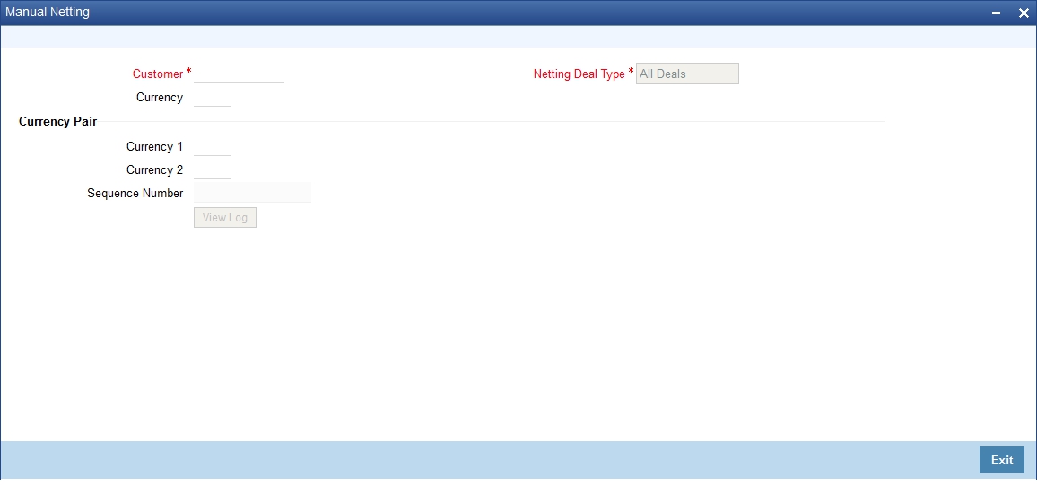

You can invoke the ‘Manual Netting’ screen by typing ‘FXDMANNT’ in the field at the top right corner of the Application tool bar and clicking on the adjoining arrow button.
To initiate manual netting of FX contracts for a specific customer, you have to enter the following details in the ‘Manual Netting’ screen:
Customer
The adjoining option list displays the customer number of the customer for whom you wish to initiate manual netting. Choose the appropriate one.
You can also choose customers whose contracts are marked for auto netting. If you choose to manually net the contact of an auto netting customer, an override will be displayed prompting you for confirmation. On confirmation, you will be allowed to initiate manual netting.
Currency
The adjoining option list displays a list all the currencies in which the specified customer has contracted that requires ‘netting’. You can choose the currency which has to be manually netted. Alternatively, you may choose currency ‘All’ whereby all currencies in which the customer has dealt with will be manually netted.
Currency Pair
The adjoining option list displays a list of all currency pairs that the specified customer has dealt which also require to be ‘netted’. You can specify the pair for which you wish to initiate manual netting. Alternatively, you may specify ‘All, All’ as the currency pair whereby all the currency pairs in which the customer has dealt with will be chosen for manual netting. Choose the appropriate one.
While initiating the manual netting process:
If you have specified a currency for manual netting, the system will pick up all contracts of the customer having the particular bought or sold currency whose value date is less than or equal to the netting date and which requires netting. If you have selected currency, ‘All’, all the contracts of the given customer will be chosen.
If you have chosen a currency pair, the system will pick up all the contracts having the same currency pair that requires netting. If you have specified the ‘All, All’ as the currency pair, all the contracts for that customer will be picked up for manual netting.
Note
If currency ‘All’ or currency pair ‘All, All’ has been chosen, an override will be displayed, to confirm whether netting needs to be performed for all the currencies.
Netting Deal Type
Select netting deal type from the drop-down list. Following are the options available:
Automatic netting process will pick up all those contracts marked for automatic netting for the specified customer. Netting will be done irrespective of the currency chosen.
Manual netting process can be initiated for contracts that are marked for manual netting and auto netting. Netting will be done only for those contracts that have specified a currency/currency pair unless you have chosen ‘All’ option.

You should give valid inputs in all the mandatory fields. If not, you cannot save the contract. After you have finished giving all your inputs, save the contract using one of the following methods:
At the time of saving a Foreign Exchange contract, certain information about the Foreign Exchange contract will be passed to the FATCA accounts and obligations maintenance for the customer. This will be done if the beneficiary account’s customer has a reportable FATCA classification and if the Foreign Exchange product used to book the contract is present in the FATCA Products, account class and Instruments maintenance.
If the FX contract is closed or liquidated completely, then the corresponding row in FATCA accounts and obligations maintenance will be archived. If you delete the FX contract before authorization, you should also delete the corresponding entry in FATCA accounts and obligations maintenance.

The risk tracking on the netted amounts of the FX contracts will be done only when the netted risk tracking options are checked at the contract level (‘Netting’ screen of FX contract).
The risk tracking on netted amounts will be done even when the contract is not marked for netting of settlements. The settlement netting and limits netting are totally independent features.
The non netted risk tracking options and netted risk tracking options are totally independent features. In case both are checked then Oracle FLEXCUBE supports tracking of risk contract wise as well as netting bucket wise. In case both features need to be tracked it is better you maintain a separate set of credit lines. The system will not cross validate the credit lines maintained for contract wise risk tracking and netting bucket wise. However the system will validate the credit lines maintained for netted risk tracking alone.
The netted risk tracking will be done on both bought leg and sold leg separately. The risk netting reference number of the bought leg in FX contract online will identify the contracts for which the bought leg is tracked. The risk netting reference number of the sold leg in FX contract online will identify the contracts for which the sold leg is tracked.
Oracle FLEXCUBE will internally store the net inflow/outflow amount for both sold and bought legs of FX contracts which have risk netting feature set for any of the 3 risks.
The following details will be stored in net inflow/outflow details:
When the FX contract which forms part of netting bucket is input the following will be done:

For a forward contract having a multi option period you can specify the period for which the forward rate is to be captured. After you specify the period you have to indicate the forward rate for the respective period.
To maintain a forward rates list click on the ‘Option’ button in the ‘FX Contract Details’ screen. The ‘Multi Option Details’ screen will be displayed.
Note
The details captured in this screen are meant for your bank’s reference and will not be used while processing the contract.

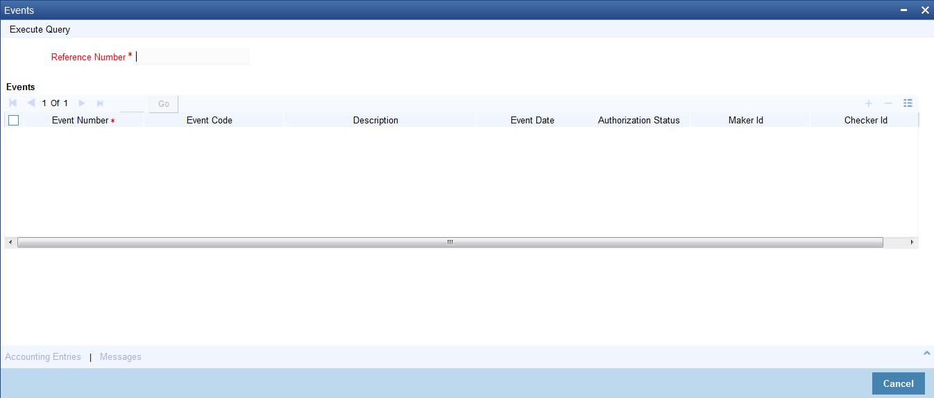

Click on ‘Events’ in the ‘FX Contract’ screen to go to the ‘Events’ screen.
Along with the details of events that have already taken place on the contract, the details of pending events will also be displayed.

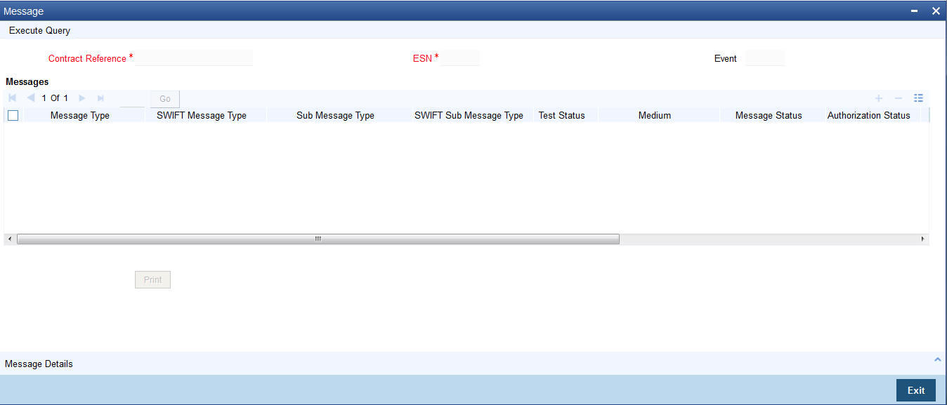

Click on ‘Messages’ button to view the messages linked to each event.

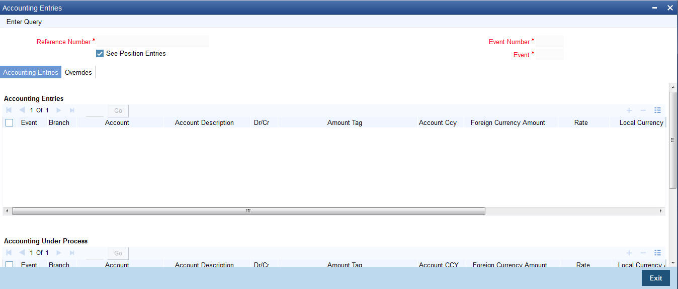

Click on ‘Accounting Entries’ button to view the accounting entries for the event.
The following details will be provided for each entry:

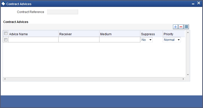

The advices that have to be generated for the various events of a contract should be defined at product level and would be generated once the product is authorized. This will be applicable to all contracts involving the product.
Click on ‘Advices’ button in the ‘FX Contract’ screen. The ‘Advices’ screen will be displayed.
You can change the following information regarding the advices generated for a contract:
By default, all the advices that have been defined for a product will be generated for a contract. However, you can suppress the generation of an advice for a contract by specifying so in this screen. Select Yes if the advice has to be suppressed.
All advices will be sent on a Normal priority. You can change the priority of an advice to Urgent through the ‘Advices’ screen. In the Priority column in this screen, select Urgent if the advice has to be sent on an Urgent basis.
After you have made the changes, click on ‘Yes’ button to save the changes. Click on ‘No’ button to reject the changes you have made. In either case, you will be taken back to the screen from where you invoked this screen.

Oracle FLEXCUBE supports linkage of FX deal in funds transfer cross currency transaction. An FX forward contract can be linked to more than a single payment; however, a payment can have only one FX forward contract. An FX contract can be linked to both incoming and outgoing payments. You can view these linkage details in FX linkage screen.
Click ‘FX Linkage’ link in the ‘Foreign Exchange Contract Input’ screen.
You can view the following details here:
For further details on processing linked FX contracts refer Processing Linked FX Contracts section of this chapter.

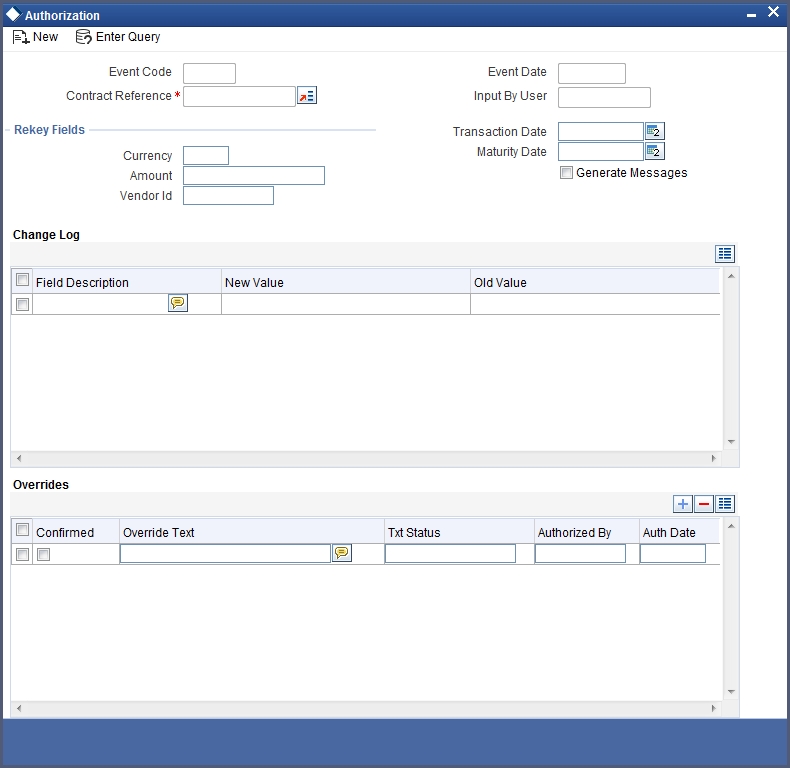

You can invoke the ‘Contract Authorization’ screen by selecting ‘Authorize’ icon from one of the following screens:
From Contract Summary View, select the Authorize option when the contract is highlighted. From the ‘Contract Detailed View’ screen, choose Authorize when the details of the contract are being displayed.
The ‘Contract Authorization’ screen will be displayed.
The following details will be displayed here:
Contract Reference Number
The FX contract reference number is displayed here.
Event Code
The code of the event happening on the contract is displayed here.
Event Date
The date on which the event happened is displayed here.
Maker
The name of the maker of the contract is displayed here.
Generate Messages
Check this box if you want the system to generate messages for the event once it is authorized.
If the contract involves a product for which some Re-key fields have been defined, the details of the contract will be displayed only after you input the values in those fields. If no Re-key fields have been defined, the details of the contract will be displayed in the ‘Authorization’ screen.
If you are authorizing an amendment, the old values of the fields that were modified will be displayed along with the new values. In the re-key fields, you should enter the values that were given during the amendment.
All the overrides that were given during the input or modification will be displayed when the contract is being authorized. The central liability checks (checks to see whether the credit limit allotted to the customer have been exceeded due to this contract) will be done now. If there are any excesses, you will be prompted to give an override. The contract will be authorized only if you give the overrides. If not, the contract will not be authorized and you will be returned to the ‘Contract Detailed View’ screen.
When an amendment is authorized, the old values will be replaced with the new ones. The details of the contract with the old values will be available in the earlier version of the contract.
Click on ‘No’ button if you do not want to authorize the contract. Click on ‘Yes’ button if you want to authorize the contract.
You will be prompted to confirm the authorization. After the contract has been authorized, you will be returned to the screen from where you invoked the ‘Contract Authorization’ screen (Contract Summary View or Contract Detailed View).

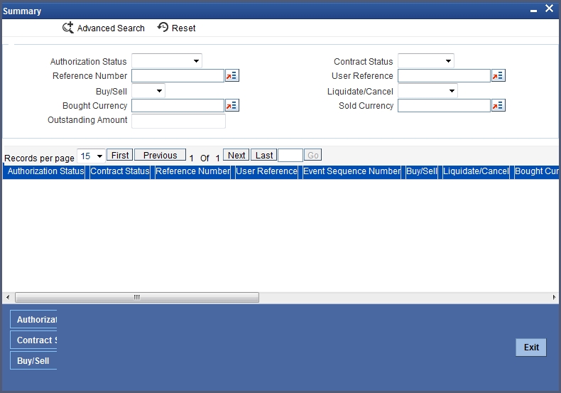

Typically, FX contracts must be authorized in the respective ‘Contract Online’ screens. This method of authorizing the contracts can be quite cumbersome, especially if the volume of transactions is large. In view of that, Oracle FLEXCUBE allows bulk authorization of all unauthorized FX contracts from the ‘Unauthorized Contracts’ screen. Invoke this screen from the Application Browser.
In the ‘Unauthorized Contracts’ screen, you can indicate the following parameters:
Module
Specify the module (LD, MM or FX) whose contracts have to be authorized.
On selection of the module, all unauthorized contracts pertaining to that module will be displayed in the grid.
Ignore Overrides
Check this box if you want the system to ignore the overrides generated at the time of authorization.
If the overrides of the contract are not authorized, system displays an error message.
For example, if the maturity date of a contract is 30th December 2009 and is a holiday for your bank, system will display an override message as “30-DEC-2009 is a holiday”.
However, you can opt to ignore such overrides by checking against ‘Ignore Overrides’.
Generate Messages
Check this box if you want the system to generate messages associated with authorization.
On authorization of a contract, the messages associated with the contract will be generated.

The authorization session for a manual rollover involves the authorization of two operations -- the manual liquidation of the original contract and the initiation of the new contract.
When a contract has been rolled-over manually, you have to perform two authorizations: one for the liquidation of the original contract and another for the initiation of the new contract. When you invoke such a contract for authorization, the details of the liquidation of the original contract will be displayed. The procedure for authorizing the rolled-over contract is similar to the one for authorizing a new contract.

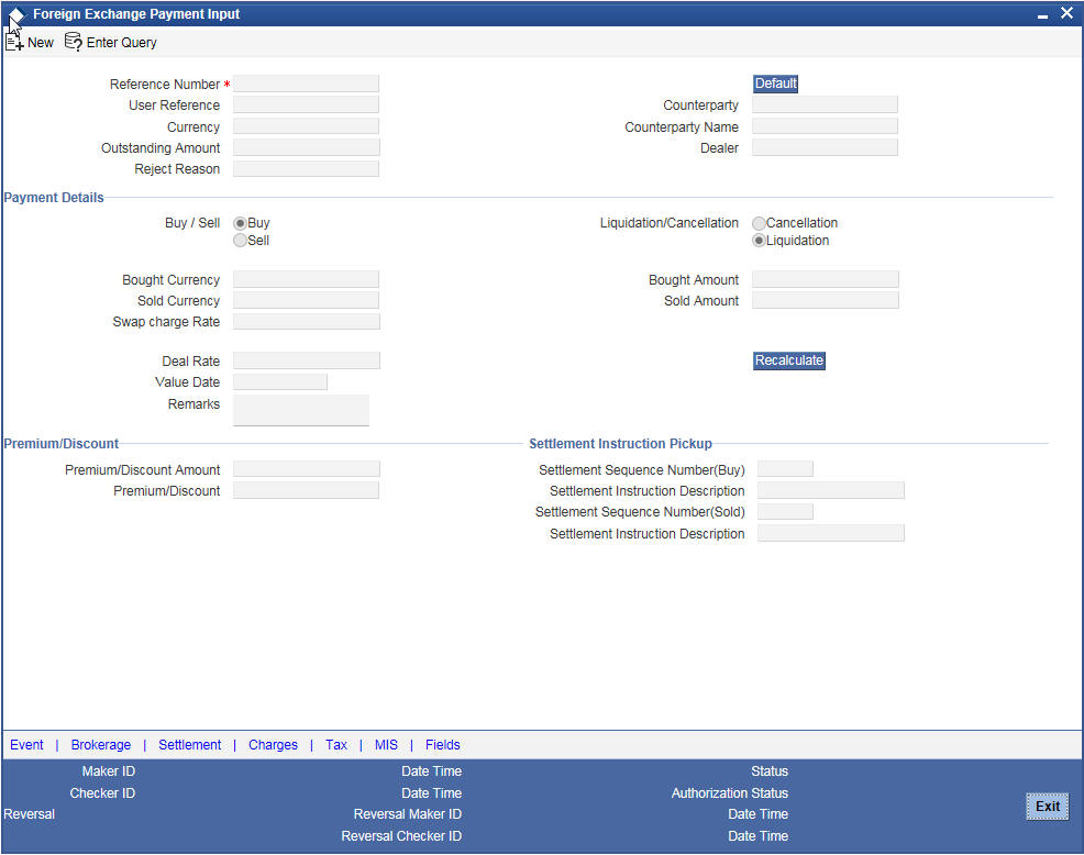

Through the FX Liquidation/Cancellation function of Oracle FLEXCUBE you can cancel or liquidate FX deals either partially or completely. You can invoke the ‘Foreign Exchange Payment Input’ screen by typing’FXDTRPAY’ in the field at the top right corner of the Application tool bar and clicking on the adjoining arrow button.
The basic details of the deal indicating whether it is a Buy or Sell type of deal, the currency of the deal and the buy and sell currency and amounts will be displayed. You have to indicate whether the deal amount is to be liquidated or cancelled, and specify relevant details such as the Deal Rate and Amount.
To maintain details of a new FX Cancellation/Liquidation record, select ‘New’ icon in the Application tool bar or click new icon. The ‘FX Liquidation/Cancellation’ screen will be displayed without any details.
Every record that you create will be processed in Oracle FLEXCUBE only after it is authorized. A user bearing a different Login ID can authorize the record that you have created.
The following details are displayed/captured here:
Reference Number
This is defaulted from the contract online.
You can fetch the transactions of all branches by choosing either contract reference number or branch from this option list.
User Reference Number
Outstanding Amount
Currency
Counterparty Name
The system displays the name of the specified counterparty based on the details maintained at ‘Customer Maintenance’ level.
Dealer
Buy/Sell
The Buy option is selected if it is a Buy type of deal. If it is a Sell type of deal, the Sell option is selected.
Liquidate/Cancel
This indicates whether the deal is liquidated or cancelled.
Bought/Sold Currency
The currency of the bought leg and the sold leg of the FX contract is displayed in the Bought Currency and Sold Currency respectively.
Bought/Sold Amount
FX deals can be cancelled partially and the balance either extended or settled. You also have the option of cancelling the deal completely. Similarly, you also have the option of liquidating the deal either partially or fully.
The entire amount involved in the deal will be picked up and defaulted in the Bought/Sold Amount fields respectively. If you are performing a partial liquidation you have to specify the amount that is to be liquidated. If not, the entire amount will be liquidated, and the system will treat it as an early settlement of the deal.
Similarly, if you are performing a partial deal cancellation, you have to indicate the amount that is to be cancelled. When the deal amount is left as it is the system will treat it as deal cancellation.
On saving the transaction after entering all the required details in the system, the system validates the value of the bought/sold amount against the following:
If the transaction currency and the limit currency are different, then the system converts the amount financed to limit currency and checks if the same is in excess of the product transaction limit and user input limit. If this holds true, the system indicates the same with below override/error messages:
Deal Rate
The Deal Rate is used when the buy currency of the deal is different from the sold currency. It will be defaulted from the ‘FX Contract Online’ screen. While liquidating a contract, you can choose to change the deal rate.
When you change the deal rate of a buy type of contract the system automatically calculates the new Sold Amount and displays it in the respective field. For instance, let us assume that you are partially liquidating a Buy Type of FX Contract. The contract amount is USD 2000. The other details of the contract are as follows:
If you choose to change the Bought Amount to USD 1200. The system does the necessary calculations and displays the Sold Amount as GBP 600. On the other hand, if you change the Deal Rate from 0.5 to 0.6, the Sold Amount will be changed to GBP 1200.
Similarly when you are liquidating a Sell Type of FX Contract you can choose to change either the Sold Amount or the Deal Rate. Accordingly, the system will calculate the Bought Amount.
Value Date
This is the date on which the contract was liquidated or cancelled.
Remarks
While liquidating or cancelling an FX deal, you can enter information about the deal intended for your bank’s internal reference. This information will not be printed on any correspondence with the customer.
Premium Discount
This indicates whether the contract results in a premium or a discount.
Premium Discount Amount
The difference between the Spot Equivalent in LCY and the Contract Amount in LCY is the Premium or Discount Amount. A minus sign indicates that the contract is at a discount.
For contracts involving the local currency, the local currency is taken as the P & L Currency. When such a contract is revalued, the Spot Rate (of the P & L Currency as on the revaluation date) is applied on the contract amount to calculate the Spot Equivalent in LCY. The difference between the Contract Amount in LCY and the Spot Equivalent in LCY is the Premium or Discount Amount. A minus sign indicates that the contract is at a discount.
For cross currency contracts, the Spot Rate of the P & L Currency, as against the other currency, is used to calculate the amount in terms of the P & L Currency. The local currency equivalent of this amount is calculated as the Spot Equivalent in LCY. The difference between the Contract Amount in LCY and the Spot Equivalent in LCY is the Premium or Discount Amount.
If the cross currency rate has NOT been maintained, the Spot Rate of the P & L Currency is applied on the contract amount to calculate the amount in terms of the P & L Currency. The local currency equivalent of this amount is calculated as the Spot Equivalent in LCY. The difference between the Contract Amount in LCY and the Spot Equivalent in LCY is the Premium or Discount Amount.

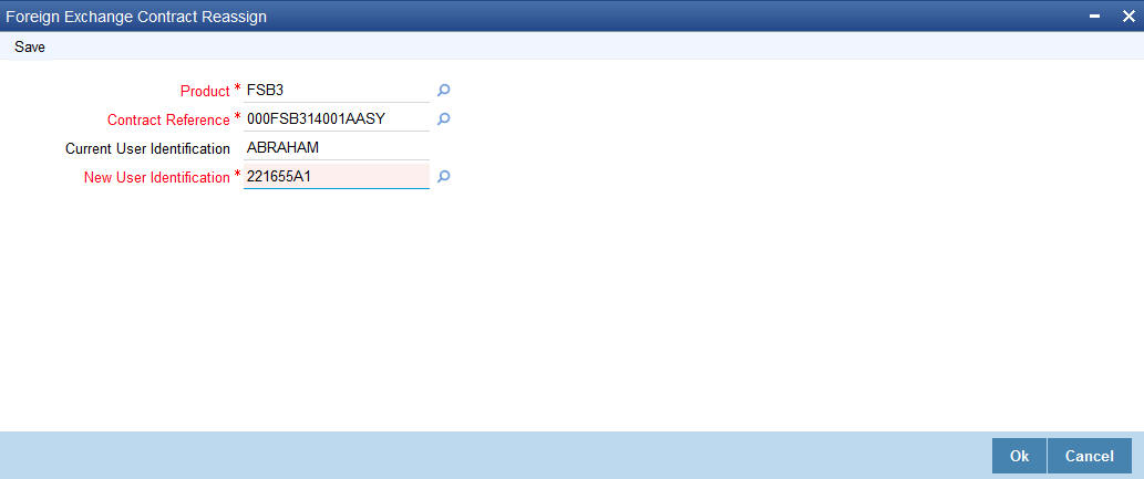

You can invoke the ‘Foreign Exchange Contract Reassign’ screen by typing ‘FXDREAS’ in the field at the top right corner of the Application tool bar and clicking on the adjoining arrow button.
The ‘Contract Reassign User - Prior to Authorization’ screen will be displayed and you can enter the user-id of the user to whom you want to assign the contract. This user should have access rights to enter FX contracts.
The following details needs to be entered here:
Product
Enter the product code of the contract you want to assign to another user.
Each contract has a unique Reference Number. This number is automatically generated by the system during contract processing. Enter the Reference Number of the contract that you want to assign to another user.
Current User Identification
Specify the user id of the current user.
New User Identification
Specify the user id of the new user to whom you want to assign the task.
Click the option list next to the respective fields to select the required inputs for Product, Contract Ref. No and New User ID.
Click on ‘Yes’ button to save the details you entered. Click on ‘No’ button if you do not want to save the details.
You can view the FX payment details in the ‘Foreign Exchange Payment Summary’ screen. To invoke this screen, type ‘FXSTRPAY’ in the field at the top right corner of the Application tool bar and click the adjoining arrow button.
The screen is given below:
You can click ‘Search’ button to view all the pending functions. However, you can to filter your search based on any of the following criteria:
Authorization Status
Select the authorization status of the contract from the drop-down list.
Reference Number
Select the reference number from the option list.
Buy/Sell
Indicate whether buy or sell from the drop-down list.
Bought Currency
Select the bought currency from the option list.
Outstanding Amount
The outstanding amount maintained is displayed here.
Select the user reference number from the option list.
Contract Status
Select the status of the contract for which you want to check the pending function from the drop-down list.
Liquidate/ Cancel
Indicate whether liquidate or cancel from the drop-down list.
Sold Currency
Select the sold currency from the option list.
When you click ‘Search’ button the records matching the specified search criteria are displayed. For each record fetched by the system based on your query criteria, the following details are displayed:

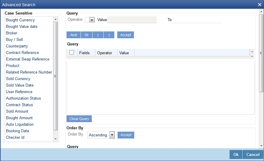

Click ‘Advanced Search’ to display the screen below:
You can query a contract based on any of the following details:
You can view the FX contract using ‘Foreign Exchange Contract Summary’ screen. To invoke this screen, type ‘FXSTRONL’ in the field at the top right corner of the Application tool bar and click the adjoining arrow button.

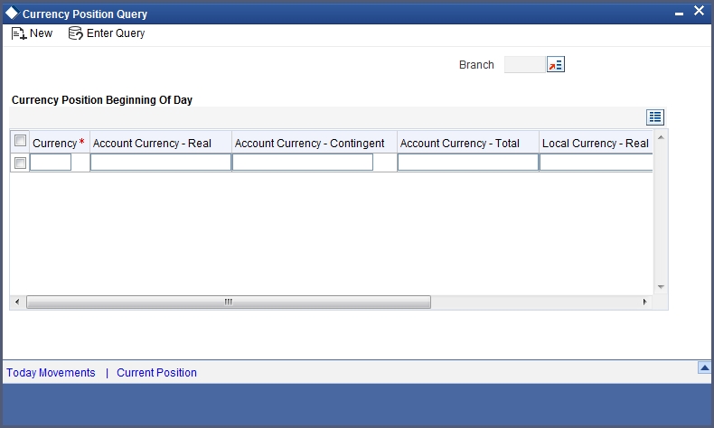

Your bank would have entered into numerous FX deals involving different currency combinations. During the day or end of day, you may want to view the FX positions for different currencies. Oracle FLEXCUBE allows you to view the currency positions through the online query feature. In the Application toolbar, type ‘CYDCCYPO’ in the field at the top right corner and click the adjoining arrow button to invoke the ‘Currency Position Query’ screen.
In this screen, system calculates and displays the FX positions for different currencies.
System calculates the FX positions for each currency for a particular day by using the accounting entries posted to different GL’s.
Note
System will calculate the accrual position separately for the GL’s for which the option ‘Report as Accrual’ is checked. Refer to the chapter ‘Setting up the chart of Accounts’ for further details.
For information purpose, system will also calculate and display the Open Position (Cash Position + Spot Position + Forward Position) and Global Position (Cash position + Spot Position + Forward Position + Accrual Position) for all the currencies.

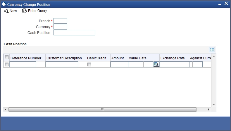

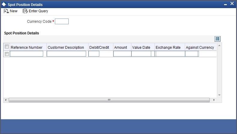

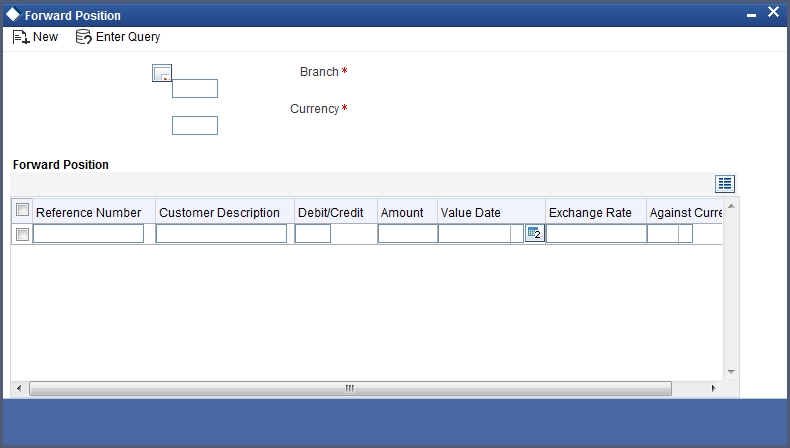

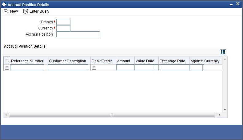

In the ‘Currency Position Details’ screen, you can double click on each cash, spot and forward positions to view the details of the individual FX deals that have contributed to the position. The details of the individual deals that will be available include:
Type ‘CYDCHPOS’ in the field at the top right corner of the Application toolbar and click the adjoining arrow button to invoke the ‘Currency Change Position’ screen.
Similarly, double click on spot, forward and accrual positions to view the details of the deals that have contributed to the respective positions.
The details are displayed in the Spot Position Details, Forward Position details and ‘Accrual Position Details’ screen respectively.
Note
You will notice that for cash and accrual positions, system displays the opening balances as on the date on which you are viewing the FX positions.

You can affirm or un-affirm, waive or un-waive a deal from ‘MM Affirmation Input’ screen. You can invoke this screen by typing ‘ FXDAFFRM’ in the field at the top right corner of the Application tool bar and clicking the adjoining arrow button.
You can maintain only one MM contract record in ‘MM Affirmation Input’ screen.The system displays the following fields in this screen:
Affirmation Status
Select the affirmation status of the FX deal. The options available are as follows:
If the affirmation status is changed from unaffirmed to affirmed and the affirmation type or affirmation reference number is not specified then the system displays an error message.
Confirmation Waiver Status
Select the FX deal confirmation waiver status. The options available are as follows:
You can modify either ‘Affirmation Status’ or ‘Confirmation Waiver Status’ at a time.
Affirmation Type
Specify the affirmation type. Alternatively, you can select the affirmation type from the option list. The list displays all valid affirmation type maintained in the system.
Affirmation Type Description
The system displays the description for the selected affirmation type.
Affirmation Reference Number
Specify the affirmation reference number.
Affirmation Reference Date
Select the affirmation reference date from the adjoining calendar.
Affirmation Remarks
Specify remarks, if any.

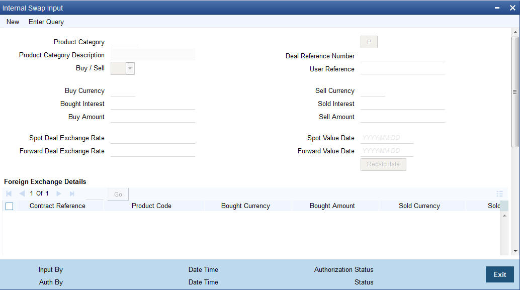

You can define internal swap transactions through the ‘Internal Swap Transactions’ screen. An internal swap transaction is a combination of FX and MM transactions generated for a deal between the FX desk and MM desk.
You can invoke the ‘Internal Swap Input’ screen by typing ‘FXDSWPIN’ in the field at the top right corner of the Application tool bar and clicking on the adjoining arrow button.
Product Category
You need to specify a product category for an internal swap transaction. All valid (Open and authorized) internal swap product categories will be available for selection.
Deal Reference Number
This is a 16 digit system generated reference number that will be used to link all the generated transactions. This will be generated using the product category which has been selected. This is a display field.
User Reference No.
You need to specify a User Reference Number. It should not exceed 16 characters. The number cannot be modified once it has been authorized
Buy Sell Indicator
You need to select the Buy/Sell indicator from the option list provided.
Buy Currency
You need to specify a currency. This will be used as the bought currency for the FX Spot transaction, the sold currency for the FX forward transactions and the currency for the placement transaction.
Sell Currency
You need to specify a currency. This will be used as the sold currency for the sold currency of the FX spot transaction, the bought currency for the FX forward transaction and the currency for the borrow transaction.
Buy Amount
You need to specify an amount. This will be used as the bought amount for the FX Spot transaction and the amount for the Placement transaction.
Sell Amount
You need to specify an amount. This will be used as the sold amount for the FX Spot transaction and the amount for the borrowing transaction.
Bought Interest
You need to specify the interest rate for the MM placement transaction. You can enter this value if the buy/sell indicator is chosen as Buy. If the internal swap transaction is Sell, then the system will calculate the interest rate during the processing of the transaction and the same will be displayed in this field.
Sold Interest
You need to specify the interest rate for the MM borrow transaction. You can enter this amount if the Buy/Sell indicator is chosen as Sell. If the internal swap transaction is Buy, then the system will calculate the interest rate during the processing of the transaction and the same will be displayed in this field.
Spot Deal Exchange Rate
You need to specify the exchange rate for the Spot FX transaction. If the amounts are specified, then the system will calculate the exchange rate.
Spot Value Date
This indicates the settlement date for the spot FX transaction and the value date for the MM borrow and placement transactions. The Application Date appears in this field by default and cannot be changed.
Forward Deal Exchange Rate
You need to specify the exchange rate for the forward FX transactions.
Forward Value Date
You need to specify the date. This will be used as the settlement date for the Forward transactions and the maturity date for borrowing and placement transactions.
The screen will also display the individual transactions created in detail blocks upon authorization of the internal swap input transaction. Three FX transactions created will be created within a single block and two MM transactions will be created in the other.
The information displayed for the FX transactions will be as follows:
On double clicking a row, the individual FX transaction will be displayed.
The information displayed for the MM transactions will be as follows:
On double clicking a row, the individual MM transaction will be displayed.
The Buy/Sell indicator is from the perspective of the Spot FX deal. All other deals will be derived from this.
The Buy/Sell currencies cannot be the same.
If the Buy/Sell indicator is chosen as Buy, it will be mandatory to input the interest rate for the Buy leg (Placement). In such a case the Sell leg interest rate will be disabled.
If the Buy/Sell indicator is chosen as Sell, it will be mandatory to input the interest rate for the Sell leg (Placement). In such a case, the Buy leg interest rate will be disabled.
The Forward Exchange Rate will be a mandatory field
The Spot Value Date and Forward Value Date will be mandatory fields.
If the Buy/Sell indicator is Buy, the field Buy Amount will remain constant for any combination with Sell Amount and Spot Rate
If the Buy/Sell indicator is Sell, the field Sell Amount will remain constant for any combination with Buy Amount and Spot Rate
The user can input any two of the three values – Buy Amount/Sell Amount/Spot Rate. The other value will be calculated by the system
If the Buy/Sell indicator is Buy and the Spot Rate is modified, the Sell Amount will be recalculated keeping the Buy Amount constant
If the Buy/Sell indicator is Buy and the Sell Amount is modified, the Spot Rate will be recalculated keeping the Buy Amount constant.
If the Buy/Sell indicator is Sell and the Spot Rate is modified, the Buy Amount will be recalculated keeping the Sell Amount constant
If the Buy/Sell indicator is Sell and the Buy Amount is modified, the Spot Rate will be recalculated keeping the Sell Amount constant.
The User Reference number will be defaulted to the Deal Reference Number and will be unique across all internal swap transactions.
You can close the swap deal. This will reverse the linked FX/MM deals on authorization
The FX Spot Contract created will be a cash deal settling on the Spot Value Date itself.
All the transactions will have the internal swap customer as the counterparty and the settlement instructions will be defaulted based on that.
The day count fraction for finding out the interest amount and the interest rate for the corresponding MM transactions will be derived from the currency of the respective MM contracts.
The interest rate type will be fixed for MM contracts.
If the Spot FX transaction is a Buy, then the other two Forwards will be Sells
If the Spot FX transaction is a Sell, then the other two Forwards will be Buys
MM placement transaction will have the deal currency as the Buy currency of the Spot FX Deal.
MM Borrow Transaction will have the deal currency as the Sell currency of the Spot FX deal.
The FX Interest Forward will be based on the interest amounts of the two MM deals. For example, if the FX Spot is a Buy deal, then the Placement Interest Rate will be provided. Using this, the interest amount of the MM Placement (which is also the Sell Amount of the FX Interest Forward) will be computed. The interest amount of the MM borrow (and the buy amount of the FX interest forward) is the maturity amount (maturity amount of the MM placement * forward exchange rate) – original borrow amount (sell amount of the FX spot). The interest rate for the MM borrow deal can be calculated by using the interest amount and the day count fraction of the deal currency.
For a Buy Internal Swap Transaction:
Interest amount of MM borrow Contract = Maturity amount of Placement * Fwd exchange rate – MM borrow amount
Interest Rate of the MM borrow = Interest amount of MM borrow Contract / (MM borrow amount * Day count)
For a Sell Internal Swap transaction:
Interest amount of MM placement Contract = Maturity amount of borrow * Fwd exchange rate – MM Placement amount
Interest Rate of the MM Placement = Interest amount of MM placement / (MM placement amount * Day count)
The exchange rate of the FX interest forward contract will be derived based on the buy/sell amounts.
If the interest rate calculated for the MM placement/borrow contracts does not lie between the minimum and maximum rates defined for the contract currency in the MM product, they will be updated to null at the contract level.
After the contracts are uploaded, they will behave like independent transactions.
