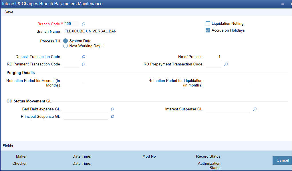

You can maintain branch parameters for each branch of your bank using the ‘Interest and Charges Branch Parameters’ screen for maintaining parameters related to Profit and Charges. You can invoke this screen by typing ‘ICDBRMNT’ in the field at the top right corner of the Application toolbar and clicking the adjoining arrow button.
You can maintain the following parameters here:
Branch Code
Branch code of the current branch is defaulted here. However; you can specify branch code from the adjoining option list, if needed.
Branch Name
Name of the specified branch is defaulted here.
Liquidation Netting
Check this box if you need netting for profit/charges liquidation.
Accrue on Holidays
Check this box to enable a separate consolidated accrual entry for the branch holidays.
Process Till
Select a date till when you need to process profit/charges from the options. The following options are available for selection:
Deposit Transaction Code
Specify a valid deposit transaction code from the adjoining option list.
No of Process
Number of the process is defaulted as ‘1’ here; however, you can modify if needed.
RD Payment Transaction Code
Specify a valid redemption transaction code from the adjoining option list.
RD Prepayment Transaction Code
Specify a valid redemption prepayment transaction code from the adjoining option list.
You can maintain the following purging details here:
Retention Period for Accrual (In Months)
Specify a valid retention period for accrual.
Retention Period for Liquidation (In Months)
Specify a valid retention period for liquidation.
You can maintain the following GL details here:
Bad Debit Expense GL
Specify a GL for posting the debit profit and principal for ‘Write-off’ status of the OD account, from the adjoining option list.
Interest Suspense GL
Specify interest GL for posting the offset entry for ‘Write-off’ status of the OD account, from the adjoining option list.
Principal Suspense GL
Specify principal GL for posting the offset entry for ‘Write-off’ status of the OD account, from the adjoining option list.

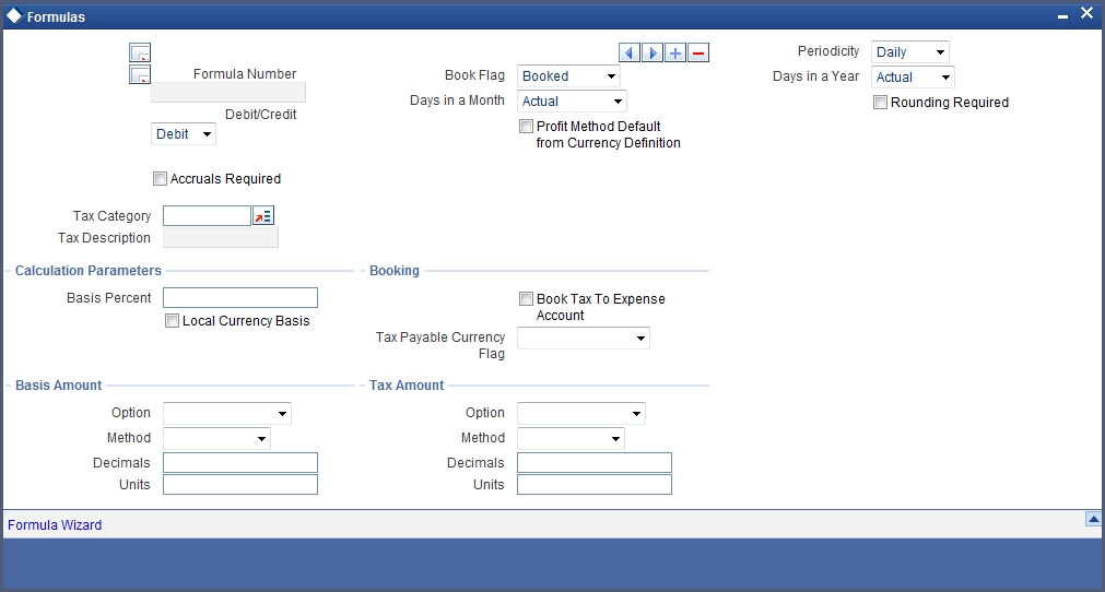

Using the SDEs and the UDEs that you have specified for a Rule, you can calculate profit. You have to specify the method for calculating profit in the form of formulae. Using the SDEs and the UDEs you can create any number of formulae for a Rule. Click ‘Formulas’ button to invoke ‘Formulas’ screen.
The following are the attributes of a formula:
Formula Number
Specify the method for calculating profit in the form of formulae. Using the SDEs and the UDEs that you have specified for a Rule, you can calculate profit and also create number of formulae for a Rule.
This field displays the formula number that you are defining for a Rule.
Book Flag
Select a valid booking flag you need to assign for the specified formula, from the adjoining drop-down list. This list displays the following values:
Periodicity
Specify a valid periodicity for the application of rule from the adjoining drop-down list. This list displays the following values:
The following example illustrates how the concept of periodicity of application of a formula functions:
Note that the periodicity that you enter here is different from the liquidation periodicity. The Periodicity that you define for a rule is a calculation periodicity. The Liquidation Periodicity is the interval between two successive automatic liquidations.
Debit / Credit
Select a valid type of profit you need to charge on an overdraft from the adjoining drop-down list. This list displays the following values:
Often, while calculating profit for an account, you would want to debit/credit profit under certain conditions. In such a case, you can build formulae to suit both conditions. The formula that is used to calculate profit for the account would depend on the condition that is fulfilled.
Note
For a Booking formula, the system automatically checks this box and disables this option.
The method in which the ‘N’ of the formula for profit calculation, PNR/100, has to be picked up is specified for a formula. This is done through two fields, Days in a month and Days in a year.
Days in a Month
Select the method in which the number of days for an account can be arrived for profit calculation, from the adjoining drop-down list. This list displays the following values:
Days in a Year
Select the total number of days in the year which you need to specify as the denominator value, based on which profit has to be applied, from the adjoining drop-down list. This list displays the following values:
The profit rate is always taken to be quoted per annum.
If you specify that the actual days in a year should be used for calculation of profit days, all calculations will be according to the number of calendar days in the year. For example, if it is a leap year, 366 days will be taken as the total period.
In case you choose to consider each year as having 360 days, all calculations will be based on this assumption. Irrespective of the number of days in the relevant year according to the calendar, the value will be calculated on the assumption that there are 360 days in the year.
In conclusion, the number of days to be used for calculation of profit can be any of the following combinations:
The following table illustrates how this is achieved in Oracle FLEXCUBE:
Days to be considered |
Specification in Oracle FLEXCUBE |
Actual/Actual |
Click on Actuals in ‘Days in a Month’ field. Click on Actuals in ‘Days in a Year’ field. |
Actual / 360 |
Click on Actuals in ‘Days in a Month’ field. Click on 360. days in ‘Days in a Year’ field. |
360/Actual |
Click on 30 days in ‘Days in a Month’ field. Click on Actuals in ‘Days in a Year’ field. |
360/360 |
Click on 30 days in ‘Days in a Month’ field. Click on 360 days in ‘Days in a Year’ field. |
Accruals Required
Check this box if you need to accrue the profit due to a specified formula.
You can opt to accrue the profit due to one formula and choose not to accrue the profit due to another formula that you are defining for the same rule.
Note
Only a booking formula can have accruals.
You can indicate if all the accrual entries generated can be passed for a product rather than for individual accounts linked to the product, as a preference at Product Preferences level.
The profit that is accrued can be posted into different accounts. The result of each formula is an accounting role and you can map each into a different GL/SL (Accounting Head).
Profit Method Default from Currency Definition
Check this box if you need to calculate profit based on the method defined for currency definition.
Rounding Required
Check this box if you need to round-off the results of non-booking formulae.
Tax Category
Specify the ‘tax category’ to which the Tax Rule belongs, from the adjoining option list. This list displays all valid categories which are open and authorized. If the tax category is not maintained, then the tax booked under this tax rule will not be considered for waiver/tax computation processing. However, normal tax processing will occur as usual
If the formula that you are creating is a tax formula, you have to specify if the tax amount would be borne by the customer or the bank.
For example, if the tax on the credit profit that you pay your customer is borne by the customer, you need to indicate this here. If, on the other hand, you charge a customer profit on the debit balance and bear the tax on your income, you should indicate that the bank would bear the tax. In either case, when you have to pay tax ultimately, one entry would involve the Tax Payable GL. The accounting Role, in both cases would be ‘Tax’. Choose the GL/SL head depending on whether the customer or the bank bears the tax.
Note
Tax Description
Description of the specified tax category is defaulted here.
You can maintain the following calculation parameters here:
Basis Percentage
Specify factor for computation of the taxable amount.
The basis percentage should be greater than 0 and less than or equal to 100. The basis amount would first be multiplied by this percentage to arrive at the actual basis amount on which tax needs to be computed. The inverse of the same factor would then be applied to the calculated tax amount to arrive at the actual tax amount.
Local Currency Basis
Check this box to indicate that the Basis Amount on which the tax is going to calculated, should be converted to local currency.
Book Tax to Expense Account
Check this box if you need to process Expense type of tax on profit and charges and to book it into a Tax Expense account, to be paid to the Government.
Tax Payable Currency Flag
Select the currency in which the tax on profit and charges should be paid from the adjoining drop-down list. This list displays the following values:
Option
Select the rounding option for conversion of the amount to calculation currency from the adjoining drop-down list. This list displays the following values:
Method
Select the method you need to apply to round-off the basis amount, if you have selected ‘Calculation Currency Rounding Option’ as ‘Specific’, from the adjoining drop-down list. This list displays the following values:
Decimals
Specify the number of decimals up to which you need to round-off/truncate, if you have selected ‘Calculation Currency Rounding Option’ as ‘Specific’. The rounding decimals defined here should be less than or equal to the decimals maintained at ‘Currency Maintenance’ level
Units
Specify the unit up to which you need to round the amount, if you have selected ‘Calculation Currency Rounding Option’ as ‘Specific’.
This represents the least amount that can be measured in a particular currency. The unit defined here should be a multiple of the unit defined at the ‘Currency Maintenance’ level.
Option
Select the rounding option for conversion of the amount to tax currency from the adjoining drop-down list. This list displays the following values:
Method
Select the method you need to apply to round-off the actual tax amount, if you have selected ‘Calculation Currency Rounding Option’ as ‘Specific’, from the adjoining drop-down list. This list displays the following values:
Decimals
Specify the number of decimals up to which you need to round-off/truncate, if you have selected ‘Calculation Currency Rounding Option’ as ‘Specific’. The rounding decimals defined here should be less than or equal to the decimals maintained at ‘Currency Maintenance’ level.
Units
The expression for the SDEs can be viewed by clicking ‘Formula Wizard’ button.
You can build expressions for SDEs using ‘Formula Wizard’ screen. Clicking on the ‘Formula Wizard’ button in the ‘Formulas’ sub screen.
For further details on building expression, refer ‘Building Formulae’ chapter of this User Manual.

You can maintain a rule to calculate the commission on highest debit balance for a particular month. In the ‘IP Rule Maintenance’ screen, you need to maintain the following details for calculating the commission.
SDE Elements |
User Elements |
HDB |
DR_COM_RATE |
Click Formulas to provide the following attributes to the formula for calculating the commission.
Debit/Credit |
Book Flag |
Periodicity |
Debit |
Booked |
Monthly |
Click ‘Formula Wizard’ to specify the formula (‘HDB* DR_COM_RATE)/ (100).Or else you can define another formula using the defined SDE.
You can link this rule to IP product with liquidation at month-ends. No accrual for this rule and it is considered as a charge. The CR GL mapped can be treated as a HDB commission income GL for the branch.
