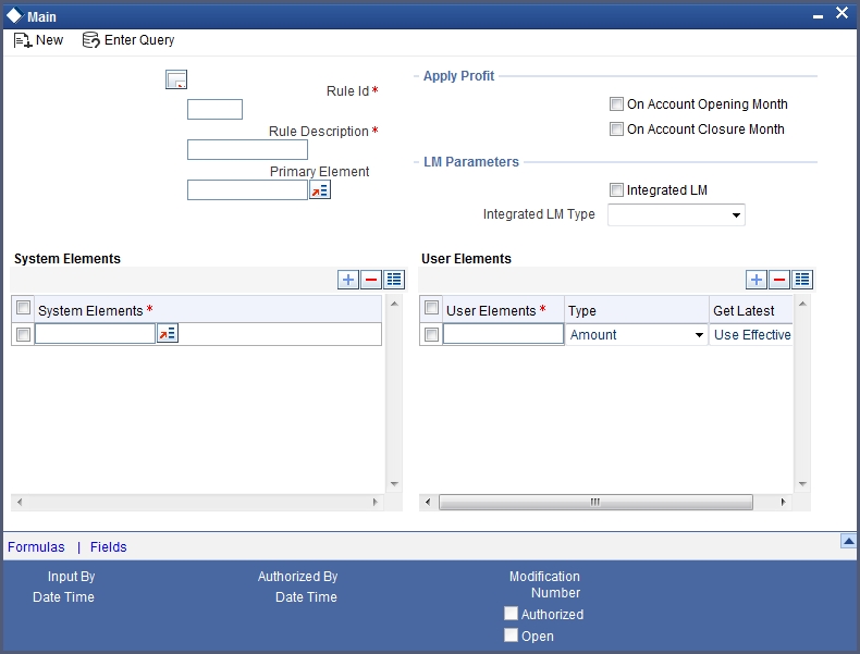

SDEs and UDEs are used to build formulae that result in the amount of profit that has to be applied.
You will have different types of accounts in your bank, such as current accounts, savings accounts, etc. On each of these accounts you would want to apply profit differently. On a savings account, for example, you may want to apply credit profit on the basis of the minimum credit balance during the month. On a current account you may want to apply charges on the basis of the turnovers, or, levy debit profit on the basis of overdrafts. Similarly, there may be various criteria based on which you would want to apply profit on an account.
Each such criterion (which the system has to pick up) has to be defined as an SDE in the ‘Account System Data Element Maintenance’ screen. You can invoke the ‘Account System Data Element Maintenance’ screen by typing ‘ICDSDEMN’ in the field at the top right corner of the Application tool bar and clicking the adjoining arrow button.
SDEs should be combined with UDEs into formulae to arrive at a method in which profit or charge has to be calculated.

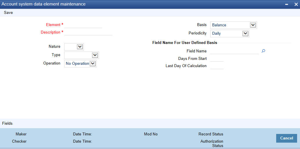

Element
Specify a unique ID for the System Data Element that you are maintaining.
Description
Specify a description of the SDE that you are maintaining in this field.
Basis
Select the Basis for the calculation of Profit from the adjoining drop-down list. This list displays the following values:
If you want to apply profit on an account based on the balance in the account, you have to first specify whether you would want to consider booking dated or value dated balances. Subsequently, you have to specify other characteristics for the balance.
When you are setting up the SDE, you can use normal balance or the balance due to the IP transactions. The basis for such SDEs is IP balance.
If the basis of an SDE is IP balance, then by rule, the nature of the SDE will be Net, the type of the SDE will always be the value dated balance and no further operations will be allowed on the SDE.
The sum of all the debit transactions in an account, in a day, is the daily debit turnover of the account. While calculating the debit turnover, the credit transactions involving the account would not be considered. If there are, say, two debit transactions in an account in a day, the debit turnover for the day would be the sum of the two - irrespective of the credit transactions involving the account on that day. The same concept applies to credit turnovers also. You could have monthly debit or credit turnover also.
Profit can be applied on an account differently, using different data as the basis. That is, you can apply profit on the basis of the item count, the balance, or the turnover in the account. In Oracle FLEXCUBE, Balances and Turnovers are referred to as ‘Basis’. While balances are considered for profit application, turnovers are considered for charges.
Note
Note
The balance in an account will be different when you consider it to be as of the booking date or as of the value date
Periodicity
Select period over which a balance or a turnover should be considered for profit application, from the adjoining drop-down list. This list displays the following values:
When a balance or turnover has to be picked up for profit application, it will be picked up for this period.
An example for a balance with daily periodicity could be the daily net balance in the account. Similarly, the monthly minimum credit balance, monthly maximum debit balance, etc. are examples of a balance with monthly periodicity. Similarly, you could consider the minimum credit balance over a quarter for profit application.
Note
This periodicity is for picking up the value of an SDE. It is not the periodicity at which profit is liquidated. The periodicity with which profit is liquidated is called ‘Liquidation Frequency’. Whenever profit has to be liquidated, either according to the liquidation frequency or on an ad-hoc basis, the balance will be picked up based on the SDE periodicity and applied for the entire liquidation period.
Note
The periodicity that you define for an SDE is not the same as the periodicity of rule application (defined for a profit rule). The periodicity of rule application (which could be daily or by periodic) also has a role in the way an SDE is picked up.
For further details please refer the ‘Maintaining Rules’ chapter of this user manual.
Nature
Select the nature of the balance or turnover, once you fix the ‘basis’ on which you want to apply profit for the specified SDE, from the adjoining drop-down list. This list displays the following values:
In the example discussed in the beginning of this section, we have seen various types of balances: on certain days there is a debit balance while on certain other days there is a credit balance in the account. These are referred to as debit balances and credit balances respectively.
Each balance in turn will have a periodicity and an aggregation operation attached to it.
Type
Select the date to be used for calculation, if you have indicated that the SDE is to be calculated on the turnover of an account, from the adjoining drop-down list. This list displays the following values:
Operation
Select the method in which a balance or turnover should be picked-up over its periodicity, from the adjoining drop-down list. This list displays the following values:
As discussed under ‘Periodicity’, for the ‘Minimum’ credit balance that has to be picked up over a month or the ‘Maximum’ debit balance for the month, the ‘Minimum’ and ‘Maximum’ denote an aggregation operation. Another aggregation operation would be the ‘average’. For example, you could have the average monthly debit balance or the average monthly credit balance as the attributes of an SDE.
If you choose to apply profit on the basis of the credit, debit or the net balance, you can specify that the balance to be considered is:
Note
If the periodicity for an SDE is daily and the basis is balance, then the balance taken will always be the net balance for the day. It cannot be the minimum, maximum or average balance.
The aggregation operation of ‘sum’ can be used when you want the SDE to return a value that is a sum of a few values. A typical usage of this aggregation operation will be when you want the sum of turnovers (debit or credit), or a sum of debit or credit items, over a period.
You can maintain the following parameters here:
Field Name
Specify a valid field name for user defined basis from the adjoining option list.
Days from Start
Specify day from when you want to compute profit for an account on the monthly minimum credit balance, the maximum monthly debit balance, or the average balance for a specific period.
The balance in the account, between the date that you specify here and the date that you specify in the ‘Last Day of Calculation’, will be used for calculation of profit.
The default value in this field is maintained as ‘1’. However, you can modify, if needed. For example, if you want to calculate profit from the 15th of a month enter ‘15’ here.
Specify day till when you want to compute profit for an account. You may have to consider the balances or turnovers, only during a specific period of the month.
For example, in some countries, credit profit for Savings Bank accounts is given for the minimum credit balance in the account during the month, between the 10 and 25 of the month. To define an SDE that returns the minimum balance between 10 and 25 of the month, you should define it as follows:

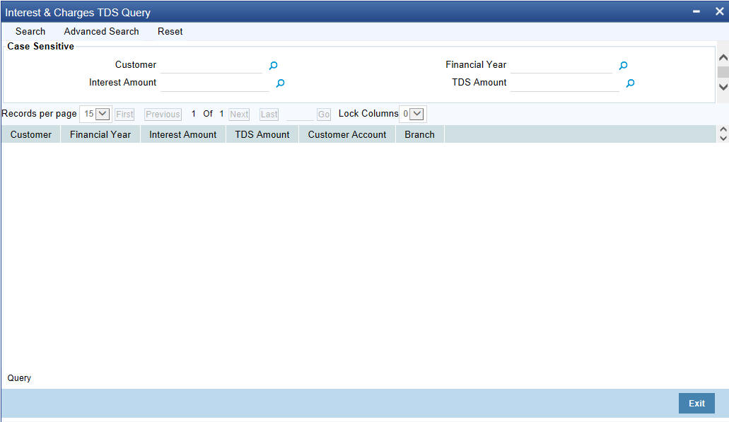

You can view the TDS details of the customer in the ‘Interest and Charges TDS Query’ screen. You can invoke the ‘Profit & Charges TDS Query’ screen by typing ‘TDSQUERY’ in the field at the top right corner of the Application tool bar and clicking the adjoining arrow button.
Customer
Specify a valid customer number based on which you wish to query, from the adjoining option list.
Financial Year
Specify a valid financial year based on which you wish to query, from the adjoining option list. The Financial year must be a past year.
Interest Amount
Specify a valid profit amount based on which you wish to query, from the adjoining option list.
TDS Amount
Specify a valid TDS amount based on which you wish to query, from the adjoining option list.
Click ‘Search’ button. The system identifies all records satisfying the specified criteria and displays the following details for each one of them:
