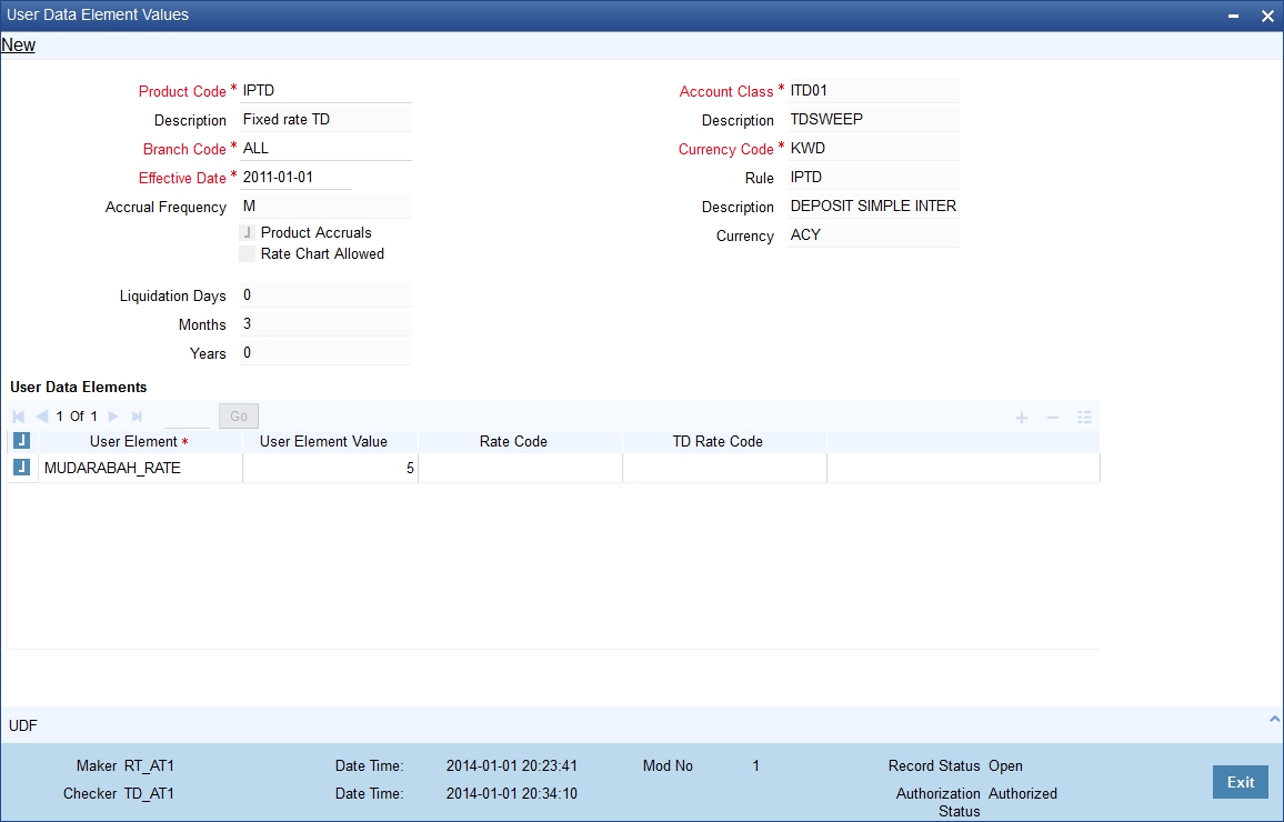

Continuing with the example, if you close the UDE record with Effective Date 1st January, 1998, in May 1998, for the entire liquidation period the UDE values specified for 1st April, 1998 will be applied for the product CRIN.
Note
Only if the periodicity (specified while creating a rule) is ‘Daily’ will the UDE values that you define for different effective dates will be picked up. If you specify the rule application periodicity as ‘Periodic’, then the UDE value as of the liquidation date will be picked up.
For each account class, you must specify the values of all the UDEs that you identified while building the rule. The UDE value that you specify here will be picked up while calculating profit for the account class.
All the UDEs that you have identified for the rule (to which the product is linked) will be displayed here. The UDEs that are displayed are of three types. They are:
The profit that you charge on a debit balance is an example of a debit rate. The profit that you charge on a credit balance is an example of a credit rate.
User Element
Specify a valid user element for the product code, from the adjoining option list.
A UDE will be an amount under the following circumstances:
User Element Value
Specify a valid user element value for the specified user element.
When you build a rule you will indicate the UDE to be a number, if the profit or charge is defined based on the number of transactions or the number of account statements. A UDE under this category can also be used to store a numerical value that may be used in a formula.
Now, for each of the UDEs that are displayed, you must specify the values. If the type of UDE that you have identified for the rule is a ‘Rate’ element, you can either specify a Rate Code or enter a ‘value’ for the Rate element.
If the type of UDE is an amount, then the value that you enter will be in the currency that you specified in the UDE amounts currency field at the Profit Preferences level. If you specified the UDE amounts currency as the local currency and the account class is in a foreign currency, then all UDE values will be converted to the local currency. Currency conversions will be on the basis of the exchange rates maintained for the day.
Rate Code
Specify a Rate Code for the UDE from the adjoining option list.
If you specify a rate code for the UDE, then the value that you have maintained for the rate code will be picked-up while calculating profit. However, if you choose to enter a ‘spread’ for the Rate Code, the appropriate value will be computed. If you do not specify a spread, the rate maintained for the Rate Code will be picked up.
A ‘Spread’ is a positive or negative value that you add or deduct to the value specified for the Rate Code.
For further information on Floating Rate, refer ‘Maintaining Floating Profit Rates’ under ‘Islamic Financing’ User Manual.

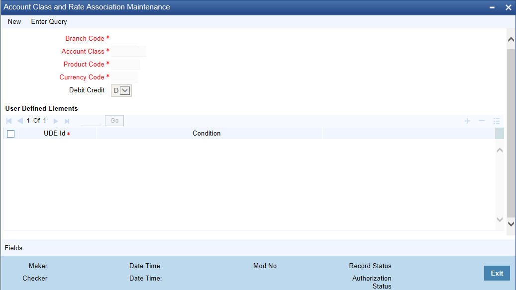

To recall, you associate an account class to a specific IP product through the ‘Profit & Charges – User Defined Element Values Maintenance’ screen. The rates applied are based on the IP rules maintained. Along with the different UDE rates defined in this screen, you also need to maintain whether a particular UDE applies for a credit profit rate or for a debit profit rate. Through this maintenance, the debit or credit rate for a particular account class and currency combination can be found.
It is through the ‘Account Class & Rate Association Maintenance’ screen that you maintain the above specifications. You can invoke the ‘Account Class & Rate Association Maintenance’ screen by typing ‘STDACRMT’ in the field at the top right corner of the Application tool bar and clicking the adjoining arrow button.
You can maintain the following parameters here:
Branch Code
Specify code of the branch for which a UDE is maintained from the adjoining option list. The option list displays branches that are allowed for your home branch
The branch code is displayed based on the Common Branch Restrictions for ICRATES for your branch. This occurs only if ‘ICRATES’ has been maintained as a Restriction Type at ‘Common Branch Restrictions’ level. Otherwise, all branch codes are displayed including the ‘ALL’ option.
Note
If your home branch is HO, the ‘Branch Code’ option list displays ‘ALL’ in addition to the list of branches allowed for your home branch.
Account Class
Specify a valid account class to which a UDE applies to from the adjoining option list. The option list displays the following account class types:
For further information on account classes, refer to the ‘Maintaining Account Classes’ section in ‘Maintaining Mandatory Information’ chapter of Core Entities User Manual.
Product Code
Specify the IP product name associated at the User Defined Elements Maintenance for the chosen account class, from the adjoining option list. For a given account class, only one IP product should be associated.
Currency Code
Specify the currency for the chosen account class and IP product combination from the adjoining option list. The option list displays all currencies maintained at ‘Currency Definition – Detailed’ level.
Debit Credit
Select the type of UDE you need to maintain from the adjoining drop-down list. This list displays the following values:
User Defined Element ID
Specify the relevant UDE name for the chosen account class and IP product combination from the adjoining option list. The option list displays UDEs maintained at ‘Profit and Charges – User Defined Element Values Maintenance’ level.
The following points are noteworthy:

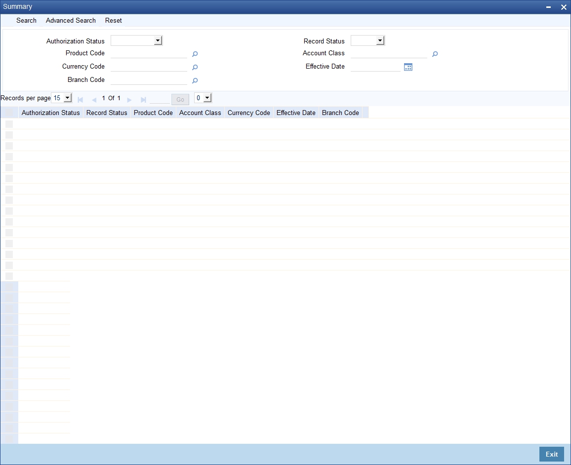

You can print out UDE values. You can invoke the ‘Profit & Charges User Data Element Summary’ screen by typing ‘IPSUDVAL’ in the field at the top right corner of the Application tool bar and clicking the adjoining arrow button.
You can view records based on any or all of the following criteria:
Authorization Status
Select a valid status of authorization to view records based on the authorization status of the UDE, from the adjoining drop-down list. This list provides the following options:
Record Status
You can view records based on the record status of the account class transfer by selecting an option from the adjoining drop-down list. This list provides the following options:
Product Code
Specify a valid product code to view records based on the product code, from the adjoining option list. Only those products that have already been associated with the selected branch code will appear for selection.
Account Class
Specify a valid account class to view records based on the account class, from the adjoining option list.
Currency Code
Specify a valid currency code to view records based on the currency code, from the adjoining option list.
Effective Date
Select a valid date from when the product is effective to view records based on the effective date, from the adjoining calendar.
Branch Code
Specify a valid branch code to view records based on the branch code from the adjoining option list.
The branch code is displayed based on the Common Branch Restrictions for ICRATES for your branch. The branches that are allowed for your home branch are displayed in the option list for Branch Code. This occurs only if ‘ICRATES’ has been maintained as a Restriction Type in the Common Branch Restrictions screen. If not, all Branch Codes are displayed including the ‘ALL’ option.
If your home branch is HO, then the Branch Code option list displays ‘ALL’ in addition to the list of branches allowed for your Home Branch.
If you try to maintain a UDE value for a specific branch, the system will check if the UDE value has been first maintained with Branch Code ‘ALL’. If it has not been maintained, an error message will be displayed forcing you to first maintain the UDE value for the Branch Code ‘ALL’.
The Rate Code option list will show all the rate codes maintained in the IP Rate Code Branch Availability screen. During UDE maintenance for a specific branch, if the Rate Code chosen is not available for the specific Branch, then a configurable override will be displayed.
Click ‘Search’ button. The system identifies all records satisfying the specified criteria and displays the following details for each one of them:
Check the checkbox adjacent to the fields ‘Profit & Charges User Data Element Maintenance’ displayed, to have the corresponding field in the print out. Then click arrow seen alongside to preview details.
Click ‘Print’ on the Application tool bar or click ‘Print’ icon at the top left corner of this screen to print it out.

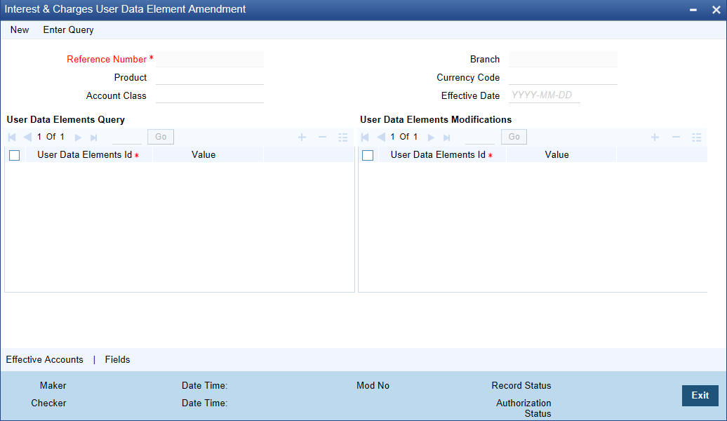

You can modify UDE values in the ‘User Defined Elements Values Maintenance’ Query screen. Invoke this screen from the Application Browser. You can invoke the ‘Profit & Charges User Data Element Amendment’ screen by typing ‘ICDUDEUL’ in the field at the top right corner of the Application tool bar and clicking the adjoining arrow button.
Reference Number
Reference number is auto generated by the system. First three characters represent current branch.
Branch
Current branch code for maintaining Profit and Charges User Defined Element Values is defaulted here.
The branch code is displayed based on the Common Branch Restrictions for ICRATES for your branch. The branches that are allowed for your home branch are displayed in the option list for Branch Code. This occurs only if ‘ICRATES’ has been maintained as a Restriction Type at the Common Branch Restrictions screen. If not, all Branch Codes are displayed including the ‘ALL’ option.
Product
Account Class
Currency
Effective Date
It is not necessary for you to indicate all the three conditions. For example, if you want to change the profit calculation parameters only for accounts belonging to a particular account class, specify only the account class.
Note
At the time of selecting the account class and currency, the system will display only the account classes and currencies associated with the profit product (only if you have specified a profit product).
You also need to specify the date from when the new values have to be effective.
In this section you can query for the UDE of your choice:
User Element
Select the user data element whose value has to be changed, from the adjoining option list. This list displays user data elements associated with the profit product.
User Element Value
Specify the value of the UDE that has to be changed.
Note
If you have not specified a profit product, UDE’s associated with all the profit products will be displayed.
In this section you can modify UDE of your choice:
User Element
Select the user data element which was selected at the User Data Element - Query section, from the adjoining option list. This list displays user data elements associated with the profit product.
User Element Value
Specify the new value for the specified UDE.
Note
To apply a different profit rate on the same set of accounts from 15th October 2001, you will have to maintain another record (with the same profit product-account class-currency combination) with the effective date as 15th October, 2001.

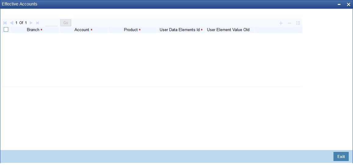

System will check all the customer accounts and displays the accounts that will be affected because of the change in the value of the profit calculation parameters. Click ‘Effected Accounts’ to view the accounts that have been affected.
The system will display a message if the new value of the profit calculation parameters has not affected any accounts.
