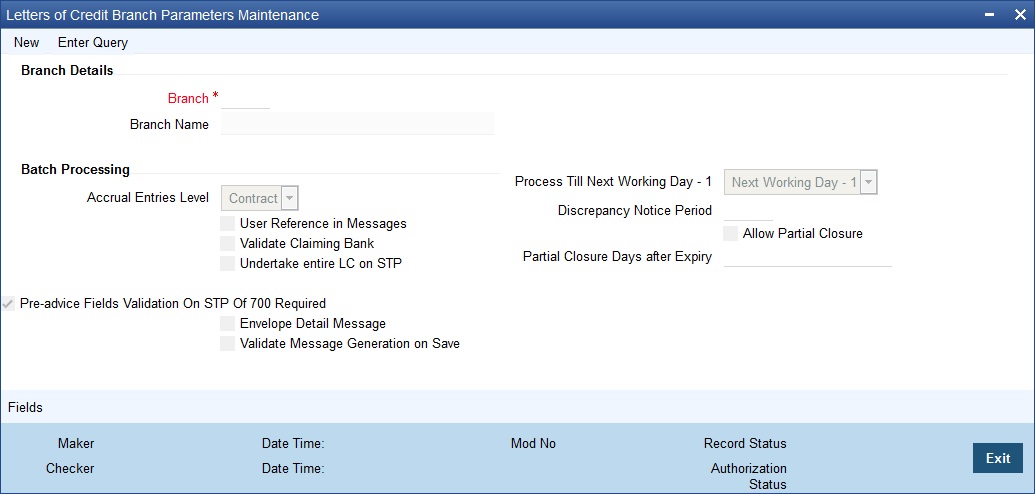

A set of rules that govern the LCs processed through the LC module, in a particular branch of your bank, is defined in the ‘Branch Parameters’ screen.
From the Application Browser, choose ‘Letters Of Credit’ and ‘Branch Parameters’ under it.
You can also invoke this screen by typing ‘LCDBRPRM’ in the field at the top right corner of the Application tool bar and clicking on the adjoining arrow button. Then, the ‘Letters of Credit - Branch Parameters’ screen will be displayed.
The events, for which you had indicated automatic processing, are triggered off during the Batch Process. You can specify preferences for the automatic events that fall on a holiday, in the Branch Parameters screen. In addition, you can also specify the level at which accrual entries should be passed, for LCs in your branch.
Specifying Preferences for the Automatic Processing of LCs
You have the option to specify, that the batch process should process automatic events falling due on a holiday should.
The same can be processed on either of the following ways:
If you indicate that the processing has to be done upto the Next Working Day - 1, all the automatic events falling due on the holiday will be processed by the batch process, as part of the EOD on the last working day, before the holiday.
If you indicate that processing has to be done only upto the System Date, then only the events scheduled for today (the last working day before the holiday) will be processed. The events falling due on the holiday are processed by the batch process, as part of the BOD process, the first working day after the holiday.
For example the current branch date is 20 March 1998. On 21 March 1998, which is a holiday, the following automatic events fall due:
Next working day - 1
If you specify that the processing should be done on the last working day - 1, the above events will be processed on March 20, as part of the batch process run at End of Day.
System date
If you specify that the processing should be done only upto the system date, then the events scheduled for 21 March 1998, will be processed as part of the Batch Process run as part of Beginning of Day on 22 March 1998.

Specifying the Level at which Accrual Entries should be Passed
At the time of creating a product, you have specified
An LC will inherit the accrual frequency defined for the product under which it is processed.
In the Branch Parameters screen, you indicate the level at which the accrual entries have to be passed. The level can be:
If you indicate that automatic accrual should be done at the product level, a single entry for all the LCs, for which commission was accrued automatically, will be passed. This helps reduce the time taken to pass individual entries. If you indicate that the automatic commission accrual process should pass accrual entries at the contract level, accrual entries will be passed for each LC for which commission was accrued automatically.
Specifying the Discrepancy Notice Period
Discrepancies are likely to be found while processing Incoming or Outgoing bills under LCs. You can specify a period within which the discrepancy details should be added to the bills. This period will be calculated from the date of presentation of the bills (which is typically the booking date of the bill) to the issuing bank/confirming bank.
The system will display an override if the discrepancies are added to the bills (in the ‘Bills – Contract Details’ screen) after the discrepancy notice period.
For details on processing a bills contract, refer the ‘Processing Bills’ chapter of the BC (Bills and Collections) User Manual.
Validate Message Generation on Save
Specify this option to indicate Validate Message generation on contract save.
If Validate Message Generation flag is checked:
If flag is unchecked:
Message generation validation during contract save for conventional screens will be provided to the following screens:
