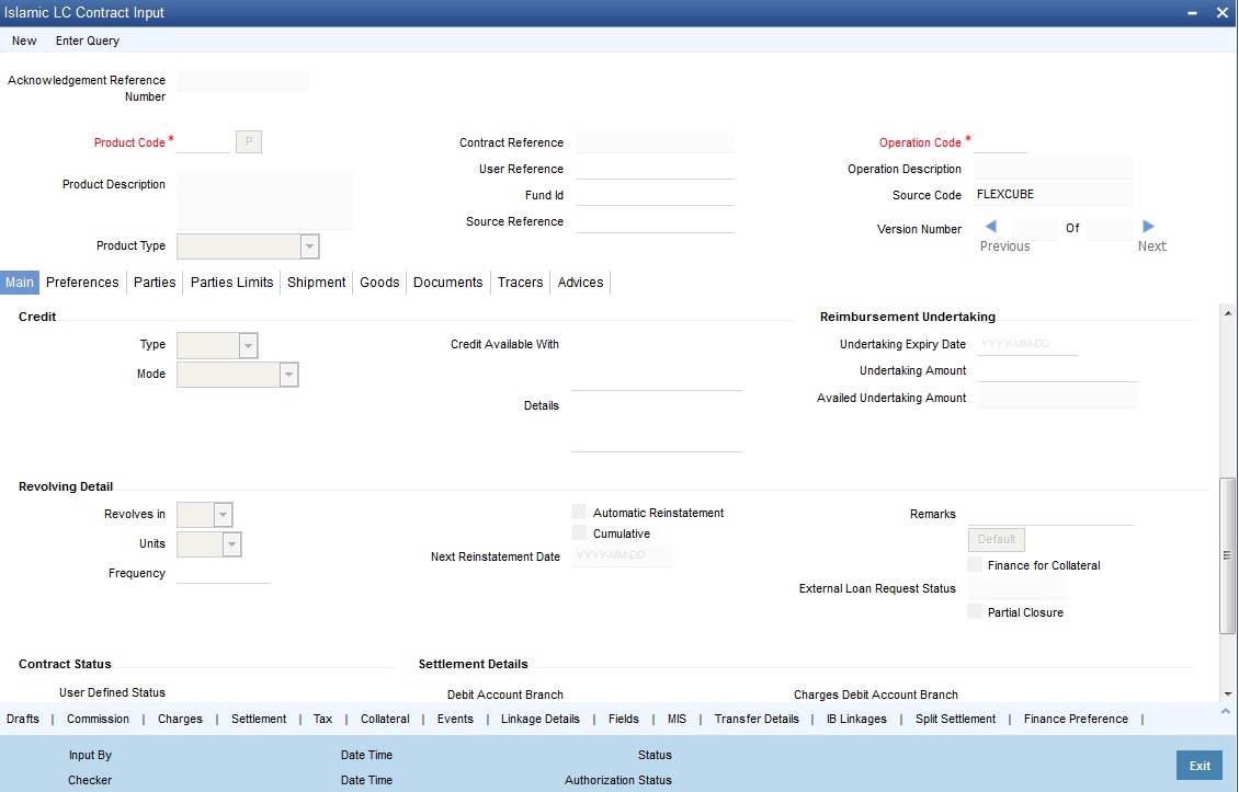

You can invoke ‘Islamic LC Contract Input’ screen by typing ‘LIDTRONL’ in the field at the top right corner of the Application tool bar and clicking the adjoining arrow button. Click ‘New’ icon in the application toolbar. The ‘Islamic LC Contract Input’ screen with no values in the fields is displayed.
If you are calling a contract that has already been created, click on Summary view. You can invoke ‘Islamic LC Contract Summary’ screen by typing ‘LISTRONL’ in the field at the top right corner of the Application tool bar and clicking the adjoining arrow button. You can open an existing contract by double clicking the contract.
You can enter the following details here:

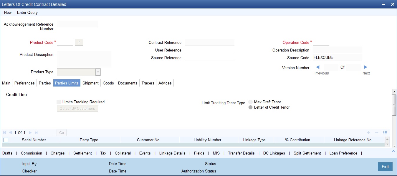

The Islamic LC Contract Details screen consists of a header and footer that contains fields specific to the contract being entered. Besides these, you will also notice six tabs and a horizontal array of icons along the lines of which you can enter details of the contract. Contract details are grouped into the various screens according to the similarities they share.
The Islamic LC Contract Screen contains six tabs along the lines of which you can enter details of the contract. The six tabs are:
Tabs |
Description |
Main |
Click this tab to enter the essential terms of the Islamic LC. This screen along with its fields has been detailed under the head Entering Main Contract Details. |
Preference |
Click this tab to set the preferences |
Parties |
In the screen that corresponds to this tab, you can enter the details of all parties involved in the Islamic LC. This screen along with its fields has been detailed under the head Entering Party Details. |
Parties Limit |
Click this tab to capture parties limit details |
Shipment |
In the screen that corresponds to this tab you can enter details of the documents required under an Islamic LC and the clauses that should accompany the documents. Besides, you can also specify a description of the merchandise traded under the Islamic LC and shipping instructions for the transportation of the merchandise. |

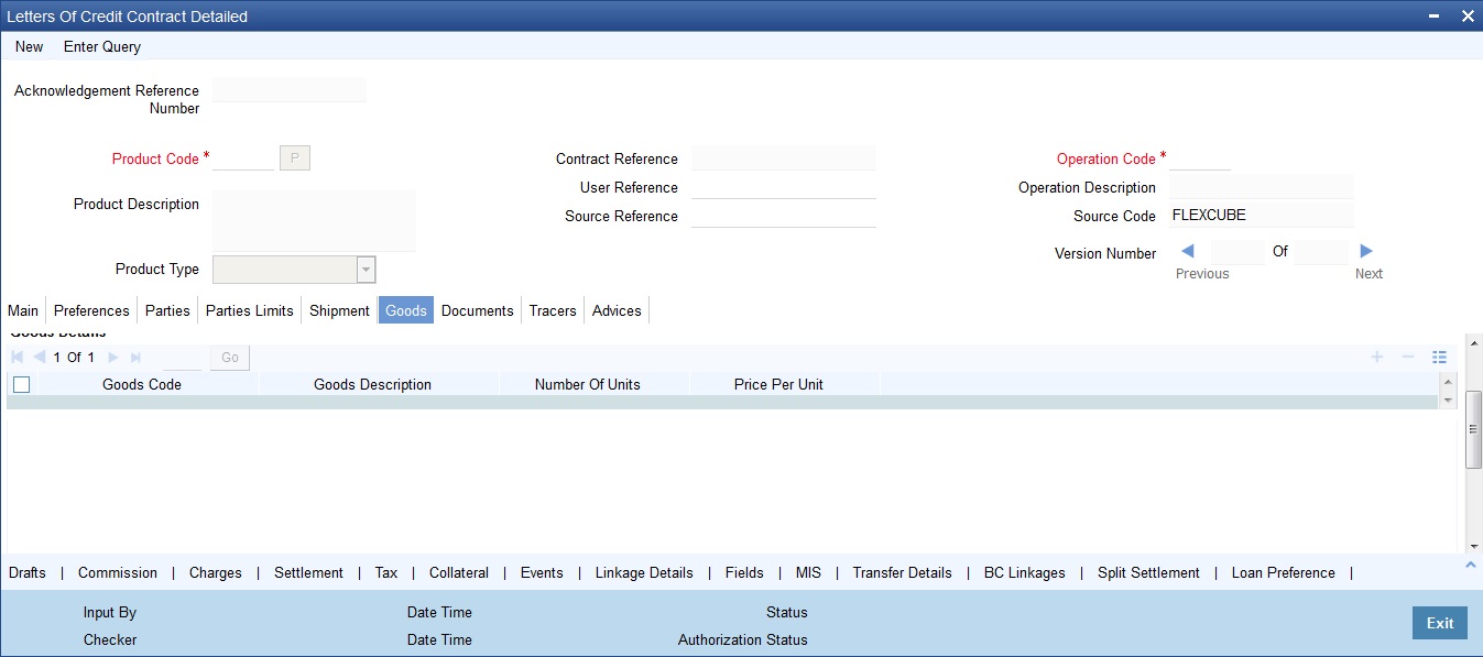

Goods |
Click this tab to capture the goods details |

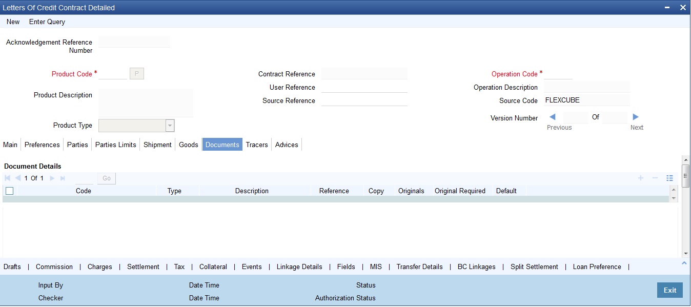

Documents |
Click this tab to capture the document details |
Tracers |
Click on this tab to enter details of the tracers that should be generated for an Islamic LC. |
Advices |
In the screen corresponding to this tab you can view, suppress and prioritize the advices that are to be generated for a contract. This screen along with its fields has been detailed under the head Specifying Advises for an Islamic LC. |
On the Contract Detailed screen are also displayed a horizontal toolbar. The buttons on this toolbar enable you to invoke a number of functions vital to the processing of an Islamic LC contract. These buttons have been briefly described below.
Buttons |
Description |
Drafts |
Click this button to capture the details of draft drawn for the LC. You can specify the name of the insurance company that is covering the goods traded under the LC. |
Commission |
On invoking this button Commission details of the contract are displayed |
Charges |
This button invokes the Charges and Fees service. On invoking this function you will be presented with a screen where the ICCF rate, amount, currency and the waive charge parameter can be specified. The Processing Charges and Fees manual, details the procedure for maintaining charge rules. It also deals with the linking of a charge rules to a product and the application of the rule on an Islamic LC. The Processing Commissions manual, details the procedure for maintaining commission rules. It also deals with the linking of a commission rule to a product and the application of the rule on an Islamic LC. |
Settlement |
Click this button to invoke the Settlement screens. Based on the details that you enter in the settlement screens the Islamic LC will be settled. The details of these screens have been discussed in the Settlements manual. |

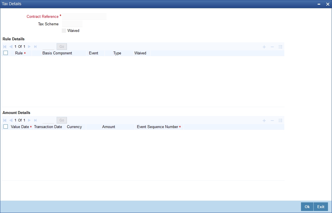

Tax |
This button invokes the Tax services. The Processing Tax manual details the procedure for maintaining tax rules and schemes. It also deals with the linking of a tax scheme to a product and the application of the scheme on an Islamic LC. |
Collateral |
In the screen that corresponds to this icon, you can specify details of the cash that you collect as collateral form a customer for the Islamic LC that you process. The details of this screen are discussed under the head Specifying Collateral details for an Islamic LC. |
Events |
Click this button to view the details of the events and accounting entries that a contract involves. |
Linkage Details |
Clicking this button invokes the Contract Linkages screen. In this screen, you can link an Islamic LC to a deposit or account, and indicate the funds that you would like to block. |
Fields |
Click this button to view the user-defined fields linked to the product. |
MIS |
Click this button to define MIS details for the Islamic LC. |
Transfer Details |
If the LC is transferred to a new party then a transaction will be populated here. You can only view the details. |
IB Linkages |
Click this button to specify IB linkages |
Split Settlement |
Click this button to specify split settlement details |
Finance Preference |
Click this button to invoke the ‘Finance Preference Screen’. You can enter the details of the finance. |
Brokerage |
Use this button to capture brokerage details for the Islamic LC contract and set your preferences for sharing the brokerage amount among multiple brokers. |
All Messages |
Click this button to view all messages associated to contract. |
Documents |
Click this button to capture the customer related documents in central content management repository. |
Deferred Profit Component |
Click this button view the components which are transferable to BC in Oracle FLEXCUBE |
Remarks |
Click this button to view ‘History of Remarks’ screen. |
Change Log |
Click this button to view the changes made to a particular version of an Islamic LC contract. |
Transferred Components |
Click this button to view the deferred components details screen. |
Insurance |
Click this button to capture insurance details for the LC. |
Common Message Group |
Click this button to invoke the common group message screen.

You can capture the following details.
Type
Indicate the type of credit for which the LC is being processed.
Mode
Indicate the mode of payment through which the LC will be settled.
If you indicate the LC type as sight in the LC Product Definition screen, then you can select the credit mode as:
If you indicate the LC type as Usance in the LC Product Definition screen, then you can choose the credit mode as:
These validations are applicable only if drafts information is maintained in the Drafts sub-system. These validations are applicable for both Import and Export LC products.
Credit Available With
Specify details of the party with whom the credit will be available.
Details
Specify the details of the credit.
You can capture the following details:
Undertaking Expiry Date
Specify the undertaking expiry date.
You can claim the reimbursement only till the undertaking expiry date, else, the system will display the following error message “The undertaking has been expired”.
Undertaking Amount
Specify the amount that can be reimbursed. It can be less than or equal to contract amount.
The system will default the Undertaking Amount value with the Max LC Amount initially when it is created through the incoming MT740. However you can amend this field by adding the undertaking amount.
Availed Undertaking Amount
The system displays the availed portion of undertaken amount.
Note
Revolves In
Islamic LCs can revolve in Time or in Value. Select the appropriate option from the adjoining drop-down list.
Automatic Reinstatement
The mode of reinstatement for a revolving Islamic LC can be either automatic or manual. Check against this field to indicate that the mode of reinstatement is automatic.
This field is applicable only for an Islamic LC revolving in time.
Cumulative
Check this box to indicate that the Islamic LC is cumulative. Leave it unchecked to indicate otherwise.
Frequency
For Islamic LCs that revolve in value, you can specify the maximum number of times the Islamic LC can be reinstated. Based on the value you specify, the Islamic LC Liability Amount will be computed and displayed.
If the number of reinstatements of the Islamic LC exceeds the value you specify, an override message will be displayed when the Islamic LC is saved. This override will have to be ratified at the time of contract authorization.
Units
For Islamic LCs, which revolve in time, the maximum number of reinstatements is calculated based on the Reinstatement Frequency you specify. In the Units field, you can choose one of the following:
Next Reinstatement Date
The system computes and displays the date of next reinstatement based on the value in ‘Units’ field.
Remarks
You can specify remarks here if any.
Finance for Collateral
Check this box if finance for collateral is applicable.
Partial Closure
Check this box to perform partial closure of Islamic LC manually.
You can check this box during the following conditions:
On saving the amendment after checking this option, PCLS event takes place. The Limits, Outstanding Liability and the Cash Collateral are released to the extent of unutilized amount.
Once PCLS event is fired for an Islamic LC contract, system does not allow any operation on the Islamic LC other than LC Closure (CLOS). You can reopen the closed Islamic LC as existing. While reopening the Islamic LCs for which PCLS is fired earlier, the Limits are tracked, OS Liability and Cash collateral is increased to the extent of the amount released as part of PCLS.
After PCLS event takes place on the Islamic LC contract, if the Bill contract to which the Islamic LC is linked is reversed, the corresponding availment of Islamic LC is reversed and the Limits, OS Liability and the Cash Collaterals are updated. The linkages to the Islamic LC are not released automatically as part of PCLS firing during batch. You have to manually release as part of manual partial closure. The above processes are skipped for the Islamic LC contracts under the product for which the ‘Revolving’ option is indicated as ‘Yes’.
The system allows manual partial closure during the partial closure days, until the Islamic LC is closed.
In case of a partially confirmed export Islamic LC contract, the system excludes the bill amount in the initial stage from the confirmed and unconfirmed portions.
Specify the following details:
User Defined Status
Specify the status of the Islamic LC contract. The option list displays all valid statuses that are applicable. Choose the appropriate one.
At the branch level, if you have enabled group level status change for the Islamic LC, the system displays the status of the group with which the Islamic LC is associated. However, you can unlock and modify the statuses of individual contracts. Thus, you can use this field for changing the status of an Islamic LC contract manually.
Derived Status
The system displays the derived status of the Islamic LC contract. You cannot modify this.
Sanction Check Status
The system displays the sanction check status once the sanction check is performed. The system displays any of the following statuses:
Last Sanction Check Date
The system displays the last sanction check date.

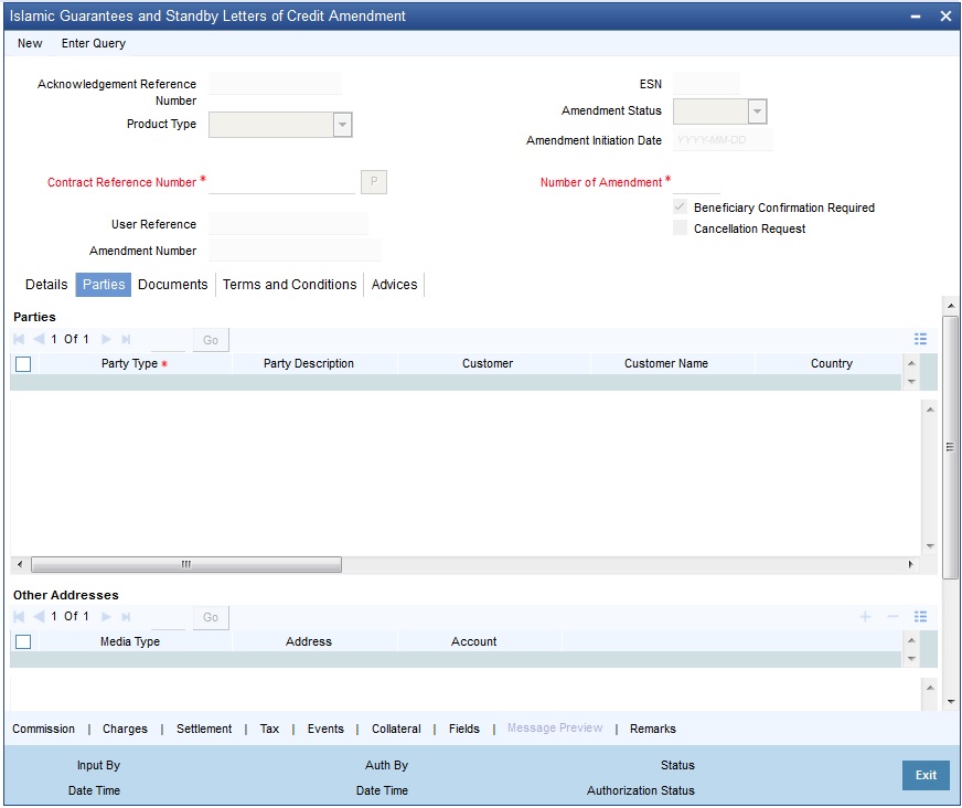

The Parties screen can be used to record the details related to all the parties involved in the Islamic LC. The documents, tracers and messages that are generated will be sent to the parties concerned, based on the details you specify in this screen.
You can maintain the following details here:
You should specify the following for each of the parties involved in the Islamic LC:
Party Type
The party type (beneficiary, accountee, applicant, advising bank, issuing bank, reimbursing bank, advice through bank, confirming bank).
Party Description
You can provide the description for the party type here.
Party ID
Specify a ‘Party ID’ for which you need to maintain. Alternatively, you can select the ‘Customer No’ from the adjoining option list also.
Note
BIC Code appears next to the 'Customer No' only if the BIC code is mapped with that customer number.If the BIC Code is not mapped with that Customer Number, then the BIC Code will not appear next to the ‘Customer No’ in the adjoining option list.

Oracle FLEXCUBE allows you to track the credit limits for joint venture customers who are parties to an Islamic LC contract. Using ‘Parties Limits’ tab, you can track the limits of multiple credit lines in an Islamic LC contract. Click ‘Parties Limit’ tab on ‘Islamic LC Contract Details’.
Limits Tracking Required
Check this box to indicate that limit tracking is required for the parties to the Islamic LC contract. If you check this box, the system will let you set the limits for multiple credit lines in the contract. If you do not check this box, the system will not track the parties’ limits.
On checking this box, the system enables ‘Default’ button. You can use this button to get the default values for the parties in the credit lines.
Limit Tracking Tenor Type
Choose the limit tracking tenor type from the following options:
Party Type
Specify the type of the party whose credit limits need to be tracked.
If you click ‘Default’ button, in the first row, the system defaults the joint venture party type based on the joint venture party selected under ‘Parties’ tab of ‘Islamic LC Contract Details’ screen. However, you need to make sure that the mandatory party details have been maintained under ‘Parties’ tab of the screen.
When you add another row to the list, you can manually select the party type as required. If you leave it blank, the system will automatically update the party type when you save the contract.
Customer No
Specify the customer number of the party whose credit limits need to be tracked. The option list displays the customer numbers of all the parties selected under ‘Parties’ tab..Specify the ‘Customer No’ for which you need to maintain. Alternatively, you can select ‘Customer No’ from the adjoining option list also.
Note
BIC Code appears next to the 'Customer No’ only if the BIC code is mapped with that customer number. If the BIC Code is not mapped with that Customer Number, then the BIC Code will not appear next to the ‘Customer No’ in the adjoining option list.
You need to make sure that the customer number corresponds to the party type selected above. If the customer number and party type do not match, the system displays an error.
JV Parent
When you click ‘Default’ button, the system defaults the joint venture customer number of the party. This customer number is defaulted based on the details maintained in ‘Joint Venture’ sub-screen of ‘Customer Maintenance’ screen.
Liability Number
When you click ‘Default’ button, the system defaults the liability number from ‘Joint Venture’ sub-screen of ’Customer Maintenance’ screen.
Linkage Type
Specify the linkage type. The drop-down list displays the following options:
Linkage Reference No
Specify the reference number that identifies the facility, collateral pool or collateral. The option list displays all valid facilities and collateral pools specific to the liability. Choose the appropriate one.
In case you choose the same linkage reference for more than one record in the list, the system displays an override message. You may choose to cancel or proceed with the selection.
% Contribution
Specify the proportion of limits to be tracked for the credit line or collateral pool for the joint venture customer. When you click ‘Default’ button, the system defaults the percentage of contribution maintained under ‘Joint Venture’ sub-screen of ‘Customer Maintenance’ screen.
It is mandatory to indicate the percentage of contribution if the party is a customer under joint venture. This is not applicable to customers who are not a part of joint venture.
Note
For one joint venture, the total percentage of contribution in all applicable credit lines together cannot be more than 100%.
Amount Tag
Specify the amount tag. The system tracks the limits for non joint venture customers based on the amount tag. The amount tags applicable to export and import Islamic LC contracts are listed below:
Amount tags applicable to Export Islamic LC:
Amount tags applicable to Import Islamic LC:
Choose the appropriate one based on the type of Islamic LC contract. If you do not specify the amount tag, the system will track the limits based on the liability amount and facility.
In ‘Parties Limit’ tab choose ‘Liability Minus Margin’ from the ‘Amount Tag’ the ‘Limit Amount’is computed as ‘Current Liability Amount’ minus the ‘Margin Amount’
In ‘Parties Limit’ tab choose ‘Silent Confirmation Amount’ from the ‘Amount Tag’ the amount computed will be ‘Silent Confirmation Amount’ which is the Liability Outstanding Amount. For joint venture customers, you need to choose ‘Liability Amount’ as the amount tag. Other amount tags are not applicable to joint venture customers.
The system verifies the amount tag against the product type. If you choose an amount tag, which is not supported by the product type, the system displays an error message.
Amount
When you click ‘Default’ button, the system defaults the amount tracked for each credit line. In case of joint venture customers, the amount is derived on the basis of the percentage of liability amount. In case of other customers, the amount is derived based on the amount tag specified above.
You can add more rows to the list of credit lines using add button. Similarly, you can remove a selected row from the list using delete button.
Once you have specified the details, save the contract. In case the limit for a credit line has been completely exhausted, the system displays a configurable override message. If you have not used ‘Default’ button while specifying the parties’ limit details, the system will automatically default the details and track the limits based on that.

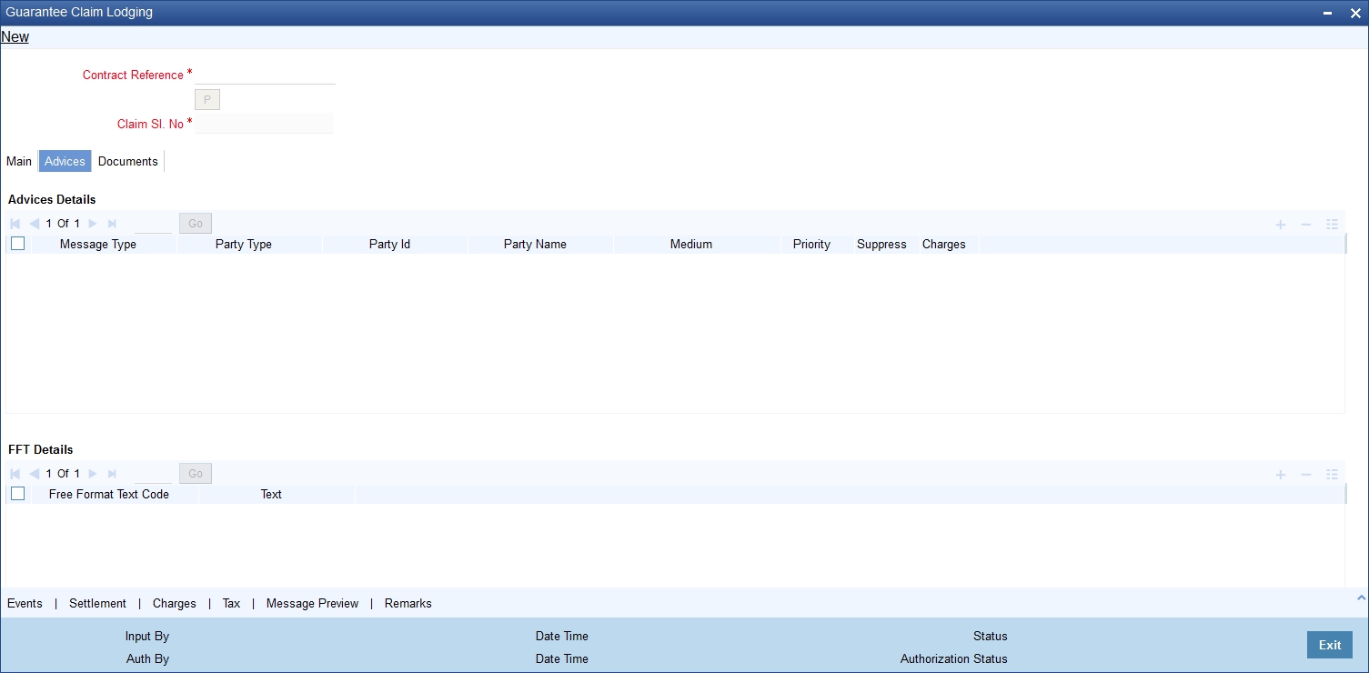

The details of the advices for an event are displayed in the Advices screen. The party type to whom a specific advice should be sent is picked up automatically based on the type of Islamic LC being processed and the parties involved.
From the ‘Islamic LC Contract Details’ screen click on the ‘Advices’ tab. The advices screen is displayed. The advices defined for the event you are processing will be displayed. You can choose to suppress any of them. The address of the party to whom the advice is addressed to will be picked up by default, based on the media and address maintenance for the party.
These can be changed if required. For a payment message by SWIFT, you also have the option to change the priority of the message.
Suppress
By default, all the advices that have been defined for a product will be generated for the Islamic LCs involving it. If any of the advices are not applicable to the Islamic LC you are processing, you can suppress its generation by Checking against the suppress field.
Priority
For a payment message by SWIFT, you also have the option to change the priority of the message. By default, the priority of all advices is marked as Normal.
The priority of a payment message can be changed to one of the following:
Medium
The medium by which an advice will be transmitted and the corresponding address will be picked up based on the media and address maintenance for a customer.
You can, however, change either of these while processing the Islamic LC. Typically, if changed, both of them will be changed.
After selecting the advices to be generated for the Islamic LC, click on ‘Ok’ button to save it. Click on ‘Delete’ button to reject the inputs you have made. In either case, you will be taken to the Contract Main screen.

You can also specify Preferences for the shipment of goods in the ‘Goods ‘tab. Click ‘Goods’ tab to specify details of the goods and captures unit and price of the goods. The ‘Goods’ tab maintains multiple goods details
The fields are maintained as follows:
Goods Code
Select the Goods code from the list provided.
Goods Description
The system displays the description of the Goods.
Number of Units
The system displays the number of units.
Price Per Unit
The system displays the price per unit.
You can specify the documents that should accompany the goods in the ‘Documents’ tab. Click ‘Documents’ tab to specify details documents and clauses that are part of the Islamic LC instrument.
You can specify the following details:
There are some standard documents required under a documentary Islamic LC. In this screen you can specify the documents that are required under the Islamic LC being processed. These details will be a part of the Islamic LC instrument sent to the advising bank, the advice through bank or the beneficiary. All the documents specified for the product to which the Islamic LC is linked will be defaulted to this screen.
Code
Enter the document code.
Type
Enter the document type.
Description
Enter the document description of the document that is defaulted to suit the LC you are processing. This field will be enabled only if the LC type is ‘Shipping Guarantee’, but not mandatory.
During copy operation, the value of this field will not be copied to the new contract.
Reference
Enter the document reference number based on which the Shipping Guarantee issued.
Copy
Enter the number of copies of the document.
Originals
Enter the number of Original documents here.
Original Required
Enter the receipt details here.
You can add to or delete from the list of documents that are defaulted. To add a document for the Islamic LC, click on add button and then on option list positioned next to the Document Code field. Select the code of the appropriate document from the list of document codes maintained in the Documents Maintenance screen. The other details of the document will be defaulted to this screen.
To delete a document that is not required for the Islamic LC, highlight the document code and click on the delete button on the screen.
Specifying the Document Reference
For Shipping Guarantee type of Islamic LCs, you can specify the document reference based on which the Shipping Guarantee is issued in the ‘Doc reference’ field. This field will be enabled only if the Islamic LC type is ‘Shipping Guarantee’. However it is not mandatory to enter the document reference for ‘Shipping Guarantee’ contracts. Documents captured for a shipping guarantee contract, can exist with or without document reference.
In addition to the other details, the clauses specified for a document while defining the product, are also defaulted to this screen.
When you highlight a document code, all the clauses defined for the document are displayed in the Clauses window. You can add to or delete from, the list of clauses that are defaulted.
To add a clause to a document for the Islamic LC, click on the add button. Then, click on option list positioned next to the Clause Code field. Select the code of the applicable clause from the list of clause codes maintained, in the ‘Clause Maintenance’ screen. The description of the clause will be defaulted, based on the clause code that you select.
To delete a clause that is not required for the Islamic LC, highlight the Clause code and click on the delete button.

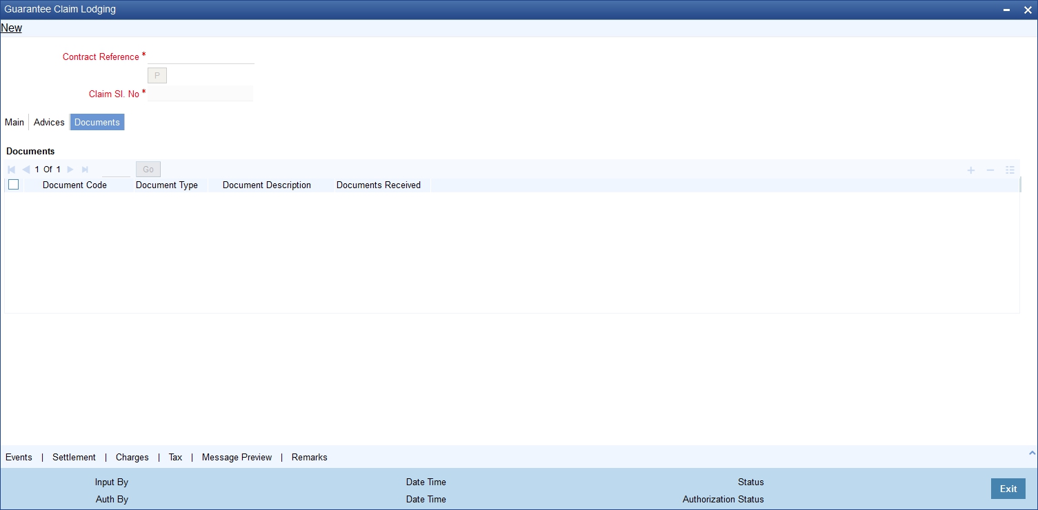

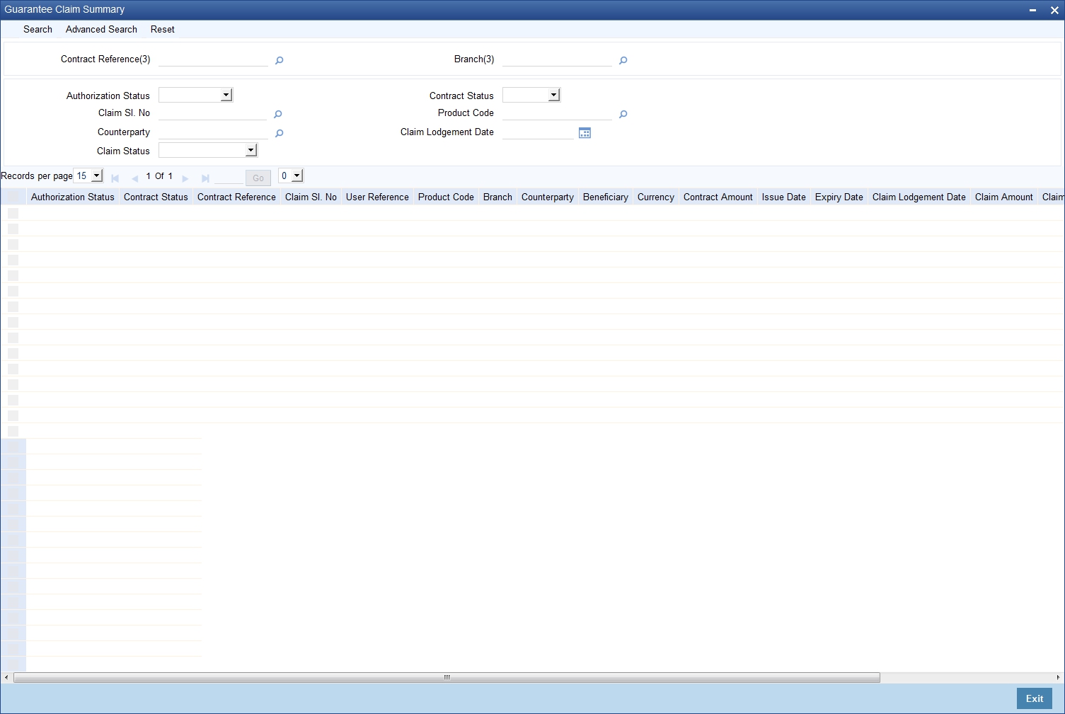

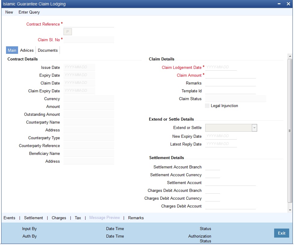

You can lodge claim on guarantee contract through ‘Islamic Guarantee Claim Lodging’ screen. You can invoke this screen by typing ‘LIDGCLM’ in the field at the top right corner of the Application tool bar and clicking the adjoining arrow button.
You can specify the following here:
Contract Reference
Select the guarantee contract reference number from the adjoining option list.
Claim Sl. No
The system displays the claim serial number.
The system displays the following contract details:
Claim Lodgement Date
Select the date on which claim is lodged.
Claims have to be lodged on or before Guarantee Claim Date. If claims are lodged after the Guarantee Claim date, system displays a configurable override error message.
Claim Date
The claim date should not be greater than the expiry date and the current business date of the system.
Note
If multiple claims are lodged against a contract and the claim date is same for all claims, then the system displays an override message.
Claim Amount
Specify the amount of the claim.
The claim amount should not be greater than the guarantee amount and the outstanding guarantee amount.
Claim Status
The status of the claim is displayed here. The statuses are as follows:
Legal Injunction
Check this box to indicate that there is a legal injunction received against the claim, to be captured during Claim Amendment.
Note
System triggers GCAM event and Claim Status is updated as 'Injunction Received'
Remarks
Specify remarks, if any.
Template Id
Select the template ID from the adjoining option list.Template ID is applicable only when the party type is applicant bank or issuing bank.
Note
The claim message is generated only if the template is selected.
Extend or Settle
Select the option from the drop-down list. The list displays the following options:
New Expiry Date
Specify the new expiry date. The New Expiry date is mandatory when 'Query to Extend or Settle’ option is selected.
Latest Reply Date
Specify the latest reply date. The Latest Reply date is mandatory when 'Query to Extend or Settle option is selected.

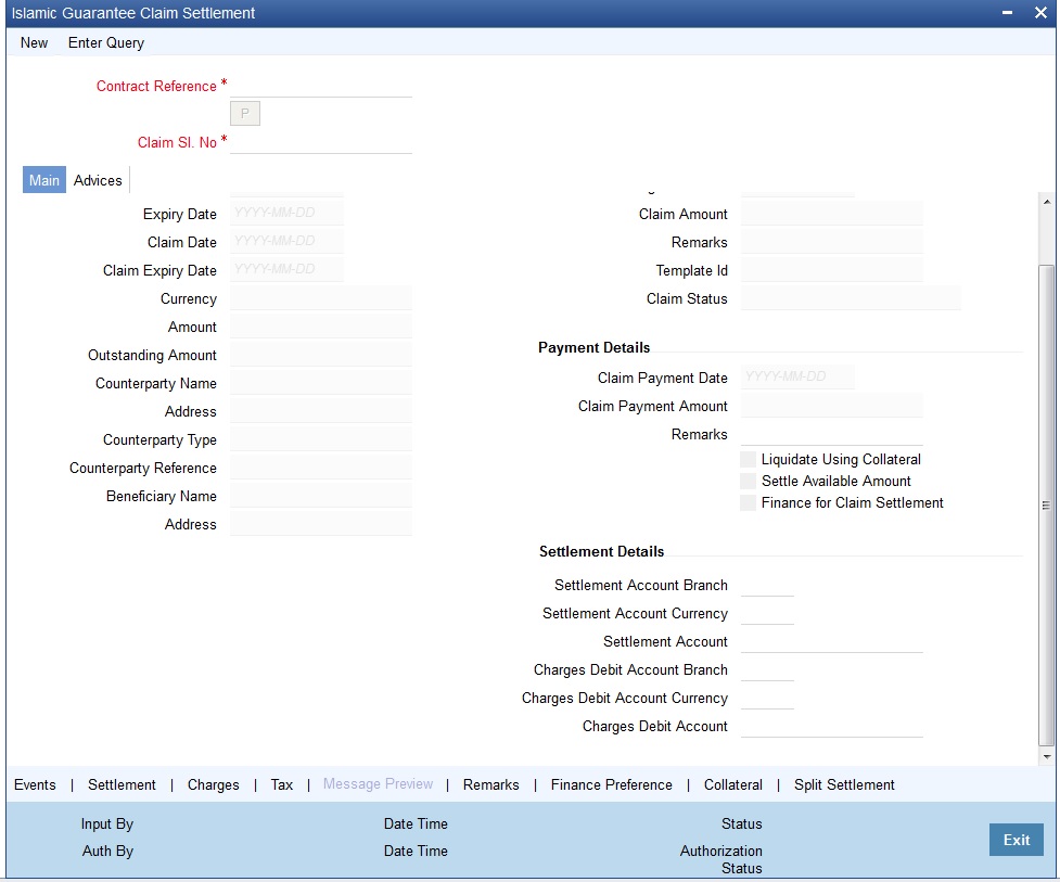

You can set the following settlement details:
Settlement Account Branch
The system displays the settlement account branch on selection of the debit account number.
Settlement Account Currency
The system displays the settlement account currency on selection of the debit account number.
Settlement Account
The system displays the settlement account details.
Charges Debit Account Branch
The system displays the charges debit account branch on selection of the charges debit account number.
Charges Debit Account Currency
The system displays the charges debit account currency on selection of the charges debit account number.
The system displays the charge debit account details.
Click on the ‘Advices’ tab to capture the advice details.
Message Type
The system displays the message type of the advice generated.
Party Type
The system displays the party type for which the message is generated.
Party Id
The system displays the party ID for which the message is generated.
Party Name
The system displays the name of the party for which the advice is generated.
Medium
Select the medium through which the message has to be sent from the adjoining option list.
Priority
Select the priority of sending message from the adjoining drop-down list.
Suppress
Check this box to suppress the message.
Charges
The system displays the charges configured.
Free Format Text Code
Select the free format text code from the adjoining option list.
Text
The system displays a brief description on free format text.
Click on “Documents” tab to capture document details.
Documents captured during Guarantee Issuance are defaulted when claim is lodged
Document Code
The code of the document captured during guarantee issuance is defaulted here.
Document Type
The type of document captured during guarantee issuance is defaulted here.
Document Description
The description of the document is defaulted here.
Documents Received
Check this box to indicate that documents are received.
Click on ‘Event’ link of the ‘Islamic Guarantee Claim Lodging’ screen to view the event details.
The system displays the events, accounting entries and advices here.
Click on ‘Settlement’ link of the ‘Islamic Guarantee Claim Lodging’ screen to view the settlement details.
The system displays the settlement information for charges here.
Click on ‘Charges’ link of the ‘Islamic Guarantee Claim Lodging’ screen to view the charge details.
The system displays the charges configured for the event at product definition here.
For more details on the Charges Details screen, refer section ‘Contract Charge Details’ in Charges and Fees User Guide under Modularity.
Click on ‘Tax’ link of the ‘Islamic Guarantee Claim Lodging’ screen to view the tax details.
The system displays the details of the tax configured in the screen.
Click on ‘Preview Message’ link of the ‘Islamic Guarantee Claim Lodging’ screen to view the message details.
You can view the message or advice generated in the screen.
For more details on this screen, refer Capturing Additional Details chapter in this user manual.
Click Remarks button to view all the instructions captured on every transaction of the contract in ‘History of Remarks’ screen.
For more details on this screen refer to the section ‘Remarks ‘in this user manual.

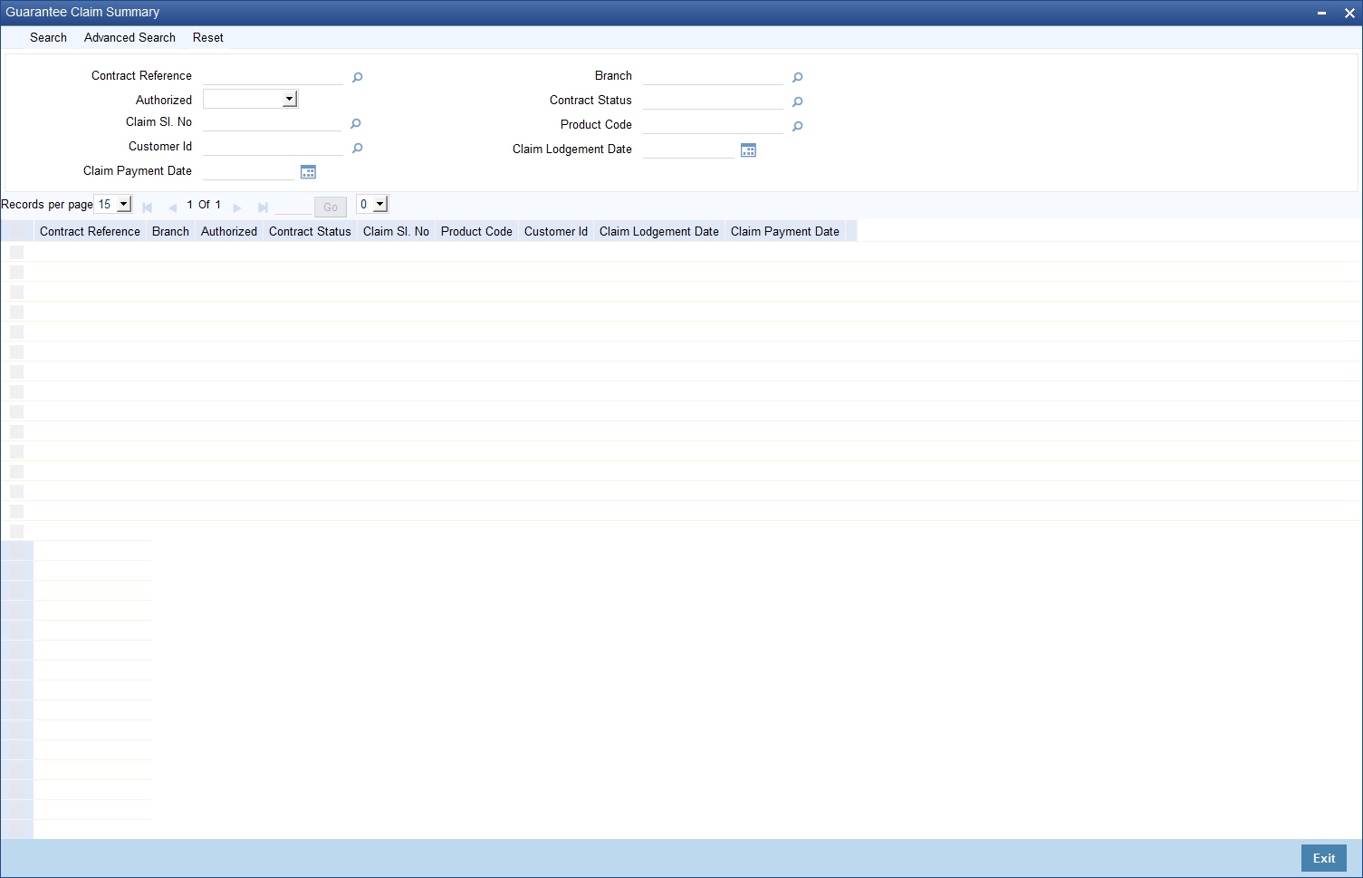

You can view the guarantee claim details maintained in the ‘Islamic Guarantee Claim Lodging’ screen using the ‘Islamic Guarantee Claim Summary’ screen. You can invoke this screen by typing ‘LISGCLM’ in the field at the top right corner of the Application tool bar and clicking on the adjoining arrow button.
In the above screen, you can base your queries on any or all of the following parameters and fetch records:
Select any or all of the above parameters for a query and click ‘Search’ button. The system displays the following records meeting the selected criteria:

You can settle guarantee claims using the ‘Guarantee Claim Settlement’ screen. Claims have to be settled in the sequence it is lodged. All claims in Lodged Status will be available for settlement.
You can invoke the ‘Guarantee Claim Settlement’ screen by typing ‘LIDGCLP’ in the field at the top right corner of the Application tool bar and clicking the adjoining arrow button. Click New icon.
The following details are captured here:
Contract Reference
Specify the Guarantee contract Reference against which the claim is received by the bank and settlement needs to be done. Alternatively you can also select the contract reference from the drop-down list. The list displays only claims for which the status is ‘Lodged’.
Claim Serial No
Specify the claim serial no. for which settlement needs to be done.System validates that the entered unsettled claim is as per the sequential order of lodgement and status of the claim is ‘Lodged’.
Issue Date
System defaults the contract issue date here.
Expiry Date
System defaults the contract expiry date here.
Claim Date
System defaults the guarantee claim date here.
Claim Expiry Date
System defaults the guarantee claim expiry date here.
Currency
System defaults the guarantee currency here.
Amount
System defaults the guarantee amount here.
Outstanding Guarantee Amount
System defaults the outstanding guarantee amount here.
Counterparty Name
System defaults the name of the counterparty here.
Address
System defaults the address of the counterparty here.
Counterparty Type
System defaults the party type of the counterparty here.
Counterparty Reference
System defaults the reference no. of the counterparty here.
Beneficiary Name
System defaults the name of the beneficiary here.
Address
System defaults the address of the beneficiary here.
System defaults the date of claim lodged.
Claim Amount
System defaults the claim payment amount as claim amount.
Remarks
Enter remarks if any for the claim.
Template ID
System defaults the template id of the claim lodged.
Claim Status
System defaults the status of the claim lodged.
Liquidate Using Collateral:
Check this box to indicate if the collateral need s to be utilized for the settlement of the claim.
Claim Payment Amount
System defaults the claim payment amount here.
Remarks
Enter remarks if any for claim payment.
Settle Available Amount
Check this option to debit the available amount from applicant and then create loan for the remaining amount during claim settlement. Settle Available Amount can be selected only when you select the Loan for Claim Settlement, else the system will validate the same.
Collateral Funding By Loan:
Check this box to indicate if collateral needs to be utilised for claim settlement.
Claim Payment Date
System defaults the claim payment date here.
Remarks
Finance for Claim Settlement
System defaults the value maintained at product level. You can check/un-check this box to indicate that finance needs to be created or not for this claim settlement.
The system defaults the details of settlement account branch. The values can be modified.
The system defaults the details of settlement account currency. The values can be modified.
Settlement Account
The system defaults the settlement account. The values can be modified.
The system defaults the details of charges debit account branch.The values can be modified.
The system defaults the details of charges debit account currency. The values can be modified.
The system defaults the details of charges debit account. The values can be modified.Advices Tab
