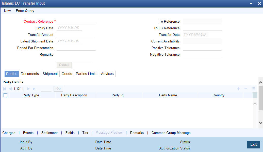

You can transfer funds from an Islamic LC using the ‘Islamic LC – Transfer Input’ screen. You can invoke this screen by typing ‘ LIDTRANF’ in the field at the top right corner of the Application tool bar and clicking the adjoining arrow button.
Indicate the Islamic LC from which you want to effect the transfer. Select a valid Islamic LC Reference from the option list. The manner in which Oracle FLEXCUBE handles a transfer is different for import and export Islamic LCs.
Refer to the title ‘A note on transfers made from Import and Export Islamic LCs’ for more details.
Transfer Amount
The transfer amount is the amount that should be transferred from the original Islamic LC. You can only transfer an amount that is less than or equal to the amount available under the original Islamic LC.
Expiry Date
The expiry date is the date upto which the transferred Islamic LC is valid. The expiry date of the original Islamic LC is defaulted. You can change the defaulted date. However, the expiry date cannot be earlier than the Islamic LC issue date or today's date.

The shipment date is the latest date by which the shipment of the goods specified for the transferred Islamic LC should take place. The latest shipment date of the original Islamic LC is defaulted. You can change the defaulted date. However, the date you enter should not be earlier than the Issue Date of the Islamic LC and later than the expiry date.

Period For Presentation
The period of presentation defined for the product - or calculated for the LC, as the case may be - will be displayed. You can change the default to suit the LC you are processing.
Remarks
Specify remarks if any.
To Ref No
Specify the reference number to which the LC should be transferred.
To User Ref No
Specify the user reference number to which the LC should be transferred.
Transfer Date
Specify the date of transfer.
LC Available Amount
The amount available on the chosen LC is displayed here.

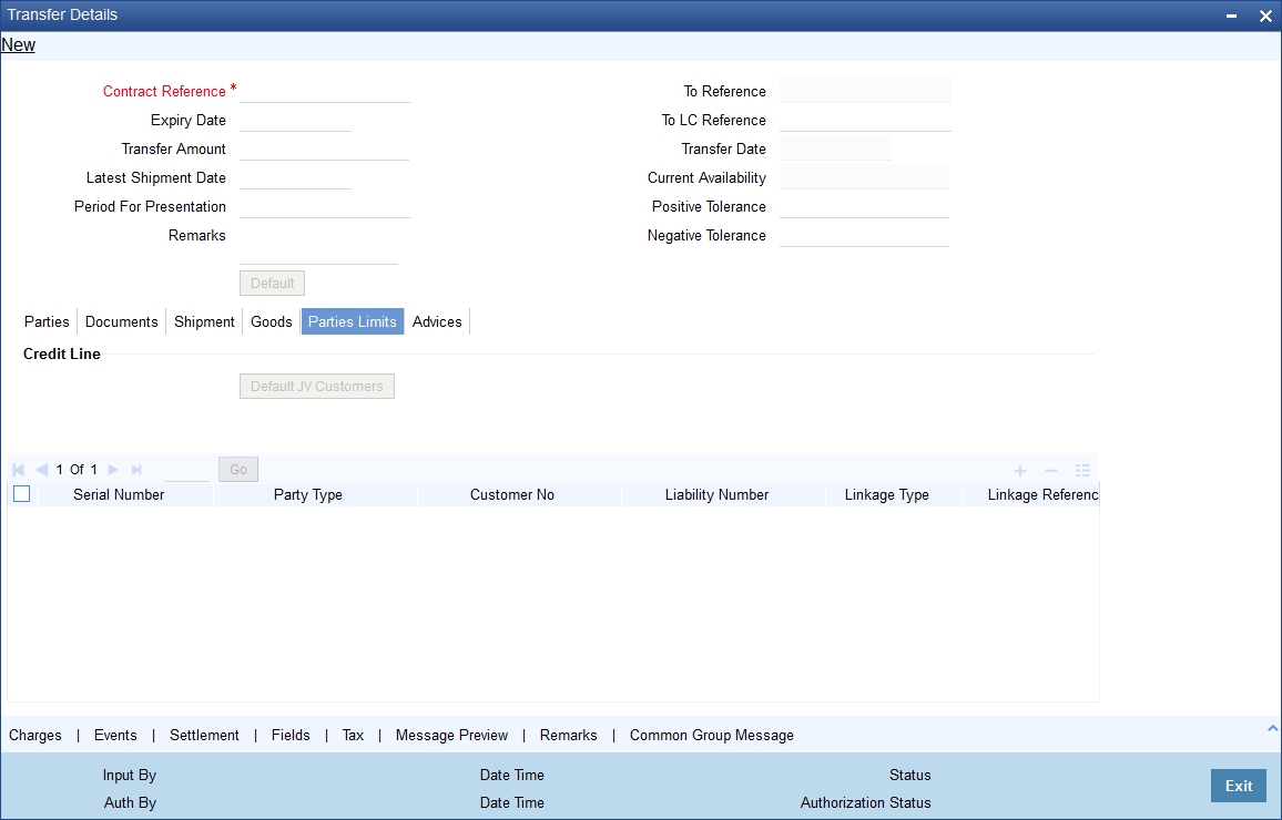

You can track the limits of multiple credit lines while transferring an Islamic LC contract. Click ‘Parties Limit’ tab on ‘Islamic Letters of Credit Transfer Input’ screen.
Specify the following details:
Party Type
Specify the type of the party whose credit limits need to be tracked.
If you click ‘Default’ button, in the first row, the system defaults the party type based on the details maintained under ‘Parties’ tab of the screen. However, you need to make sure that the mandatory party details have been maintained under ‘Parties’ tab of the screen.
When you add another row to the list, you can manually select the party type as required. If you leave it blank, the system will automatically update the party type when you save the transfer details.
Customer No
Specify the customer number of the party whose credit limits need to be tracked. The option list displays the customer numbers of all the parties selected under ‘Parties’ tab. Choose the appropriate one.
Specify the ‘Customer No’ for which you need to maintain specific parameters. Alternatively, you can select ‘Customer Id’ from the adjoining option list also.
Note
BIC Code appears for a ‘Customer Id’ only if the BIC Code is mapped to that ‘Customer Id’.If the BIC code is not mapped to that ‘Customer Id’ then the BIC Code will not appear next to the ‘Customer Id’ in the adjoining list.
JV Parent
When you click ‘Default’ button, the system defaults the joint venture customer number of the party. This customer number is defaulted based on the details maintained in ‘Joint Venture’ sub-screen of ‘Customer Maintenance’ screen.
Liability Number
When you click ‘Default’ button, the system defaults the liability number from ‘Joint Venture’ sub-screen of ’Customer Maintenance’ screen.
Linkage Type
Specify the linkage type. The drop-down list displays the following options:
Linkage Reference No
Specify the reference number that identifies the facility or collateral pool. The option list displays all valid facilities and collateral pools specific to the liability. Choose the appropriate one.
In case you choose the same linkage reference for more than one record in the list, the system displays an override message. You may choose to cancel or proceed with the selection.
% Contribution
Specify the proportion of limits to be tracked for the credit line or collateral pool for the joint venture customer. When you click ‘Default’ button, the system defaults the percentage of contribution maintained under ‘Joint Venture’ sub-screen of ‘Customer Maintenance’ screen.
It is mandatory to indicate the percentage of contribution if the party is a customer under joint venture. This is not applicable to customers who are not a part of joint venture.
Note
For one joint venture, the total percentage of contribution in all applicable credit lines together cannot be more than 100%.
Amount Tag
Specify the amount tag. The system tracks the limits for non joint venture customers based on the amount tag. The amount tags applicable to Islamic export and import LC contracts are listed below:
Amount tags applicable to Islamic Export LC:
Amount tags applicable to Islamic Import LC:
Choose the appropriate one based on the type of Islamic LC contract. If you do not specify the amount tag, the system will track the limits based on the liability amount and facility.
The system verifies the amount tag against the product type. If you choose an amount tag, which is not supported by the product type, the system displays an error message.
Amount
When you click ‘Default’ button, the system defaults the amount tracked for each credit line. In case of joint venture customers, the amount is derived on the basis of the percentage of liability amount. In case of other customers, the amount is derived based on the amount tag specified above.

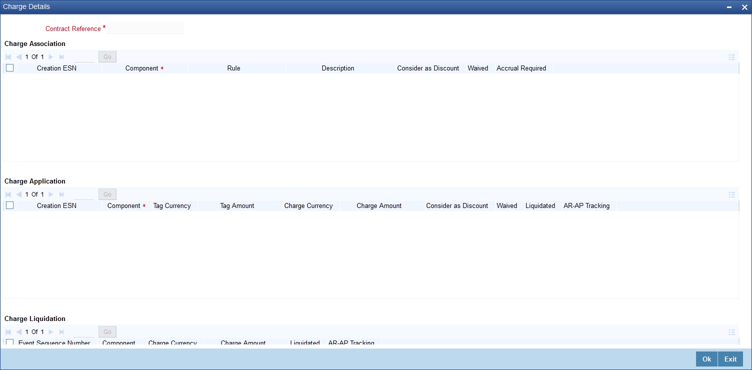

Click ‘Charges’ button to invoke the following screen
Refer the Charges and Fees User Manual under Modularity for further details about this screen.

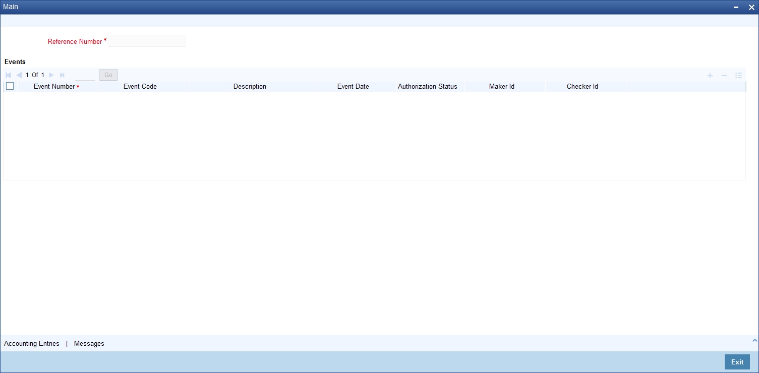

Click this button to view the details of the events and accounting entries that a contract involves.
Click ‘Accounting Entries’ to view the accounting entries for the event that is highlighted. Click ‘Message’ to view the messages applicable to the event. Click on ‘Exit’ or ‘Cancel’ to go back to the ‘Islamic LC Transfer Input’ screen.

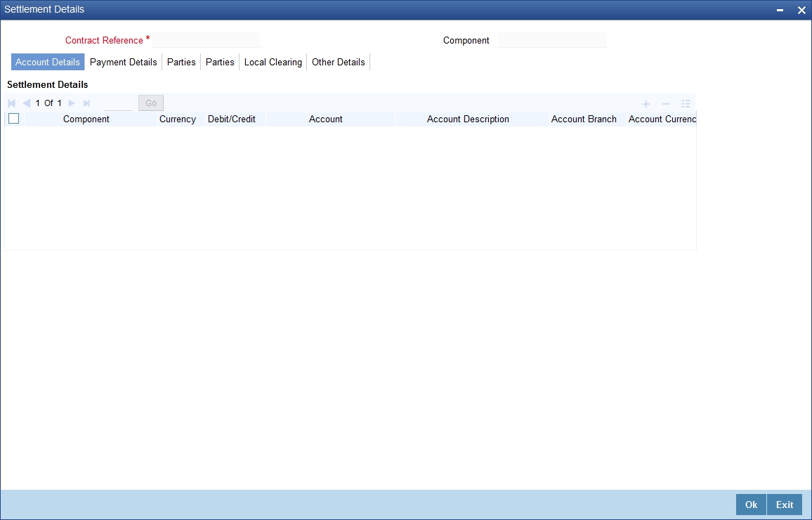

Click this button to invoke the Settlement screen. Based on the details that you enter in the settlement screens the Islamic LC will be settled.
The details of these screens have been discussed in the Settlements user manual.

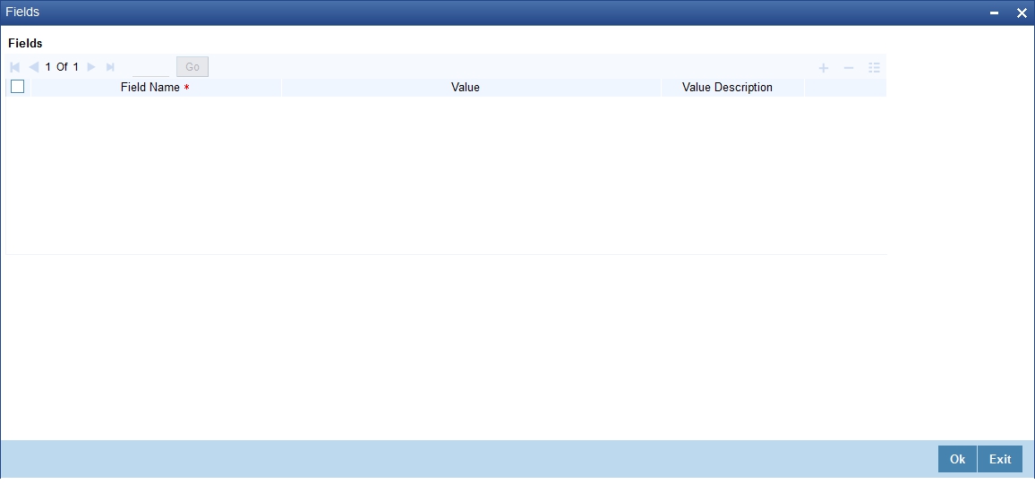

Click this button to specify values for the user defined fields (UDFs).
The User Defined Fields (UDFs) maintained for the linked function id are displayed here. You can specify values for them.
Refer the User Manual titled ‘User Defined Field’ for details about defining UDFs.

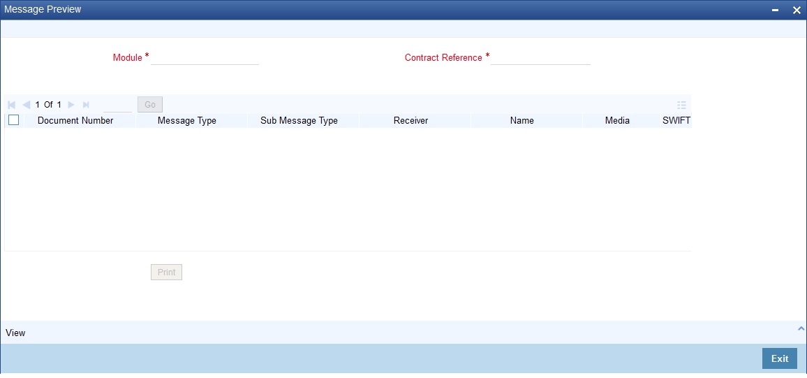

You can preview the messages or advices that will be generated for the contract using ‘Message Preview’ screen. To invoke this screen, click ‘Message Preview’ button.
For the contract, you can view the following details of the messages:
For further details on this screen, refer to the chapter ‘Processing an Islamic LC Contract’ in this user manual.

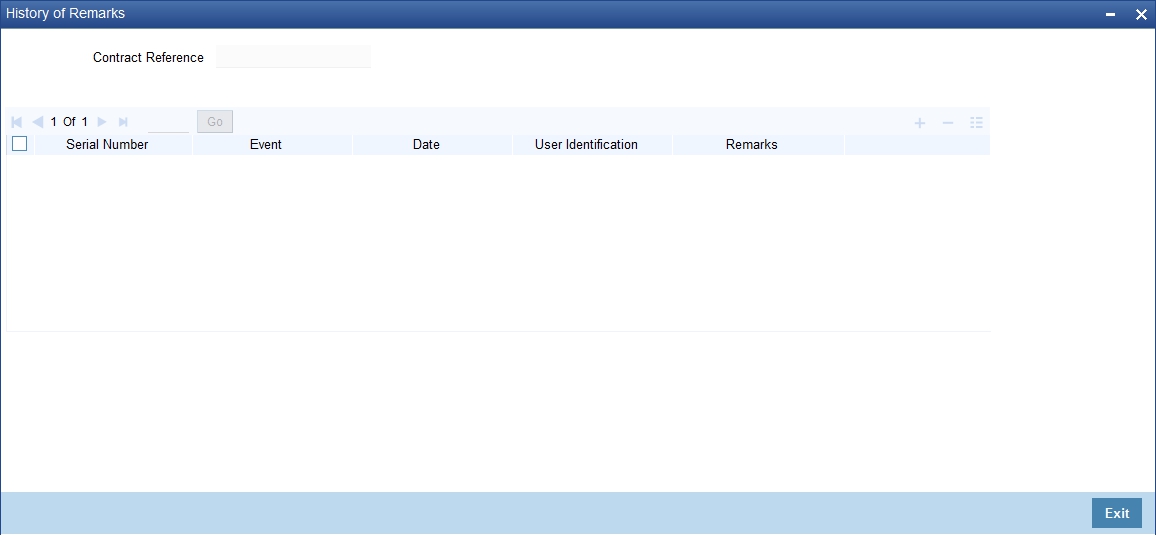

Click Remarks button to view all the instructions captured on every transaction of the contract in ‘History of Remarks’ screen.
For more details on this screen refer to the section ‘Remarks ‘in this user manual.

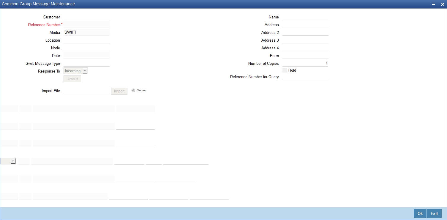

You can generate common group messages that need to be sent to a group using the Common Group Message screen. Click on ‘Common Group Message’ to open this screen. .
For field descriptions of the above screen refer section ‘Common Group Message Maintenance’ in chapter titled ‘Defining Free Format Messages’ in ‘Messaging System User Guide’.
You can enter the details of the message and the message is saved when the contract is saved. The saved messages can be viewed in the message preview subsystem before authorization. On authorization of the contract, the message is generated. After authorization, the messages can be viewed from ‘All Messages’ subsystem and ‘Events’ subsystem.
The common group messages which are supported are listed below:
