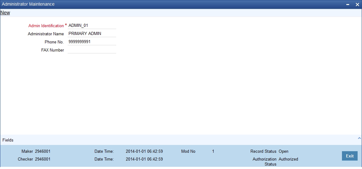

Your bank may wish to assign appropriate administrators to Loan Syndication contracts. You can maintain such administrators (also called as ‘Agents’) in the system, in the ‘Administrator Details’ screen, by assigning a unique ID to the name of each administrator. You can invoke this screen by typing ‘CSDXADMN’ in the field at the top right corner of the Application tool bar and clicking on the adjoining arrow button.

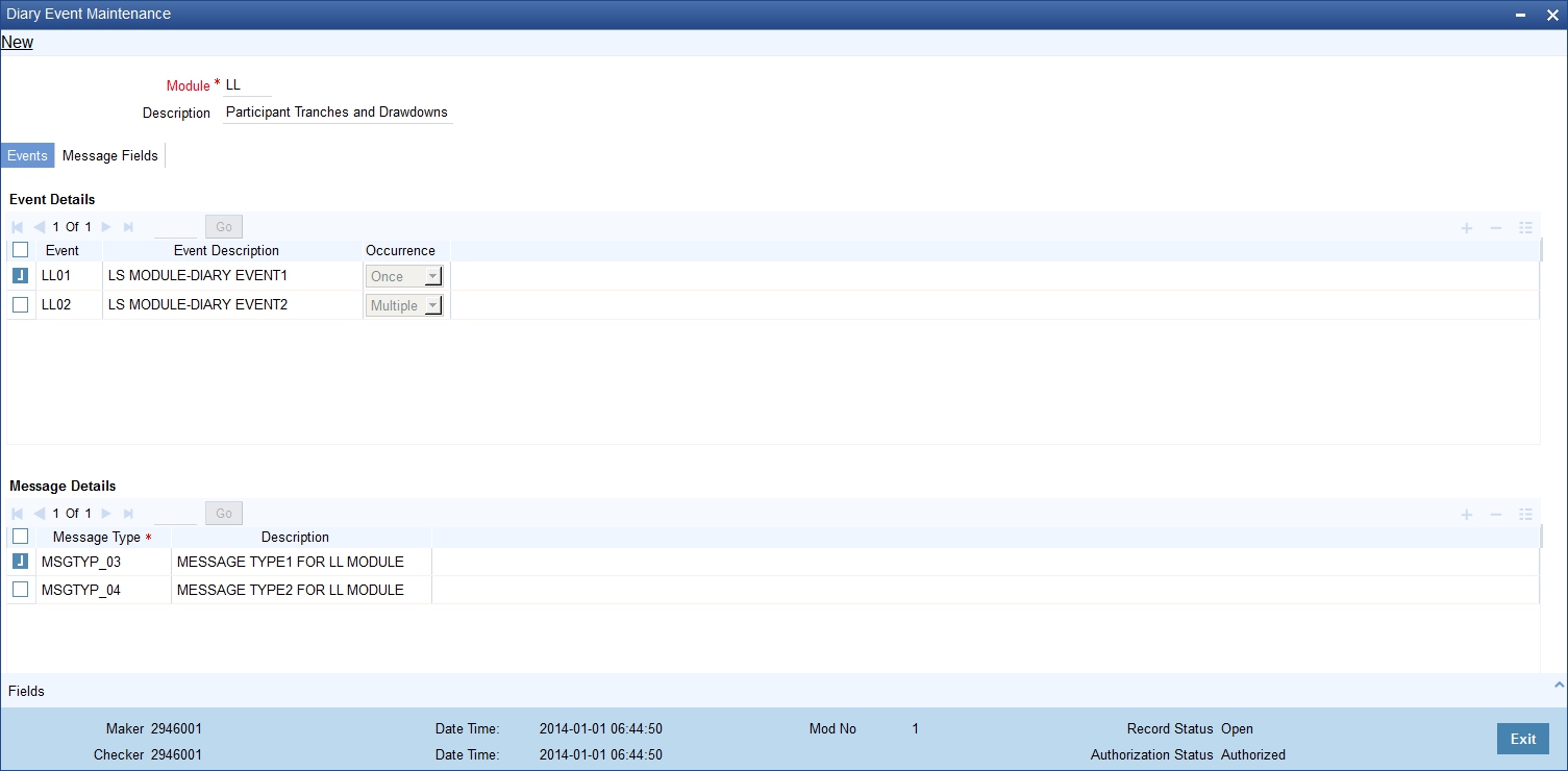

You can define the diary events to be associated with each of the Loan Syndication modules in the ‘Diary Event Maintenance’ screen. A diary event signifies occurrences (other than accounting entries being passed) in the life cycle of a contract, at which appropriate messages would need to be generated. You can invoke this screen by typing ‘CSDXDAEV’ in the field at the top right corner of the Application tool bar and clicking on the adjoining arrow button.
After you have identified the diary events in the ‘Diary Event Maintenance’ screen, you must also:
In the ‘Diary Event Maintenance’ screen, you must first specify the module to which the diary events you are defining, will apply.
For each diary event, you specify the following details:
You can maintain the message types that are to be available for generation at the occurrence of a diary event, for each Loan Syndication module, in the ‘Diary Event Maintenance’ screen.
When you make the appropriate message types available for each module in this manner, you can associate the available message type with the appropriate diary event applicable to a contract using the module, in the ‘Diary Event Messages’ screen, discussed later in this chapter.
In the Messages section in the Events tab of the ‘Diary Event Maintenance’ screen, you can specify the type of message that is to be available, along with a description of the message type.
You can also maintain the desired format for each of the message types that are available for a module, by specifying the appropriate field tags. Click on the ‘Message Fields’ tab in the ‘Diary Event Maintenance’ screen. You can specify up to 30 field tags.
