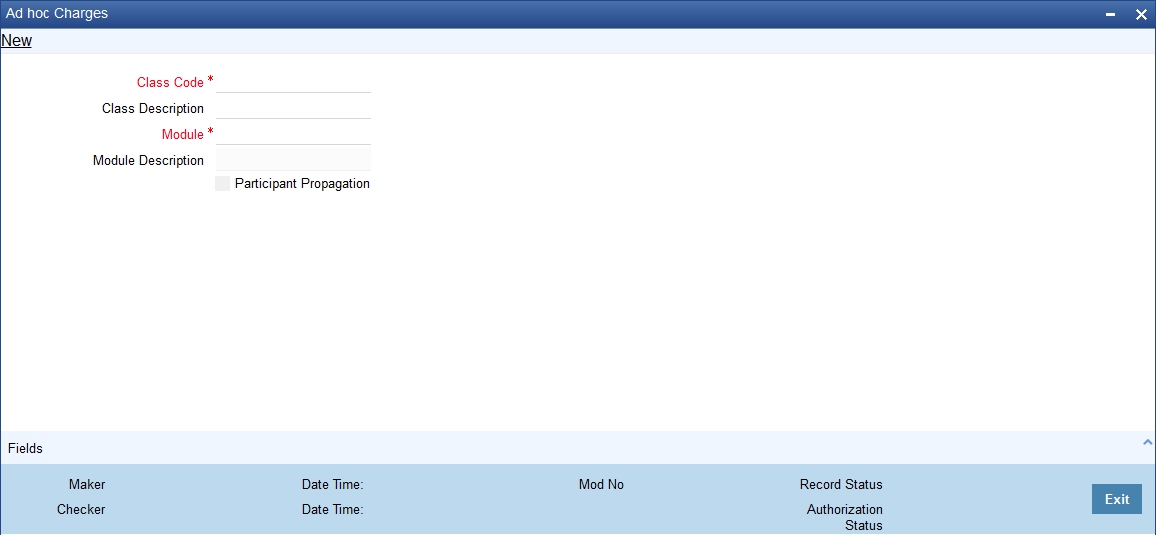

Your bank may need to levy fees on borrower facility contracts on an ad-hoc basis. You can indicate the applicability of ad-hoc fees by associating the appropriate ad-hoc fee class that you have defined for borrower facility contracts. You can invoke this screen by typing ‘CFDXADFE’ in the field at the top right corner of the Application tool bar and clicking on the adjoining arrow button.
You can capture the following details here:
Class Code
Specify a class code for which you want to maintain ad hoc charges.
Description
Give a small description for the class code entered.
Module
Specify the module for which you want to maintain ad hoc charges.
Module Description
Give a small description for the module entered.
Participation Propagation
The ad-hoc fee component that you have associated will apply to all borrower contracts using the product, and the accounting entries relating to the fee will be propagated to all participant contracts arising from the borrower contract, if so specified in the Adhoc Fee Class Definition. If so, when you associate the class with the product in the Adhoc Fee Association screen, the Propagation Reqd check box will be selected.

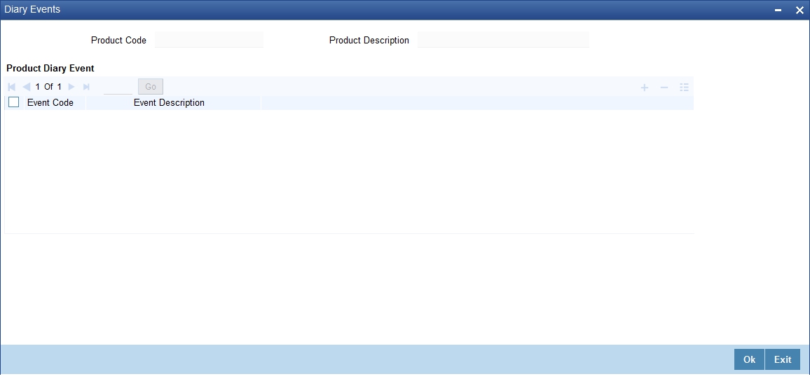

In the Diary Event Association screen, you can also specify the different diary events that would need to be processed for borrower tranche or draw down contracts using the borrower tranche or draw down product. Click the ‘Diary’ button in the ‘Loan Syndication Product’ screen to invoke the Diary Event Association screen.
In this screen, select the code of the diary event that you wish to associate with the product, in the Event Code field.

In the Diary Event Association screen, you can also specify the different diary events that would need to be processed for participant contracts using the participant product. Click the ‘Diary Event’ button in the Participant Product Definition screen to invoke the Diary Events screen.

In the Diary Event Association screen, you can also specify the different diary events that would need to be processed for borrower facility contracts using the borrower facility product. Click the ‘Diary Events’ button in the Facility Product Definition screen to invoke the Diary Events screen.
