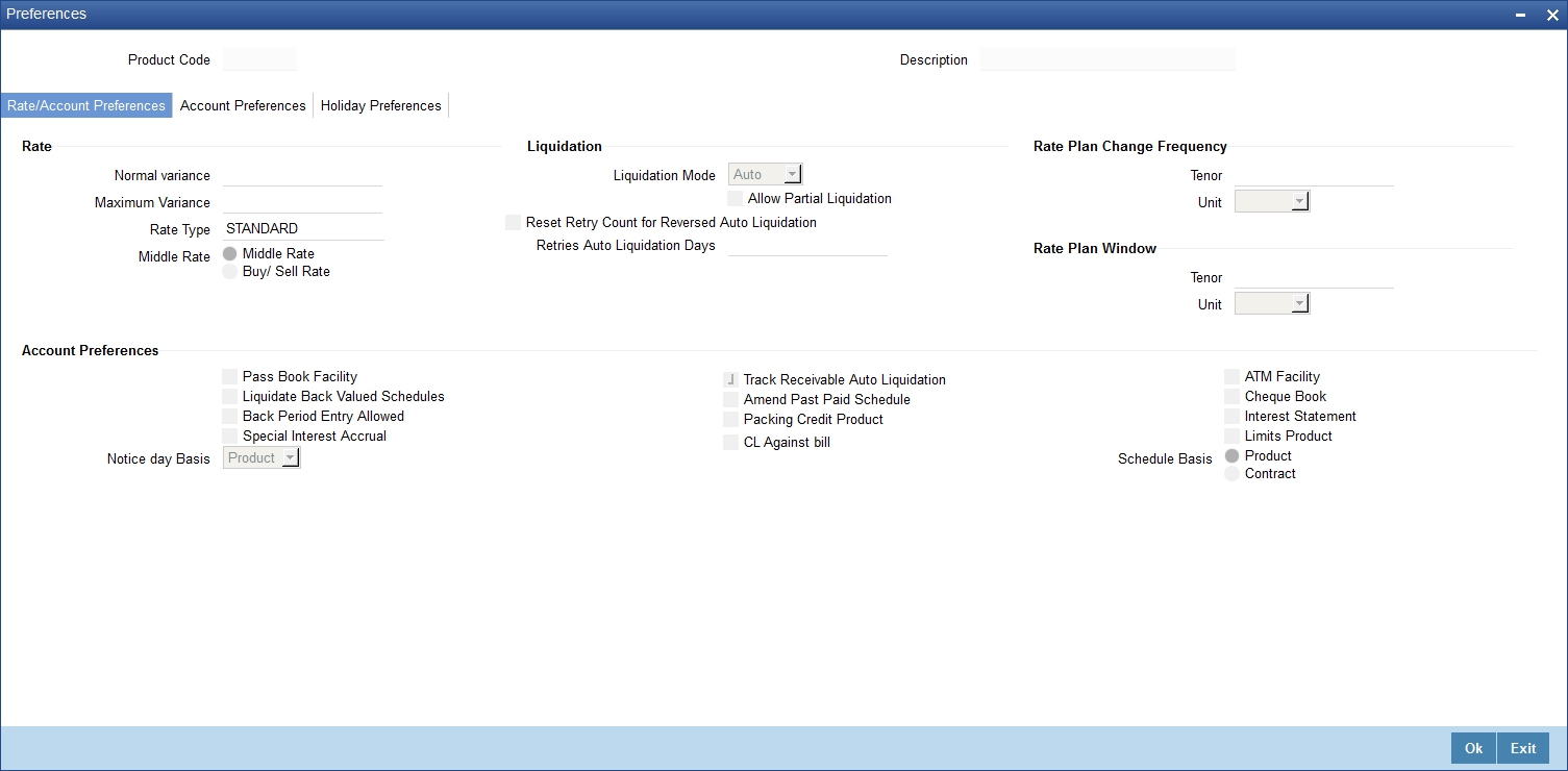

The rollover details for the borrower draw down product that you are defining can be specified in the ‘Preferences’ button of the ‘Loan Syndication Product’ screen.
You can invoke the screen ‘Loan Syndication Product’ screen by typing ‘LSDPRMNT’ in the field at the top right corner of the Application tool bar and clicking on the adjoining arrow button. Click ‘Preferences’ button.
You define the rollover preferences for a borrower loan product in the same manner as you would for a normal loan product.

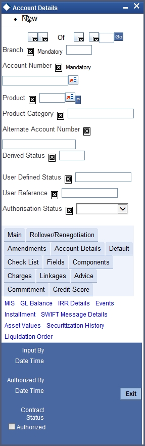

You will need to specify a special rollover amount for the rollover contract whether it is a normal, split or consolidated rollover. The rolled over contract will have the same product as that of its parent contract. The rolled over contact will also have a Value Date equal to the Maturity Date of the parent contract. Back dated rollovers are also not permitted for any type of rollover. You can rollover a loan from the ‘Contract Online’ screen. In the ‘Contract Online’ screen, click on the ‘Roll-over’ icon to rollover a contract. Subsequently, you can change the rollover instructions. When you click the ‘Roll-over’ icon, the ‘Default’ Tab is shown in the edit mode. You can specify the rollover instructions (including interest rate of the main component and the refinance rate) for the rolled over contract.
