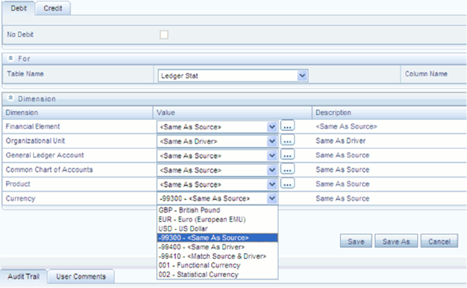

Multiple Currencies in Allocation Rules
OFSAA Profitability Management allocation engine supports the processing of balances in multiple currencies. When multiple currency functionality is enabled (FSI_DB_INFO.MULTI_CURRENCY_ENABLED_FLG = 1), a Currency dimension is enabled in each of the Allocation Specification dialogs (for example Sources, Drivers, and Outputs) that lists dimension member values. ISO Currency Code functions similarly to other dimension members in the Profitability Management user interfaces except that the ISO Currency Code dimension is a Simple Dimension and therefore does not support hierarchies. When specifying ISO Currency Codes in an Allocation rule, you may only specify a leaf value (an active ISO Currency Code) or a macro value.
·        For all tabs, the allocation rule dialogs support the Functional Currency macro ('001'), the Statistical Currency macro (non-currency Basis of '002'), and all active ISO Currency Codes.
·        The Source and Driver tabs also support an All Currencies macro. All Currencies are the default value for Source and Driver tabs.
·        The Debit and Credit pages within the Output tab also support a <Same as Source> macro. For Dynamic Driver rules, the Debit and Credit pages also support <Same as Driver >and <Match Source & Driver>.
Output Tab Showing Multi-currency Options for a Dynamic Driver Rule
Using the Currency Dimension as a Filtering Condition
As with other Key Processing Dimensions, the use of any value other than <All> will constrain the data that serves as Sources or Drivers to allocation rules. For example, if you were to specify GL Account 12345 – Salary Expense within the Source of an allocation rule, only rows having GL Account 12345 would be included in the Source of your rule. Similarly, if you were to specify US Dollars within the Source of an allocation rule, only rows denominated in US Dollars would be included.

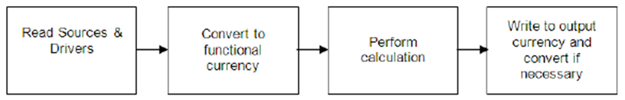

Allocation Engine Processing Flow
In Sources and Drivers, the Profitability Management allocation engine can read multiple input currencies. When posting to the Management Ledger table, the engine can output multiple result currencies. When posting to a detailed table, outputs are converted, if necessary, to match the ISO_CURRENCY_CD on each detail record to be updated.
Allocation Engine Processing Flow for Multi-currency Allocations
This diagram shows the processing flow of the Allocation Engine for multi-currency allocations.
The preceding diagram illustrates the basic allocation engine processing flow for multi-currency allocations. Input data for monetary balances are converted to the functional currency. By having all inputs in the same currency, calculations, such as percent distribution, are created on an equal basis. After converting all input data to functional currency, the allocation calculations are performed. The output results of the allocation can be in any currency. The results of calculations are converted from functional currency to the appropriate debit or credit currency for that allocation. As noted earlier you may direct the output currency to your choice for Management Ledger outputs; for detail tables, outputs always match the currency of the records to be updated.
Input rows to allocation rules are checked to determine whether currency translation is necessary. The checks for whether an item needs translation vary between the Management Ledger table and detail tables (Instrument and Transaction Summary tables).
