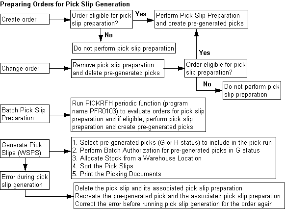

Preparing Orders for Pick Slip Generation
Pick slip preparation prepares an order for fulfillment when you create or change an order, such as creating pre-generated picks in the Pick Control Header and Pick Control Detail tables and defining whether the pre-generated picks require authorization. Preparing the order for pick slip generation in advance reduces the time it takes to run Streamlined Pick Slip Generation (WSPS) to fulfill and print the picking documents.
Pre-generated picks are picks created prior to running pick slip generation for an order. The status of a pre-generated pick is either G Generated No Authorization, indicating the pick requires authorization during pick slip generation, or H Generated Has Authorization, indicating the pick can bypass authorization during pick slip generation. Pick slip generation selects pre-generated picks to fulfill and print based on the pick slip selection criteria specified.
Pick slip preparation process:
Standard pick slip generation: You cannot use standard pick slip generation (WPSG) for orders that are eligible for pick slip preparation; you must use Streamlined Pick Slip Generation (WSPS) to complete the pick slip generation process.

When is Pick Slip Preparation Performed?
The system performs pick slip preparation when:
• An order is created; see Pick Slip Preparation when an Order is Created.
• A user or the system updates an order; see Pick Slip Preparation when an Order is Maintained.
• Pick slip generation (WSPS) cannot generate a pick slip; see Pick Slip Preparation when Pick Slips are not Generated (WSPS).
The system performs pick slip preparation when an order is created; see Applying Pick Slip Preparation to an Order for the updates that are performed.
The system performs pick slip preparation when a user or the system updates an order. In this situation, the system performs the following updates.
1. The system REMOVES any pick slip preparation from the order; see Removing Pick Slip Preparation from an Order for the updates that are performed.
2. Once the changes to the order have been made, the system EVALUATES the order to determine if it is eligible for pick slip preparation.
3. If the order is eligible for pick slip preparation after the changes to the order have been made, the system RE-APPLIES pick slip preparation to the order; see Applying Pick Slip Preparation to an Order for the updates that are performed.

Batch Pick Slip Preparation
The PICKRFH Pick Gen Refresh periodic function (program name PFR0103) allows you to submit a process that evaluates orders for pick slip preparation, and if eligible:
1. Removes any pick slip preparation that may have already occurred for the order; see Removing Pick Slip Preparation from an Order for the updates that are performed.
2. Applies pick slip preparation to the order; see Applying Pick Slip Preparation to an Order for the updates that are performed.
Use this periodic function to:
• Initially prepare existing orders for pick slip generation; see Converting Orders to Pick Slip Preparation.
• Perform pick slip preparation for orders that initially were not eligible for pick slip preparation (for example, the order had a future arrival date).
See How to Schedule a Job for instructions on assigning this periodic function to a periodic process and to schedule when the process runs.
For orders that qualify for pick slip preparation, the system performs the following updates.
Creates Pre-Generated Picks
Updates Reserved Order Lines for the Order
Updates Authorizations for the Order
For more information: See Selecting Order Lines for Pick Slip Preparation and When is Pick Slip Preparation Performed? for more information on determining when an order line is eligible for pick slip preparation, and when the system performs pick slip preparation.

Pick slip generation: When you process pick slip generation for the order, the system:
• Assigns a billing batch number to the pick.
• Updates the Date updated to the date when pick slip generation is run.
• Updates the Date printed to the date when pick slip generation is run.
• Updates the Status of the pick from H Generated Has Authorization to 2 Authorized.
• Skips batch authorization for the pick.
• Determines which item/locations to reserve stock from in order to fulfill the quantity required for the pick; see Allocating Stock.
• Sorts the picks so that they generate and print in the correct order. The sort also determines when the system creates a new pick slip PDF document for the picks in the pick slip generation run. See Sorting Pick Slips into Separate PDF Documents and Pick Slip Sort within a Pick Slip PDF Document.
• Groups the picks into documents for printing; see Generating and Printing Pick Slips.

Pick slip preparation: When you accept the order, the order does not go on hold. The system:
Creates one pre-generated pick for the order in an H Generated Has Authorization status:
Pick Control#
Status
Last Update
Gen Type
First Pick
Whs
Ship Via
5053
H
Current date
R Regular
Y
1
1
Pick Control#
Status
Last Update
Gen Type
First Pick
Whs
Ship Via
5054
H
Current date
R Regular
Y
1
1
Because the new item added to the order has a different warehouse, the system creates two pre-generated picks for the order in a G Generated No Authorization status (since the authorization amount no longer covers the shippable amount on the order):
Pick Control#
Status
Last Update
Gen Type
First Pick
Whs
Ship Via
5055
G
Current date
R Regular
Y
1
1
5056
G
Current date
R Regular
N
2
1
Creates two pick control details for the first pre-generated pick and 1 pick control detail for the second pre-generated pick:
• Assigns a billing batch number to each pick.
• Updates the Status of the pick from G Generated No Authorization to 1 Waiting for Authorization.
• Performs batch authorization for each pick.
• Sorts the picks so that they generate and print in the correct order. The sort also determines when the system creates a new pick slip PDF document for the picks in the pick slip generation run. Because a different warehouse is defined for each pick, the system sorts the picks into separate pick slip PDF documents. See Sorting Pick Slips into Separate PDF Documents and Pick Slip Sort within a Pick Slip PDF Document.
