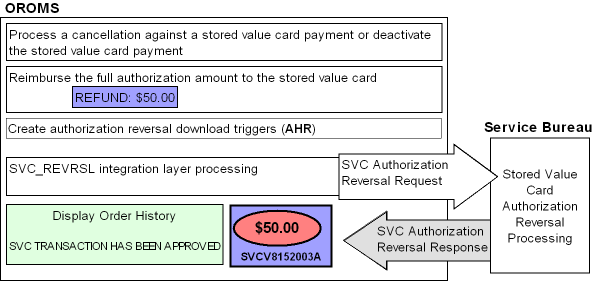

Stored Value Card Authorization Reversal Process:
1.
You process a cancellation associated with a stored value card payment or deactivate the stored value card.

3.
The system creates an authorization reversal for the original authorization amount, not the actual amount of the reversal.
4.
The system creates a record in the Auth History SVC Reversal table for the authorization amount to reimburse.

5.
The system creates an authorization reversal download trigger for the stored value card authorization reversal.
You can view all download triggers in the IL Outbound Trigger table at the Work with Outbound Interface Transactions screen.

Looks at the Authorization service field defined for the stored value card payment to determine the service bureau used to process the authorization reversal.
Note: When the Send reversal flag is not selected for the authorization service, the system does not create an authorization reversal trigger record unless the reversal is created because the stored value card payment method is deactivated.
7.
The system looks for unprocessed AHR download triggers to process, based on the setting of the Use Activation / Reversal Batch Processing (I50) system control value.
• If this system control value is selected, the system does not process the stored value card trigger records until you submit the batch process using the Transmitting Activation and Reversal Transactions (SSVC) menu option or the SVCREV periodic function (program name PFR0077).
• If this system control value is unselected, the SVC Activation and SVC Reversal integration layer jobs monitor for stored value card download trigger records to process at defined intervals, based on the Outbound delay time.
The system:
• looks for AHR download triggers with the File code AHR and a status of ready (R).
• determines which stored value card authorization reversal to download, based on the Key field for the authorization reversal download trigger.
8.
For each authorization reversal download trigger, the system generates a Stored Value Card Authorization Reversal Request.
9.
The system looks at the Communication type field for the service bureau to determine how transactions are processed between Order Management System and the service bureau.
Integration Layer = The system sends authorization reversal transactions to the service bureau using the queues defined for the authorization reversal integration layer job.
Payment Link = Point-to-point integration. The system sends authorization reversal transactions to the service bureau using a point-to-point integration. You must define communication settings in Working with Customer Properties (PROP). The system does not use an integration layer job to communicate with the service bureau; however, the system uses the job to process authorization reversal triggers. Note: This option is available for the Customer Engagement Stored Value Card Integration. See Processing Authorization Reversals Using Payment Link Communication.
If the Communication type field for the service bureau is Payment Link:
• Order Management System sends the authorization reversal request in the format of the other system. If you are using the Customer Engagement Stored Value Card Integration, the system sends the Customer Engagement Release Auth Request to the Oracle Retail Customer Engagement system.
• The service bureau receives the Authorization Reversal Request, processes the authorization reversal, and sends a response back to Order Management System. If you are using the Customer Engagement Stored Value Card Integration, the system receives the authorization reversal response from Oracle Retail Customer Engagement in the Customer Engagement Release Auth Response message.
10.
Order Management System processes the authorization reversal response accordingly. See:
What Happens When the Authorization Reversal is Approved?
What Happens When the Authorization Reversal is Declined?
An authorization reversal is approved if the Authorization Reversal Response message contains an authorization number. In this case, the system:
• updates the associated record in the Integration Process Control table to CMP complete (if the Communication type field for the service bureau is Integration Layer).
• updates the associated record in the SVC Authorization Reversal table with the approval date, approval time, and reversal response.
• creates an order transaction history message indicating the authorization reversal was approved: Reversal Has Been Approved.
• voids the authorization history record.
