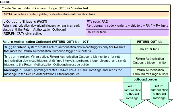

Purpose: Order Management System allows you to send created return authorization information and completed return and exchange information to another system, such as a warehouse management system.
Outbound return information flow: This flowchart explains how return information is downloaded from Order Management System.

When are Return Authorization Download Triggers Created?
The Create Return Download Triggers (K28) system control value controls whether the system creates return authorization download triggers in the Working with Outbound Interface Transactions (WOIT) menu option.
• If this system control value is selected, certain actions (see Return Authorization Outbound Trigger Activities) in Order Management System trigger the system to create return authorization download triggers in the Working with Outbound Interface Transactions (WOIT) menu option with a File code of RAD. The return authorization download (RAD) triggers that are in a Ready status in the Working with Outbound Interface Transactions (WOIT) menu option act as a "to do" list for the return authorization information that requires download.
• If this system control value is unselected, the system does not create return authorization download triggers in the Working with Outbound Interface Transactions (WOIT) menu option.
Return Download Processing
To generate a Return Authorization Outbound XML Message (CWReturnRAOut), the system:
1.
During certain activities (see Return Authorization Outbound Trigger Activities), evaluates the trigger rules defined for the Return Authorization Outbound (RETURN_OUT) job to determine if the return authorization download (RAD) trigger is created. The Return Authorization Outbound Trigger Rules for the Return Authorization Outbound (RETURN_OUT) job define the criteria the return authorization must meet in order for the system to create a return authorization download trigger.
2.
When active, the trigger monitor defined for the Return Authorization Outbound (RETURN_OUT) job looks for unprocessed return authorization download triggers to process at defined intervals, based on the Outbound delay time.
The Return Authorization Outbound trigger monitor:
• Looks for return authorization download triggers with the File code RAD and a status of ready (R).
• Removes duplicate return authorization download triggers. See Return Authorization Trigger Cleanup.
• Determines which return authorization to download, based on the return authorization download trigger Key. The Key field for return authorization download triggers consists of company code, order number, ship to number, return authorization number, and return authorization line number. For example, the Key 00700001446001001001 indicates the return authorization download information is located in company 7 for order number 1446, ship to number 1, return authorization number 1, and return authorization line number 1.
• Sends the generated return authorization download message to the queues defined for the Return Authorization Outbound (RETURN_OUT) job that are active (the Enabled field is selected).
