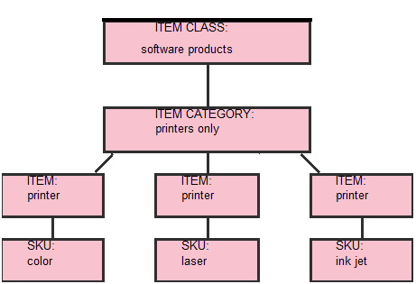

Item category codes classify and group similar items on a level below Item Class. For example, you can assign a group of items within the same item class an Item category of “printers only” to differentiate printers from the other items under that item class.

How Items are Classified and Grouped
