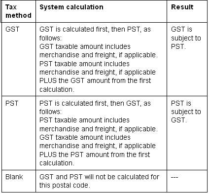

GST/PST method
Determines the sequence in which the Canadian Goods and Services Tax (GST) and the Provincial Services Tax (PST) are calculated.
If you do not define a calculation method, the system does not charge either GST or PST on orders to this SCF even if you have defined GST or PST rates.
Valid GST/PST tax calculation methods:
• blank = none
GST
PST
Separate
Optional.
