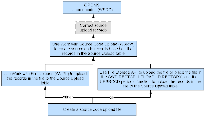

Transferring data into the Source Upload table:
• Use the File Storage API to upload the file, and then run the UPSRCCD Upload Source Code File (Program name PFR0134, Parameter IXSRCE) periodic function; or
• Place the file in the CWDIRECTCP_UPLOAD_ DIRECTORY if you do not have the file storage API enabled, and then run the UPSRCCD Upload Source Code File (Program name PFR0134, Parameter IXSRCE) periodic function; or
• Use the Work with File Uploads (WUPL) menu option to upload records to the Source Upload table.

Source code upload process: The following flowchart explains how the system creates a Order Management System source code using information defined in the Source Upload table.
