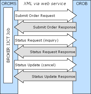

If the BROKER process in Working with Integration Layer Processes (IJCT) is active, it immediately generates the submit order request message to Order Broker to request order creation and assignment in the Order Broker. At this time, it also:
• changes each Order Broker record’s status to W (waiting).
• creates an Order Broker History record for each line to track the order submission (A - Send Order Request).
• writes an Order Transaction History message indicating that each order line was submitted to the Order Broker (for example, Ln#: 2 Submitted To Broker).
See the Brokered Backorder (Delivery or ShipForPickup) Submit Order Request Message Sample.
4.
The Order Broker module in Order Broker receives the submit order message. If Order Management System sent each line separately, Order Broker creates each order line as a separate order in its database; otherwise, if you use the split order option, Order Broker creates a single order including all of the order lines that were eligible for submission as brokered backorders. The Order Broker assigns each order or line to a location for fulfillment based on inventory availability and the business rules you have defined in Order Broker. At this point, the order status in the Order Broker database is new_order.
5.
Order Broker sends a response message to Order Management System indicating each assigned fulfilling location and the unique request ID it uses to identify each order. See the Submit Order Response Message Sample.

Status inquiry request and response process: The BROKER process in Working with Integration Layer Processes (IJCT) sends periodic status inquiry requests to the Order Broker. You use the Order Broker Status Update Interval (K10) system control value to define how many minutes Order Management System should wait before sending status inquiry requests.

Order Management System sends the submit order message to Order Broker and restricts the order line from standard processing in Order Management System by setting the Drop ship flag and the Printed quantity.
not yet created
Waiting (W)
• creates an Order Broker History record to track the order submission (A - Send Order Request)
• writes an Order Transaction History message indicating that the order line was submitted to the Order Broker (for example, Ln#: 2 Submitted To Broker)
Order Management System receives the submit order response from Order Broker
new_order
Acknowledged (K)
If there is a single fulfilling location:
• creates an Order Broker History record to track the response (B - Receive Order Response)
• updates the Order Broker record with the assigned fulfilling location
• writes an Order Transaction History message (for example, Ln#: 1 Acknowledged by Broker)
Otherwise, if there are multiple fulfilling locations, Order Management System sends a status inquiry request to Order Broker and performs the above activities when it receives the response.

The BROKER periodic function submits orders to the Order Broker if they were not eligible for submission when they were created. For example, the periodic function submits order lines if:
• your company was not configured to send brokered backorders to Order Broker when the order was created.
• the order was in held status at initial creation and was subsequently released from hold, and the Send Held Orders to OROB (M18) system control value is unselected.
• the order was previously a pre-order (see About Pre-Orders for background).
• the order line was partially reserved, but then the reserved quantity was shipped and there is still a backordered quantity remaining on the order line. The order line is not eligible to be submitted to the Order Broker until any reserved quantity is printed and shipped. Note: This situation occurs only if the Use OROB for Fulfillment Assignment (M31) system control value is unselected; also, this situation does not apply to ship-for-pickup orders sent to Order Broker for fulfillment assignment.
Note: When the periodic function submits an order line as a brokered backorder, the function performs all the updates described under Brokered Backorder Fulfillment: Initial Order Creation, but also decreases the Backorder quantity for the Item Warehouse record, since this quantity had been increased when the line was created.
