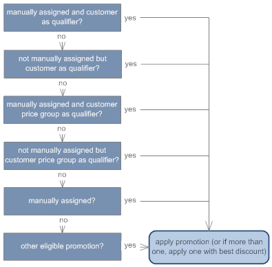

Promotion Hierarchy: Best Way
Best way promotion hierarchy: The Best Way Promotions (K44) system control value indicates whether to try to apply the promotion of each type (with the exception of BOGO promotions; see Best Way Promotion Hierarchy for BOGO Promotions) specifically called out for the order or customer, or that provides the highest discount. With this system control value selected, the system uses three basic criteria:
Manual entry? Manually-entered promotions (entered at the Enter Promotion Code Screen or passed in the inbound order message) are preferred over system-assigned promotions (applied automatically because the order is eligible and the Required entry flag is unselected). However, if the Allow Manual Entry of Promotion Code (I63) system control value is unselected, it is not possible to manually enter a promotion code.
Customer or customer price group assignment? When you specify a customer price group for a promotion, the system prefers this promotion to those without a customer price group assignment. However, when you specify a particular customer number for a promotion, this gives the promotion higher priority than promotions with just a customer price group promotion.
Best savings? If a promotion is not differentiated through manual entry, customer assignment, or customer price group assignment, the system selects the promotion of each type that provides the highest total discount dollar value. In the case of a freight promotion, a ship via override is determined to be the best value.
As a result, the system selects among eligible promotions using the hierarchy illustrated below:
If the Allow Manual Entry of Promotion Code (I63) system control value is unselected, manual entry of a promotion is not possible, so the hierarchy is simpler:
1. Customer qualifier? Is the customer specified at the Work with Qualifying Customer/Price Groups Screen?
2. Customer price group qualifier? Is the customer assigned to a customer price group specified at the Work with Qualifying Customer/Price Groups Screen?
3. Best savings? If the customer does not qualify based on customer number or price group, or if the system must select among more than one promotion with the same qualifier, it selects the promotion of each type that provides the highest total discount dollar value.
