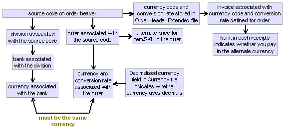

Relationships: This flowchart explains the relationships that exist when you use alternate currency pricing.
For each offer, you can define the currency of the offer and the conversion rate. If the offer is for the local currency, you do not need to define the currency code and conversion rate.
Note: When you use alternate currency pricing, the system always uses the conversion rate from the Offer table. The system never uses the conversion rate from the Currency table for alternate currency pricing.
Determining the local currency and the alternate currency: The local currency is from the Local Currency Code (A55) system control value. An offer is associated with an alternate currency only if you define a currency code different from the Local Currency Code system control value, along with a conversion rate, for the offer.
Currency calculations: The system multiplies the amount in the local currency by the conversion rate to determine the amount in the alternate currency. Likewise, the system divides the amount in the alternate currency by the conversion rate to determine the amount in the local currency.
Local currency to alternate currency: The system uses this calculation when converting the local currency to the alternate currency: local amount x conversion rate = alternate (foreign) amount.
Alternate currency to local currency: The system uses this calculation when converting the alternate currency to the local currency: alternate (foreign) amount / conversion rate = local amount.

Menu options:
Menu Option |
Description |
Define the currency and indicate whether the currency uses decimals. |
Create a bank for the currency. |
Create a division for the currency, specifying the bank. |
Create each foreign pay type. Define the authorization service and deposit service for the pay type. |
Create offers and indicate the currency code and conversion rate for each offer. If the offer is for the local currency, you can leave the currency code and conversion rate blank. |
Define the alternate price for each item/offer and SKU/offer. You can also enter an alternate price for item price breaks or SKU price breaks. You can also use these menu options to define the alternate price for each item/offer and SKU/offer: • Creating Item/SKU Offers (MISO) |
Create source codes for each offer. The offer and division must both point to the same currency. |
Define a pay type cross reference and currency cross reference for the authorization and settlement service. |
