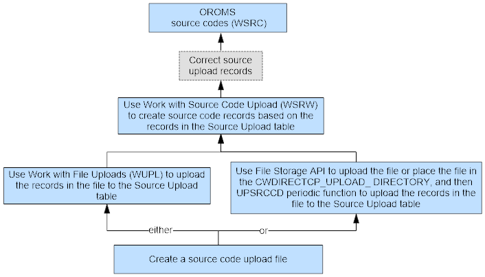

Source code upload process: The following flowchart explains how the system creates a Order Management System source code using information defined in the Source Upload table.
