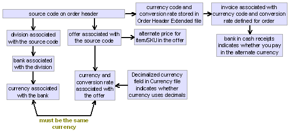

Relationships: This flowchart explains the relationships that exist when you use alternate currency pricing.
Currency of Offer
For each offer, you can define the currency of the offer and the conversion rate. If the offer is for the local currency, you do not need to define the currency code and conversion rate.
Note:             When you use alternate currency pricing, the system always uses the conversion rate from the Offer table. The system never uses the conversion rate from the Currency table for alternate currency pricing.
Determining the local currency and the alternate currency: The local currency is from the Local Currency Code (A55) system control value. An offer is associated with an alternate currency only if you define a currency code different from the Local Currency Code system control value, along with a conversion rate, for the offer.
Currency calculations: The system multiplies the amount in the local currency by the conversion rate to determine the amount in the alternate currency. Likewise, the system divides the amount in the alternate currency by the conversion rate to determine the amount in the local currency.
