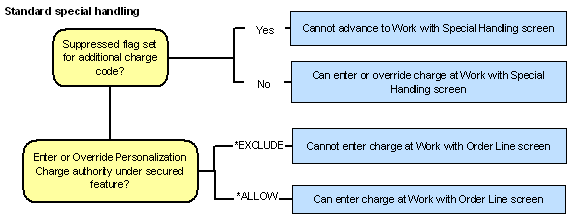

Standard special handling: The following chart summarizes how the system controls access for standard special handling formats:

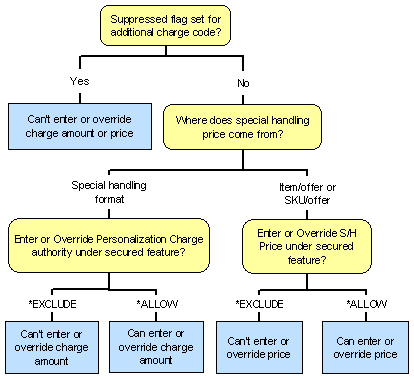

Custom special handling: The following chart summarizes how the system controls access for custom special handling formats:

Suppress S/H window
Indicates whether to suppress the display of the Work with Special Handling Screen or the Work with Custom Special Handling Screen when you add an item with special handling in order entry. You might want to suppress display in order to automatically add a charge to the Handling bucket on an order without requiring the order entry operator to complete or accept the information on the special handling screen. Valid values are:
•         blank = Leave this field blank if the S/H type field is blank, indicating the additional charge code is not for special handling.
•         Suppress = Suppress the display of the related special handling screen in order entry when you add an item with this additional charge code; however, any related handling charge is still added to the order.
•         Do not suppress = The related special handling screen is available for entry.
Not a valid entry for an additional charge code that does not have a Special handling format.
Additional considerations when suppressing the special handling screens:
Displaying special handling screens on demand: If the automatic advancement to the special handling screen is suppressed, you cannot display the screen on-demand. For example, a special handling screen is not available by selecting Special Handling for an item in order entry or order maintenance. However, you can still advance to the Display Special Handling or the Display Custom Special Handling screens in standard order inquiry, or display special handling information in streamlined order inquiry, regardless of the setting of this field. If you would like to prevent the special handling screen automatically but retain the ability to display it on demand, use the Bypass S/H flag instead of the Suppress S/H window flag.
Entering returns through order entry: If a special handling format is set to suppress display and applies to the order detail line, then the handling charge will be automatically added to the order as a credit when you create a return by entering a negative quantity in order entry. However, if the special handling format is not set to suppress display, you advance to the special handling screen and have the option of accepting or rejecting the charge.
Note:  This flag causes the special handling charge to be added to the order automatically when you use interactive order entry. For example, the charge is not added automatically through the generic order message (order API).
Does not control screen flow in Contact Center.
Optional.
Bypass S/H
Indicates whether to bypass the automatic display of the Work with Special Handling Screen or the Work with Custom Special Handling Screen when you add an item with special handling in order entry; however, you can still display the special handling screen by:
•         selecting Special Handling next to an existing order detail line
•         entering the code in the S/H field when adding an item to an order
•         entering the S/H code at the Work with Order Line Screen (Changing/Adding an Item)
Valid values are:
•         Bypass = Bypass automatic display of the special handling screen in order entry or maintenance, but leave the screen available on demand
•         Do Not Bypass = Do not bypass automatic display of the special handling screen in order entry or maintenance
Note:  You should not have both this flag set to Bypass and the Suppress S/H window flag set to Suppress for an additional charge code in order to have the special handling option work correctly in order entry and order maintenance.
Alphanumeric, optional.
