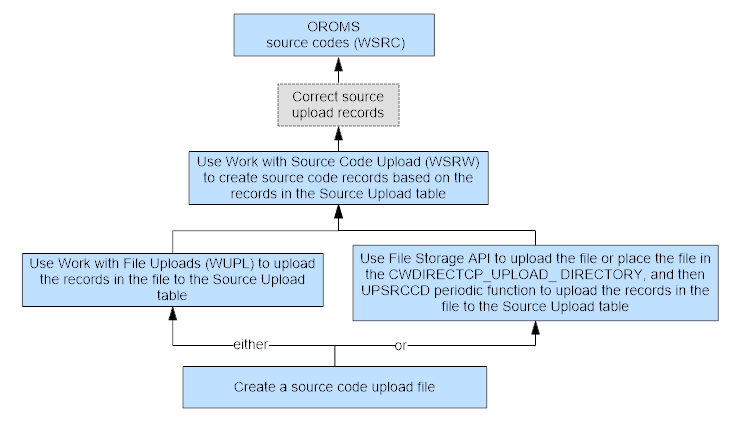

Transferring data into the Source Upload table:
•         Use the File Storage API to upload the file, and then run the UPSRCCD Upload Source Code File (Program name PFR0134, Parameter IXSRCE) periodic function; or
•         Place the file in the CWDIRECTCP_UPLOAD_ DIRECTORY if you do not have the file storage API enabled, and then run the UPSRCCD Upload Source Code File (Program name PFR0134, Parameter IXSRCE) periodic function; or
•         Use the Work with File Uploads (WUPL) menu option to upload records to the Source Upload table.

Once you upload records to the Source Upload table, you can use the Work with Source Code Upload File (WSRW) menu option to change, delete, or display source upload records and then transfer the records to the Source Code table.
When you transfer the source code records, the system validates each record in the Source Upload table:
•         If a source upload record contains any errors, the system flags the record with a status of E and includes the record on the Source Code Upload File Exception Report. You can correct source upload records that are in an error status by selecting OK on the Change Source Code Upload File Screen (1 of 2).
•         If a source upload record does not contain any errors, the system transfers the record to the Source Code table and displays the record on the Source Code Upload File Processed Listing. See Working with Source Codes (WSRC).
Source code upload process: The following flowchart explains how the system creates a Order Management System source code using information defined in the Source Upload table.
