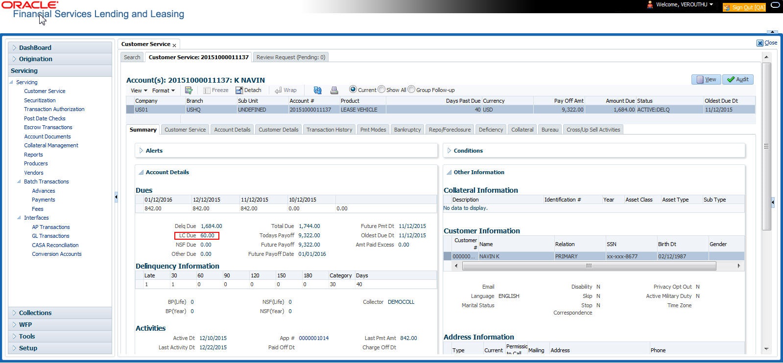

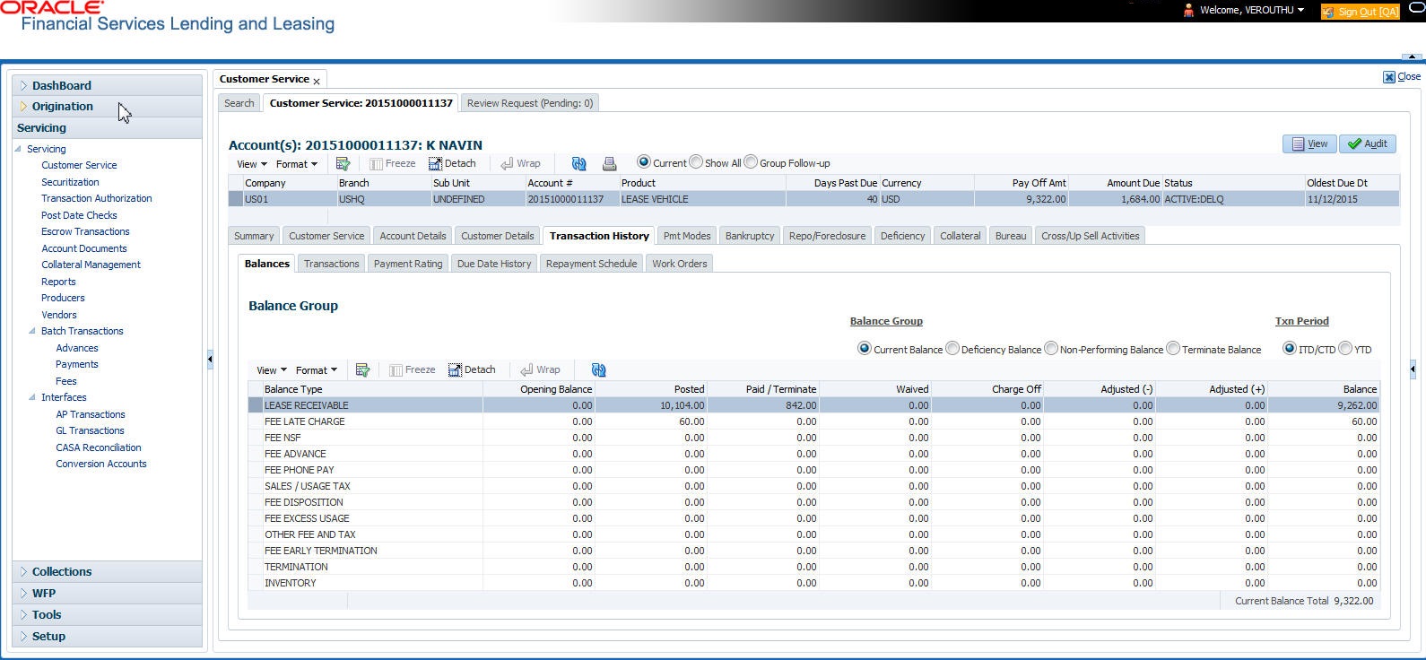

Late charges occur when payment is not made within the grace period or by the day after payment is due. The due date is determined by the contract.
Late charges appear in LC Due field on the Dues section of Summary tab of the Customer Service screen. This is the first screen to appear on the Customer Service screen when you load an account.

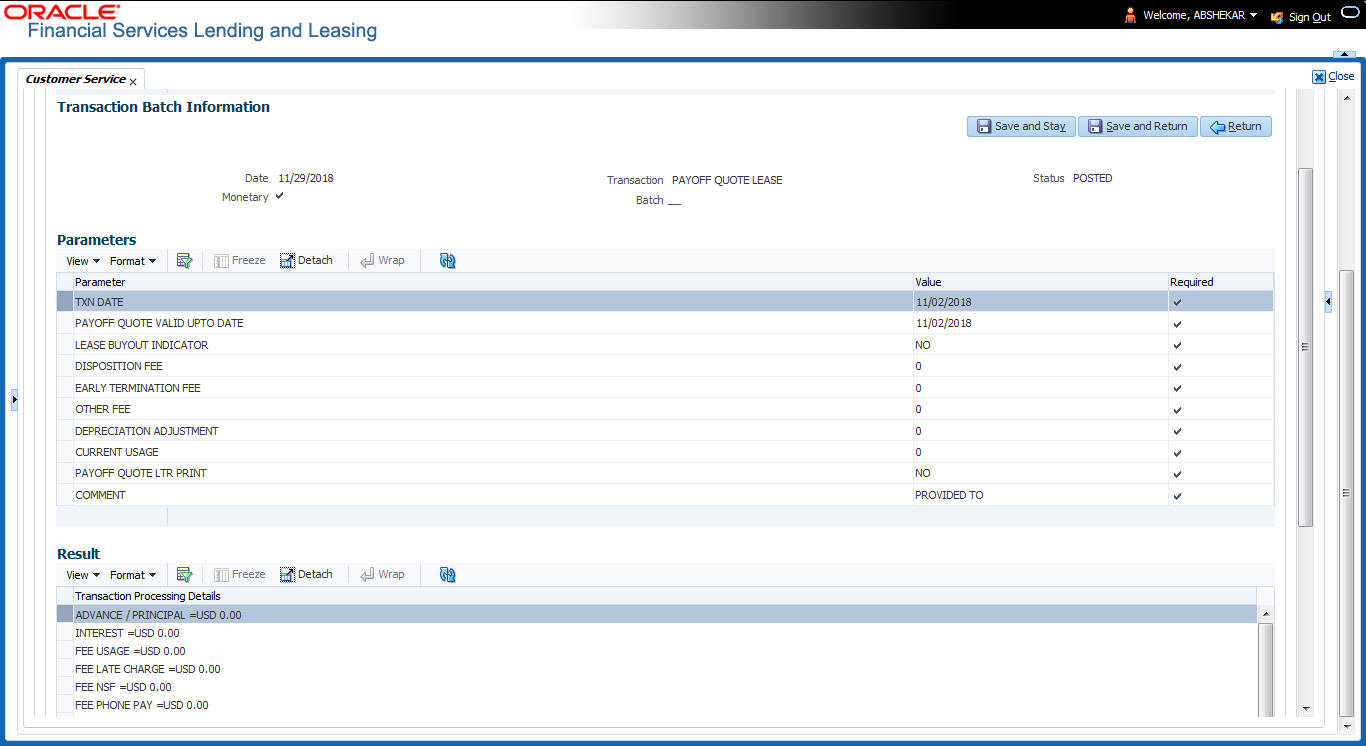

A payoff quote is the amount still owed on account or amount needed to satisfy the Lease. It can be generated anytime and may be requested during a call from a customer, dealer, or insurance agent. A payoff quote can either be generated for current or future date, but not on a back date.
You can post payoff quote during the life of a Rental/Usage Rental Lease based on following conditions:
The new balances types are displayed in the transaction result section.
The transaction processing details and new balances after posting payoff quote appears in Results section of Maintenance screen.
To generate a payoff quote for an account Lease
Transaction |
Parameters |
PAYOFF QUOTE LEASE |
TXN DATE |
PAYOFF QUOTE VALID UPTO DATE |
LEASE BUYOUT INDICATOR |
DISPOSITION FEE |
EARLY TERMINATION FEE |
OTHER FEE |
DEPRECIATION ADJUSTMENT |
CURRENT USAGE |
ASSESS PAYOFF QUOTE FEE |
PAYOFF QUOTE LTR PRINT |
COMMENT |

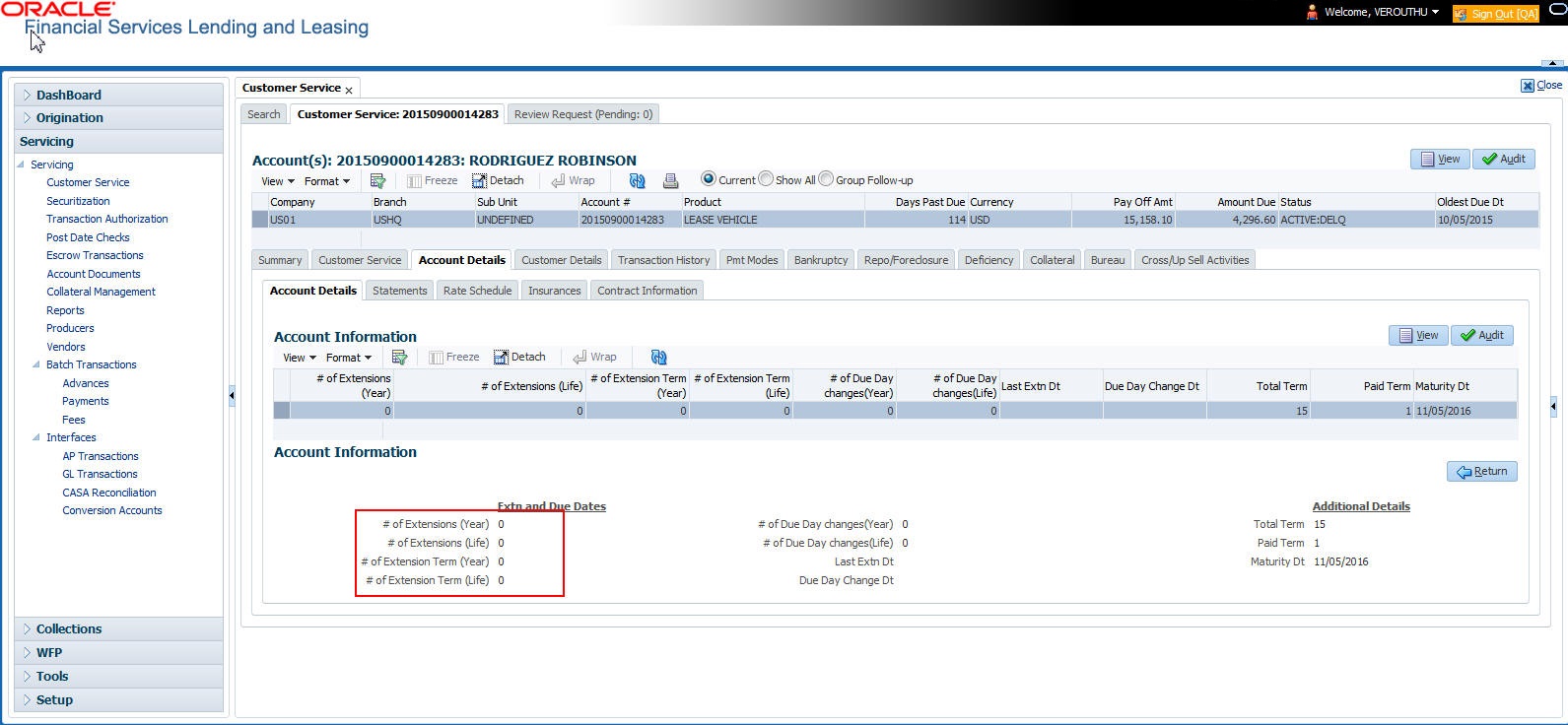

On successful posting of the transaction, system automatically increases the number on counters (i.e. number of times due date change permitted) for ‘Max Due Day Change/Yr’ and ‘Max Due Day Change/Life’. The transaction is displayed in Customer Service > Transaction History > Transactions screen.
When a posted ‘Due Date Change Override’ transaction contains error or non desired results, you can reverse the same in Customer Service > Transaction History > Transactions screen.
Select the Due Date Change Override transaction and click Reverse.
On successful posting of the transaction, system reverts (decreases) the change in the number on counters (i.e. number of times due date change permitted) for ‘Max Due Day Change/Yr’ and ‘Max Due Day Change/Life’.

The PAYOFF QUOTE transaction on Maintenance screen includes the required parameter ASSESS PAYOFF QUOTE FEE. If you select Y, Oracle Financial Services Lending and Leasing assesses a payoff quote fee on Customer Service form’s Balances screen for Balance Type FEE PAYOFF QUOTE. The amount of the payoff quote fee is based on contract setup.
The following transactions allow you to adjust or waive the pay off quote fee.
The adjustments will appears in the corresponding column of Customer Service form’s Balances screen for FEE PAYOFF QUOTE Balance Type-- Waive, Adjusted (-), or Adjusted (+) -- depending on which of the following transactions you perform.
To adjust a pay off quote fee
Transaction |
Parameters |
Adjustment to Payoff Quote Fee - Add |
Txn Date Amount |
Adjustment to Payoff Quote Fee - Subtract |
Txn Date Amount |
To waive a pay off quote fee
Transaction |
Parameters |
Waive Payoff Quote Fee |
Txn Date Amount |

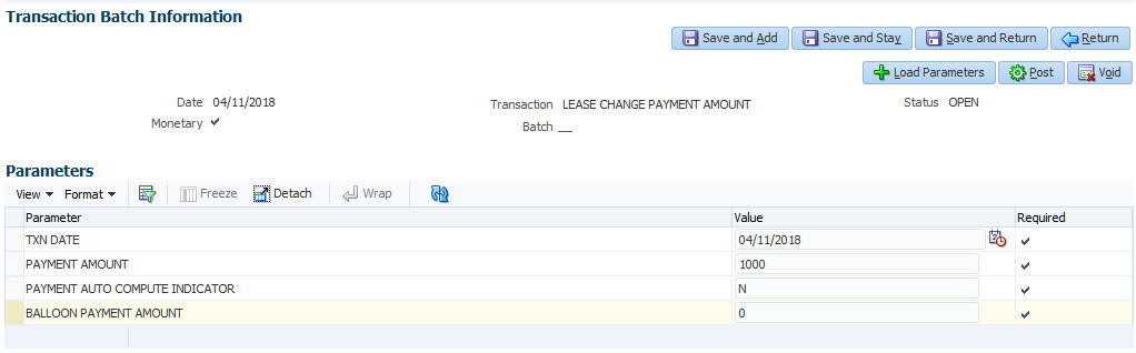

During the servicing stage of lease account, you can change the payment amount by posting ‘LEASE CHANGE PAYMENT AMOUNT’ monetary transaction and generate new repayment schedule. However, note that changing the payment amount is supported only for ‘Interest Rate’ type of lease calculation method.
While posting this transaction, you can either allow system to auto compute the new payment amount or specify the new payment amount for reschedule.
To change the payment amount
Transaction |
Parameters |
CHANGE PAYMENT AMOUNT |
TXN DATE |
PAYMENT AMOUNT |
PAYMENT AUTO COMPUTE INDICATOR |
TERM |
BALLOON PAYMENT AMOUNT |
On successful posting of the transaction, a letter of intimation is generated for correspondence by the scheduled batch LCSTXN_BJ_121_01 (LETTER FOR LEASE MONETARY TXNS) which consists of rescheduled lease contract terms indicating Transaction Date, old and new Payment Amount and Balloon Payment Amount.
You can also reverse the payment amount change and revert the payment to old amount. If there are any payment(s) received before reversal, the same is adjusted to due buckets accordingly. However, on reversal letter is not generated and has to be manually intimated.

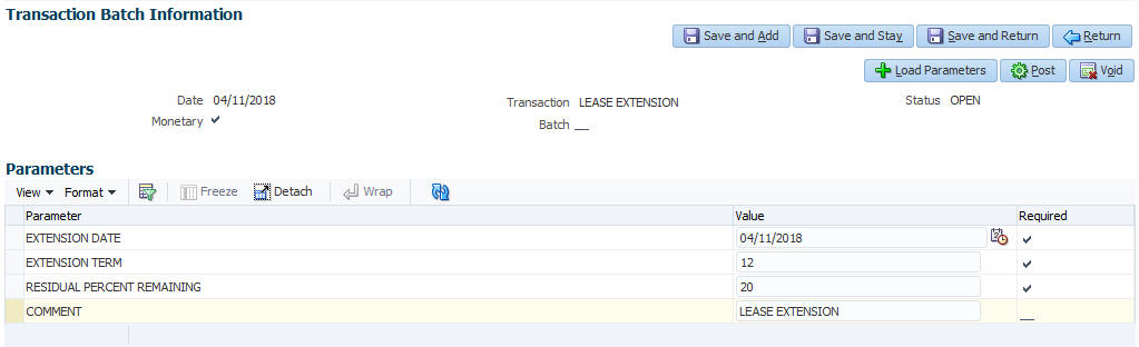

During the lease period or after the end of a lease term, you can extend the lease contract by posting ‘LEASE EXTENSION’ transaction. Based on the transaction posting date i.e. either on or before the current maturity date, the lease term is extended immediately and a comment is posted on the account indicating ‘Term extended before/after maturity date’.
Lease extension is allowed within and up to the current available residual % value of the asset and is validated against the following extension limits (values) defined in Setup > Contract screen before allowing for extension.
Note that, lease extension is allowed only for ‘Interest Rate’ type of lease calculation method and for accounts in active status. However, lease extension is not allowed in the following conditions:
To extend lease contract
Transaction |
Parameters |
LEASE EXTENSION |
EXTENSION DATE |
EXTENSION TERM |
RESIDUAL PERCENT REMAINING |
COMMENT |
While posting the above transaction, specify the current transaction posting date in Extension date, duration of extension in Extension Term, the percentage of residual value is being utilized for extension in Residual Percent Remaining and additional information or justification for extension in Comment. System validates and displays an error if the residual percent remaining does not match with system maintained data.

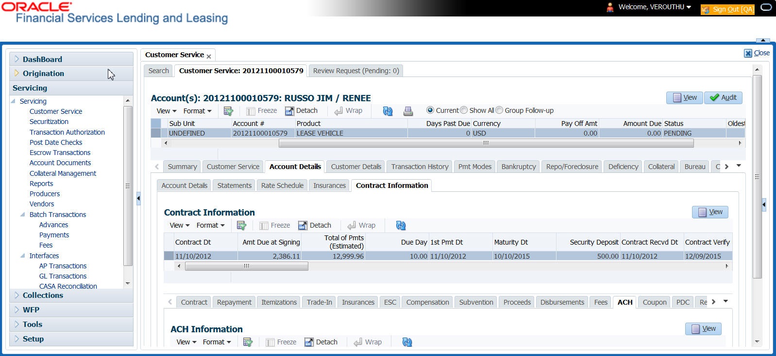

On successful posting of transaction, new maturity date is updated on the account and new repayment schedule is generated. Also the counters in Account Details and Summary screen are updated.
A letter of intimation is generated for correspondence by the scheduled batch LCSTXN_BJ_121_01 (LETTER FOR LEASE MONETARY TXNS) which consists of Extension Date, First Pmt Date, Term, Lease Expiry Date, and Residual %.

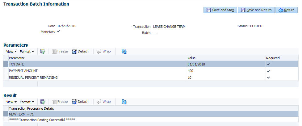

During the lease period, you can change the maturity date of a lease account and either increase or decrease the lease term by posting ‘LEASE CHANGE TERM’ transaction in Customer Service > Maintenance > Transaction Batch Information section.
‘LEASE CHANGE TERM’ transaction can either be a future or backdated and depends on the payment amount and residual percentage of remaining amount.
Note
The option to change lease term is allowed only for ‘Interest Rate’ type of lease calculation method and for accounts in active status. However, changing lease term does not impact delinquency status of the account except for back dated transactions.
To change lease term
Transaction |
Parameters |
LEASE CHANGE TERM |
TXN DATE |
PAYMENT AMOUNT |
However, lease term can also be changed by maintaining the residual % as zero.
On successfully posting the transaction, the new lease term is calculated between 'Due Dt Next' and 'New Maturity Dt' and is displayed in the ‘Results’ section. Also the new term and other details are updated on the account and new repayment schedule is generated.
The following screens are updated with lease term change:
You can also reverse this transaction in Transaction History > Transactions tab and system automatically reverses the bills generated (if any) post the lease term change.

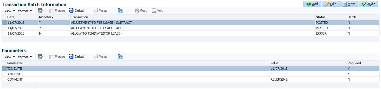

After calculating the lease fee usage if there are any differences which needs to be corrected (increase/decreased) to the fee usage amount, you can post the following two types of lease transactions to adjust fee usage balance accordingly.
To Add Lease Fee Usage
Transaction |
Parameters |
ADJUSTMENT TO FEE USAGE - ADD |
TXN DATE |
AMOUNT (Fee Usage amount that needs to be added) |
COMMENT |
To Subtract Lease Fee Usage
Transaction |
Parameters |
ADJUSTMENT TO FEE USAGE - SUBTRACT |
TXN DATE |
AMOUNT (Fee Usage amount that needs to be subtracted) |
COMMENT |

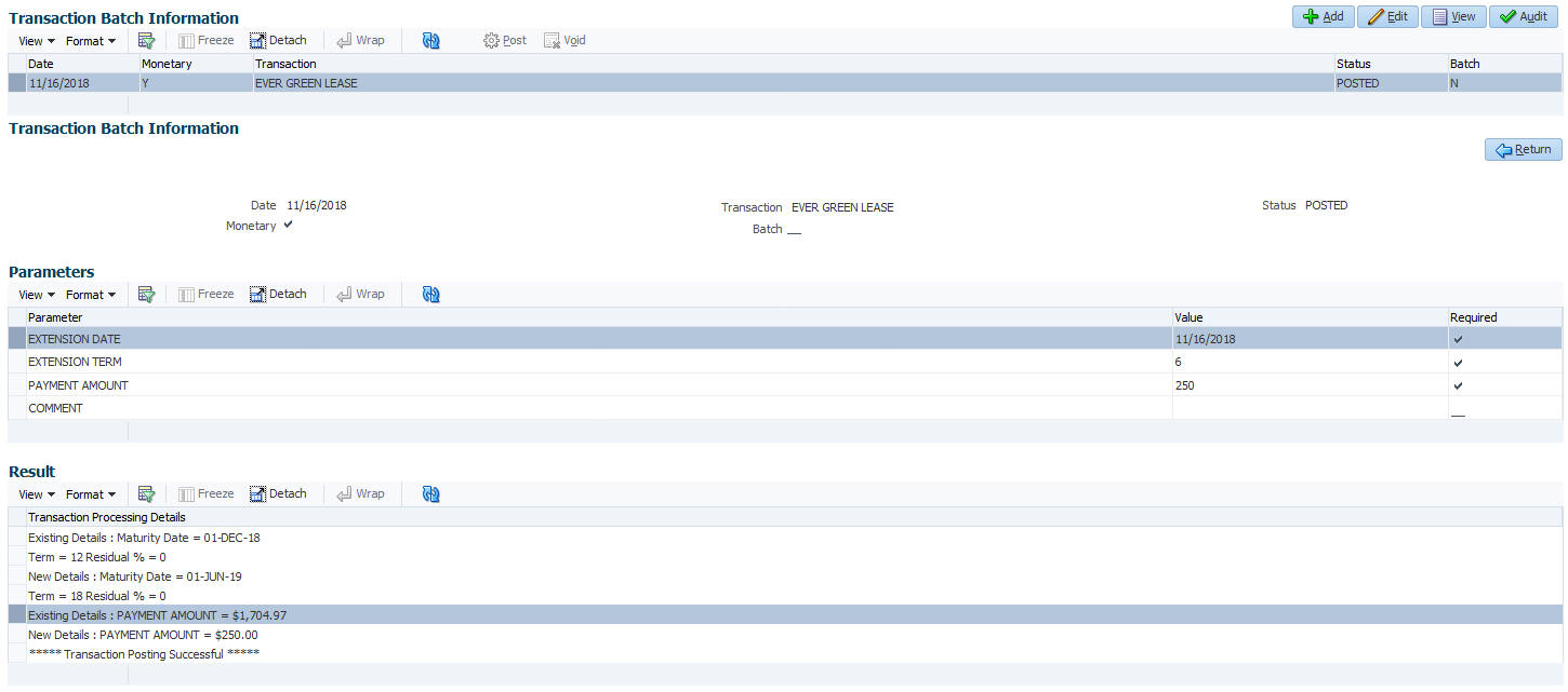

You can define Evergreen Lease contract in OFSLL by posting EVER GREEN LEASE monetary transaction in Servicing > Customer Service > Maintenance screen at anytime i.e. Before / On / After the account maturity date.
Note
Evergreen Lease in OFSLL is supported only for INTEREST RATE type of lease calculation method.
If evergreen lease transaction is posted on existing lease account, the lease account is extended up to the term specified and is billed as per the agreed ‘Payment Amount’ for extended term. Also the ‘Rate’ and ‘Residual %’ of the existing lease are updated to ‘0’ and existing balances are closed by either posting an adjustment minus transaction to the account or collecting the payment from customer.
To post ever green lease transaction
Transaction |
Parameters |
EVER GREEN LEASE |
EXTENSION DATE |
EXTENSION TERM |
PAYMENT AMOUNT |
COMMENT |
On successfully posting the transaction, the ‘Results’ section displays the details of old and new Maturity Date, Term, Payment Amount and the Residual % is set as zero. The lease receivables are updated with new amount (calculated as New Payment Amount x Term) in Servicing > Balances tab and new repayment schedule is generated. A new Evergreen lease condition is posted on the account.
You can also reverse the Evergreen Lease Transaction in Servicing > Customer Service > Transaction History tab and system automatically reverses the Payment Amount, Term and other existing lease contract details (if any).
System restricts posting the following transactions after posting evergreen lease transaction:
The following screens are updated on posting Evergreen Lease transaction:

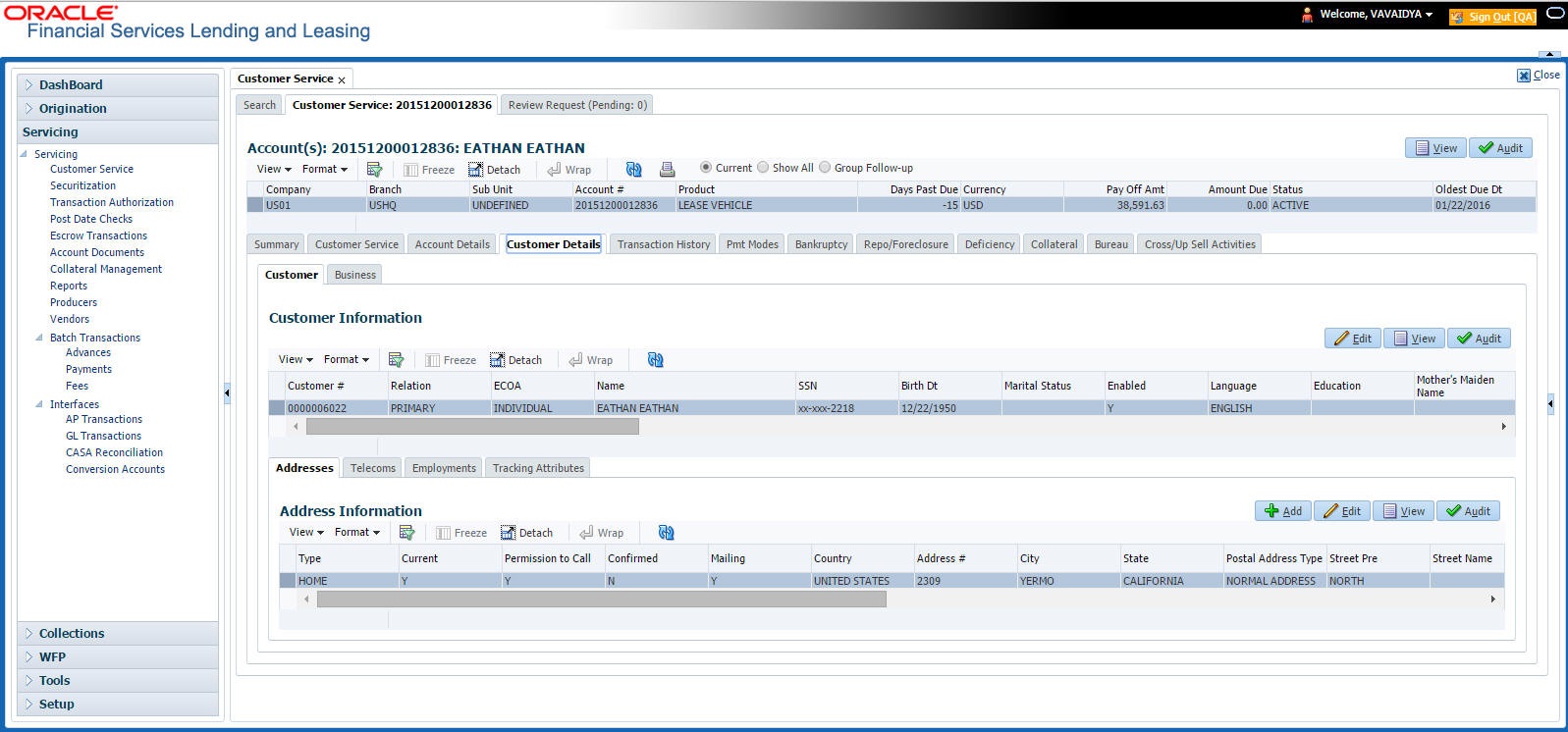

You can update and change the following details regarding a customer: social security number, marital status, disability indicator, driving license number, number of dependants, and email address.
To change other details about a customer
Transaction |
Parameters |
Customer Maintenance |
Txn Date |
Relation Type Code |
Customer SSN |
Customer Marital Status Code |
Customer Disability Indicator |
Customer Driving License Number |
Customer Number of Dependents |
Customer Email Address 1 |
Customer Birth Date |
Customer Gender Code |
Customer Language Code |
Customer Driving Licence State Code |
Customer Time Zone |
Payment Hierarchy |
Note
The payment hierarchy is auto-populated by the system based on new/existing customer details and the same can be modified. For more information, refer to Payment Hierarchy field details in Customer sub tab section.
The new details appear throughout the system.

The ACH maintenance transaction is for updating the existing ACH Banks details and not to define a new Ach Bank. The transaction is effective provided the ACH account no, ACH routing no, account type are matching with the existing Ach Banks details. On successful posting, the confirmation number will be generated.
To update the existing ACH bank details
Transaction |
Parameters |
ACH Maintenance and NEW ACH MAINTENANCE and ACH ONE TIME PHONE PAY |
ACH Account Number |
ACH Account Type Code |
ACH Payment Frequency Code |
ACH Status Code |
ACH Bank Name |
Bank City |
Bank State |
ACH Bank Routing Number |
ACH Reference Number |
Payment Mode |
Name as it Appears on Account |
ACH Default Indicator |
ACH End Date |
ACH Payment Amount |
ACH Payment Amount Excess |
ACH Payment Day |
Phone Pay Fee |
ACH Fee Indicator |
ACH Start Date |
Debit Date |
Txn Date |
Note that for an active Recurring ACH record, ensure that the payment mode is selected as AUTOPAY and for an AUTO PAY type of Payment Mode, ensure that at least one active ACH record exist.
This information appears in the ACH section of the Account Details screen.

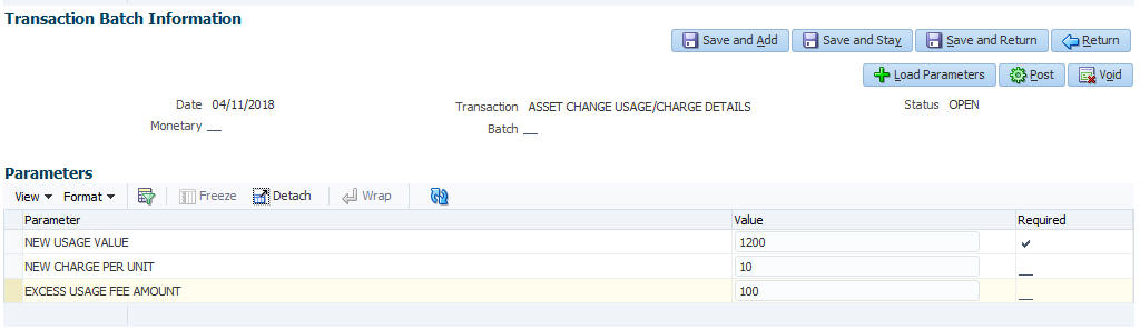

OFSLL facilitates to change the asset usage details of a lease account to new usage details and charge for the additional usage requested. However, note that this facility is applicable only for vehicle lease.
Changes to asset usage of collateral for a lease account can be updated into the system by posting the following transaction:
To change asset usage
Transaction |
Parameters |
ASSET CHANGE USAGE/CHARGE DETAILS |
NEW USAGE VALUE |
NEW CHARGE PER UNIT |
EXCESS USAGE FEE AMOUNT |
While posting the above transaction, specify the New Usage Value in kilometers and New Charge applicable for every unit extended. In the Excess Usage Fee Amount, you can include one-time fees that can be charged on the account for facilitating change usage. Based on the fee amount specified here, system posts a monetary transaction ‘FUSG_ADJ_PLUS– ADJUSTMENT TO EXCESS USAGE FEE - ADD’ as adjustment to excess usage fee balance. However transaction is not posted if no value is specified.
On successful posting of transaction, the ‘Charge’ and ‘Total’ fields are updated with new details in both Customer Service > Collateral tab and Servicing > Collateral Management screen.

To add/update Customer/Business address details into the following tabs, you can post ‘ADD CUSTOMER/BUSINESS ADDRESS PHONE’ transaction.
Also, note that if the address details are added or updated directly from the above tabs, system automatically posts the below transaction.
Transaction |
Parameters |
CUS_ADR_PH_MAINT or BUS_ADR_PH_MAINT |
TXN DATE |
ADR ADDRESS TYPE CODE |
ADR PHONE |
ADR MAILING INDICATOR |
ADR POSTAL ADDRESS TYPE CODE |
ADR ADDRESS NUMBER |
ADR STREET PRE TYPE CODE |
ADR STREET NAME |
ADR STREET TYPE CODE |
ADR STREET POST TYPE CODE |
ADR APARTMENT NUMBER |
ADR ADDRESS2 |
ADR CITY |
ADR STATE CODE |
ADR ZIP |
ADR ZIP EXTENSION |
ADR COUNTRY CODE |
ADR COMMENT |
ADR CENSUS TRACT/BNA CODE |
ADR MSA CODE |
PERMISSION TO CALL IND |
PERMISSION TO TEXT IND |
