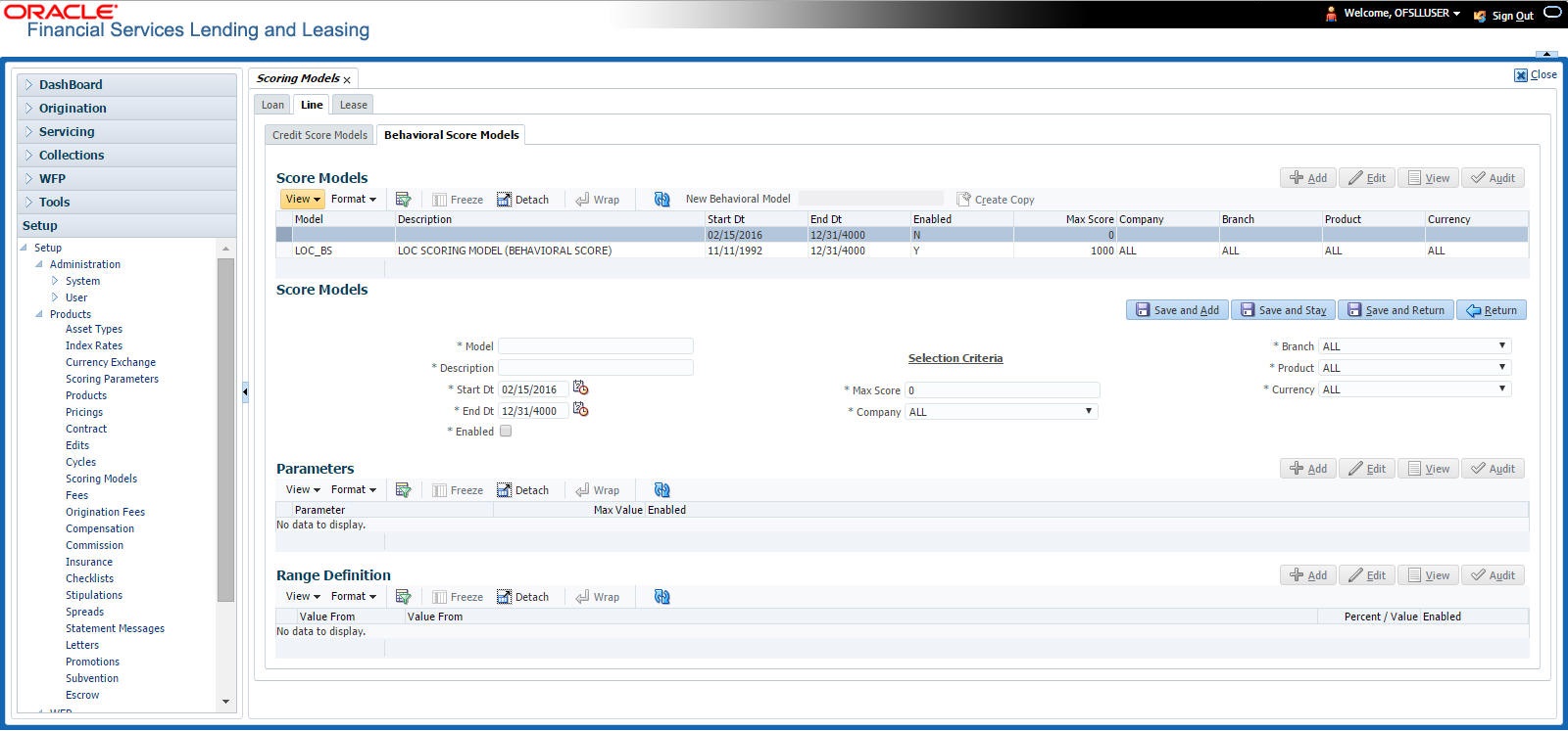

4.5.1 Credit Score Models
You can either define new Credit Score Model or specify a new name in the New Credit Model field and click Create Copy to create a copy of selected score model with details.
  1. Click Setup > Setup > Administration > User > Products > Scoring Models > Line > Credit Score Models.
A brief description of the fields is given below:
Field:
Do this:
Results section
Max Score
Specify the maximum score allowed. (This is normally the sum of the Max Value fields within the scoring parameters.).
Selection Criteria section
Company
Select the company for the scoring model, from the drop-down list. This may be ALL or a specific company.
Branch
Select branch within the company for the scoring model, from the drop-down list. (This may be ALL or a specific branch. However, if you have selected ‘ALL’ in Company field, then you must select ‘ALL’ for this field).
Product
Select the product for the scoring model, from the drop-down list. This may be ALL or a specific product.
Currency
Select the currency for the scoring model, from the drop-down list. This may be ALL or a specific currency.
Bureau Score Reasons
Check this box to use the score reasons supplied by the credit bureau. If unchecked, then automatically rejected applications scored using this scoring model display the Adverse Action Reasons from the Parameters sub screen.
Auto Decision
Check this box to assign an application, a status/sub status based on the grade associated with the score returned for this scoring model. If not selected, the system assigns applications scored using this scor­ing model a status/sub status of NEW-REVIEW REQUIRED.
Model
Specify the code for the scoring model.
Description
Specify a description of the scoring model.
Start Dt
Specify the start date for the scoring model. You can even select the date from the adjoining Calendar icon.
End Dt
Specify the end date for the scoring model. You can even select the date from the adjoining Calendar icon.

4.5.2 Behavioral Score Models
You can either define new Behavioral Score Model details or specify a new name in the New Behavioral Model field and click Create Copy to create a copy of selected score model with details.
  1. Click Setup > Setup > Administration > User > Products > Scoring Models > Line > Behavioral Score Models.
  2. In the Score Models section, perform any of the Basic Operations mentioned in Navigation chapter.
Field:
Do this:
Result section
Max Score
Company
Branch
Product
Currency
Check this box if bureau score reason is applicable.
Auto Decision
Check this box if auto decision is applicable.
Model
Description
Start Dt
End Dt
Enabled
Check this box to enable the scoring model.
  1. Perform any of the Basic Actions mentioned in Navigation chapter.
  2. Click ‘Create Copy’ button on the Score Models screen to create copy of the selected record with details.
The Parameters section records the parameters used to determine the score calculated by the scoring model. You can define multiple parameters and adverse action reason associated with each parameter in a scoring model. Each scoring parameter can have maximum values set. The score range is based upon the information in the Range Definition section on the Parameters sub tab.
The system calculates a final score by adding the score for each parameter in the scoring model. A parameter weighted value is used to find the four adverse action reasons, if bureau reasons are not used.
Note
A character parameter range definition should contain the exact value of the parameter. Each scoring parameter should have range definitions defined that encompass all of the values that might result.
  1. In the Parameters section, perform any of the Basic Operations mentioned in Navigation chapter.
Field:
Do this:
Parameter
Select the parameter from the field, from the drop-down list.
Max Value
Specify the maximum value allowed for the selected parameter.
Select the adverse action reason.
Weighted Value
Specify the weighted value.
Enabled
Check this box to enable the parameter.
  2. The Range Definition section allows you to translate the calculated value for a scoring parameter into the value to be used, depending on the returned value of the parameter.
  3. In the Range Definition section, perform any of the Basic Operations mentioned in Navigation chapter.
Field:
Do this:
Value From
Specify the lowest calculated value to apply the specific translation. The ceiling of the range definition is based on the range definition with the next highest Value From or the Max Value of the scoring parameter (whichever is less).
Value From
Select the following options to determine how values for a scoring param­eters are translated:
% Max Value – If selected, then the calculated values within the range definition receives a value based on a percentage of the Max Value of the scoring parameter.
% Param – If selected, then the calculated values within the range defini­tion receives a value based on a percentage of the calculated value of the scoring parameter.
Value – If selected, then the calculated values with in the range definition receives a specific value.
Percent / Value
Specify the percent or value to be used in the translation of the calculated value of the scoring parameter.
Enabled
Check this box to consider this range definition while translating values for this scoring parameter.

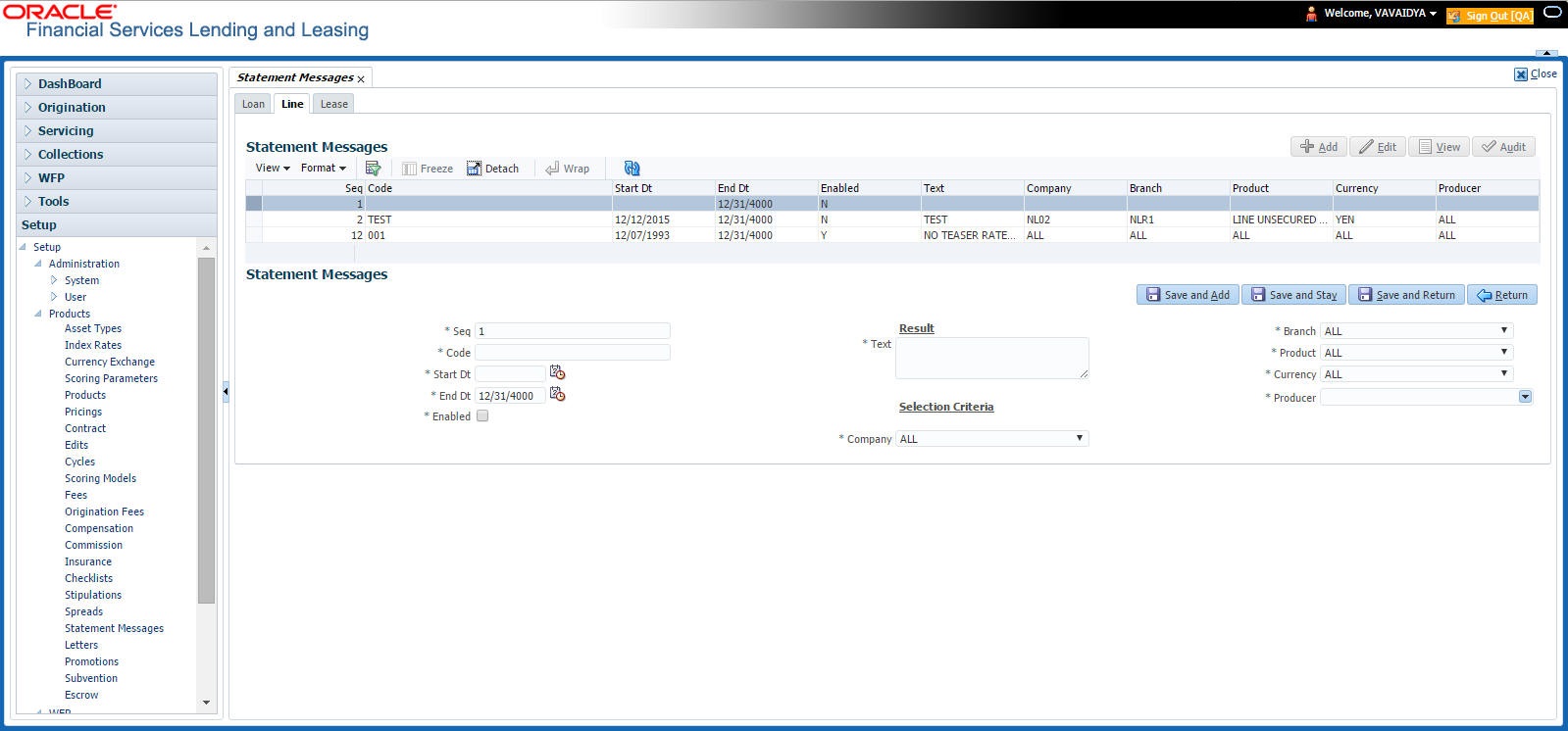

4.9 Statement Messages
The Messages screen allows you to set up messages that appear on account statements sent to customers. You can set up statement messages for different products. When the system generates a statement for an account, all statement messages matching the selection criteria are included in the statement file for that account.
The system inserts the message in the Text field into the statement file produced during the nightly batch job for the appropriate consumers.
A record of an account’s statement history, including the messages included in the statement, appears on the Statement’s screen on the Customer Service screen.
To set up the Messages
  1. On the Oracle Financial Services Lending and Leasing home screen, click Setup > Setup > Administration > User > Products > Statement Messages > Line.
  2. In the Statement Messages section, perform any of the Basic Operations mentioned in Navigation chapter.
Field:
Do this:
Seq
Specify the sort sequence of how the statement message should be printed.
Code
Specify the message code identifying the statement message.
Start Dt
Specify the first date the statement message is available. You can even select the date from the adjoining Calendar icon.
End Dt
Specify the last date the statement message is available. You can even select the date from the adjoining Calendar icon.
Enabled
Check this box to enable the message.
Result section
Text
Specify the text of the statement message.
Company
Select the company for the statement message from the drop-down list. This may be ALL or a specific company.
Branch
Select the branch within the company for the statement message from the drop-down list. This may be ALL or a specific branch. This must be ALL if in the Company field you selected ALL.
Product
Select the product for which this statement message will be used from the drop-down list. This may be ALL or a specific product.
Currency
Select the currency for the statement message from the drop-down list. This may be ALL or a specific currency.
Producer
Select the producer for the statement message from the drop-down list. This may be ALL or a specific producer. The available values come from a validated field based on the Pro Group and Pro Type.
IMPORTANT: By selecting which message to use, the system searches for a best match using the following attributes:
1. Company
2. Branch
3. Product
4. Producer
5. Currency
Hence, Oracle Financial Services Software recommends creating one version of each edit type where ALL is the value in these fields.
