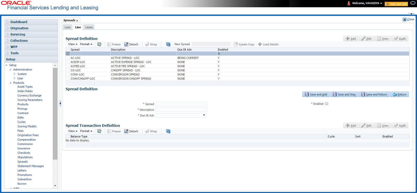

The Spreads screens allows you to define the payment allocation strategy used by your business while applying payments to accounts. Spreads are selected on the Payment Entry (Payment Maintenance) screens.
Depending on account status and condition, you can also define various combinations of spreads for same account using the Spread Matrix, which can be defaulted when particular accounts are selected for payments.
The Spreads screens consists of the following tabs:
The Spread Definition section is used to define individual spreads. Many common spreads have already been defined. With each spread, you can define the due date advancement method to use, bring current, future, or None.
The Spreads screen records the order in which balances are satisfied when a payment is applied to an account. (Unless someone indicates otherwise, payments will be applied against each balance type, in sort order, until either there is no remaining balance, or the payment has been completely allocated.)
To set up the Spreads
You can either define new Spread Definition details or specify a new name in the New Spread field and click Create Copy to create a copy of selected spread definition with details.
In the Spread Definition section, perform any of the Basic Operations mentioned in Navigation chapter.
A brief description of the fields is given below:
Field: |
Do this: |
Spread |
Specify the code identifying the spread. |
Description |
Specify the description for the spread. (This usually reflects when this spread is used.). |
Due Dt Adv |
Select the due date advancement code that determines how payments applied using this spread will affect due amounts, from the drop-down list. The system uses the following predefined Due Dt Adv Codes: NONE – Payments applied using this spread will not affect the due amounts of the account in any way BRING CURRENT – The payment allocations for transactions against an account’s outstanding balances that make up the billed balances. This will be applied against billed due amounts FUTURE – The payment allocations for transactions against an accounts outstanding balances that make up the billed balances. This will be applied against billed due amounts. Any remaining amount allocated against billed balances will be accumulated and applied against future due amounts. FUTURE WITH PRINCIPAL, INTEREST THEN ESCROW FUTURE WITH ESCROW, THEN PRINCIPAL AND INTEREST |
Enabled |
Check this box to enable the spread. |
Field: |
Do this: |
Balance Type |
Select the balance type to allocate a portion of the received payment, from the drop-down list. Note: Oracle Financial Services Software recommends that you always setup an ADVANCE/PRINCIPAL balance type for each spread. |
Cycle |
Specify the balance cycle during which to apply payments. This collects payment on bad (unpaid) cycles. You can go back by only five cycles. Cycle will have a value of 0 for loans. |
Sort |
Specify the sort order in which the balance type has payments allocated against it. |
Enabled |
Check this box for the system to consider this spread transaction when allocating payments. |
To Load Details

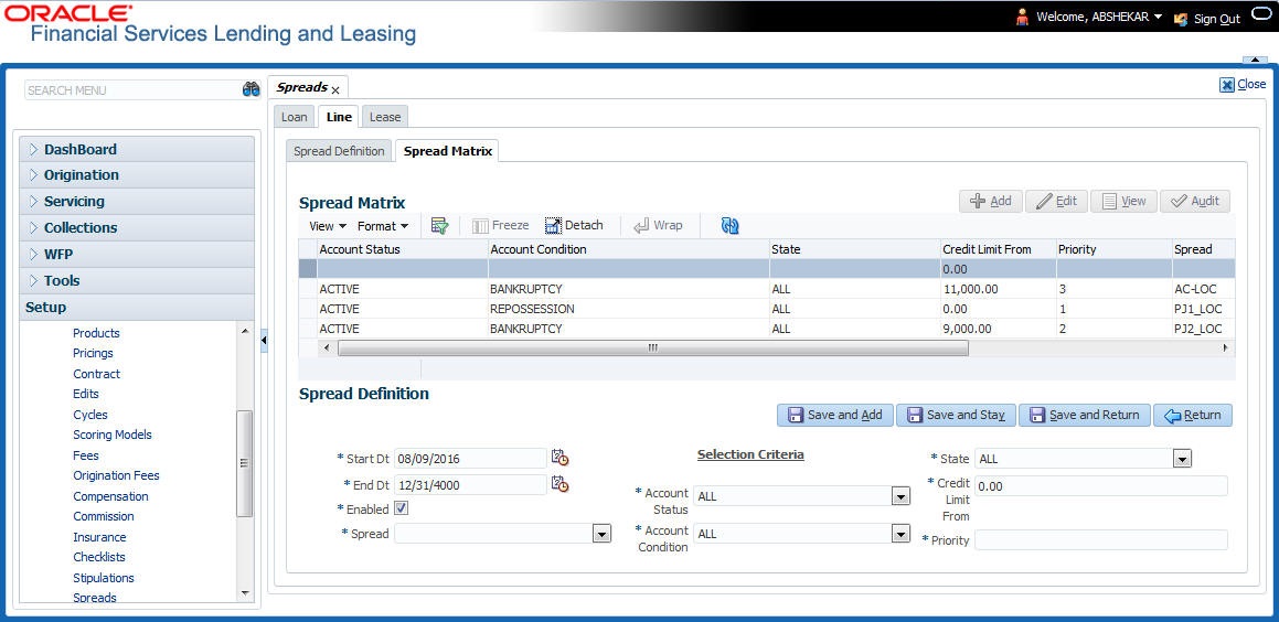

The Spread Matrix tab in Spreads screens allows you to define and maintain different combinations of spreads depending on a particular account status, Conditions, Primary Customer State, Credit Limit and Priority.
When there are multiple spreads defined for an account with different conditions, you can set the priority for the system to sequence the same.
The details maintained here are used to default the ‘Spread’ when a particular account is selected in the Payment Entry or Payment Maintenance screen.
To set up the Spread Matrix Details
Field: |
Do this: |
Start Dt |
Select the start date for the spread from the adjoining calendar. |
End Dt |
Select the end date for the spread from the adjoining calendar. |
Enabled |
This check box is selected by default indicating that the spread is enabled. |
Spread |
Select the required product active spread from the drop-down list. |
Selection Criteria |
Account Status |
Select the account status for the spread from the drop-down list. |
Account Condition |
Select the account condition for the spread from the drop-down list. Note: You can define multiple conditions for the same account. |
State |
Select the state of the primary applicant from the drop-down list. |
Credit Limit From |
Specify the value of credit limit amount from where the system should consider the current spread. |
Priority |
Specify the priority when there are multiple conditions posted on the same account. System considers the least numbered priority as first in the sequence. |
