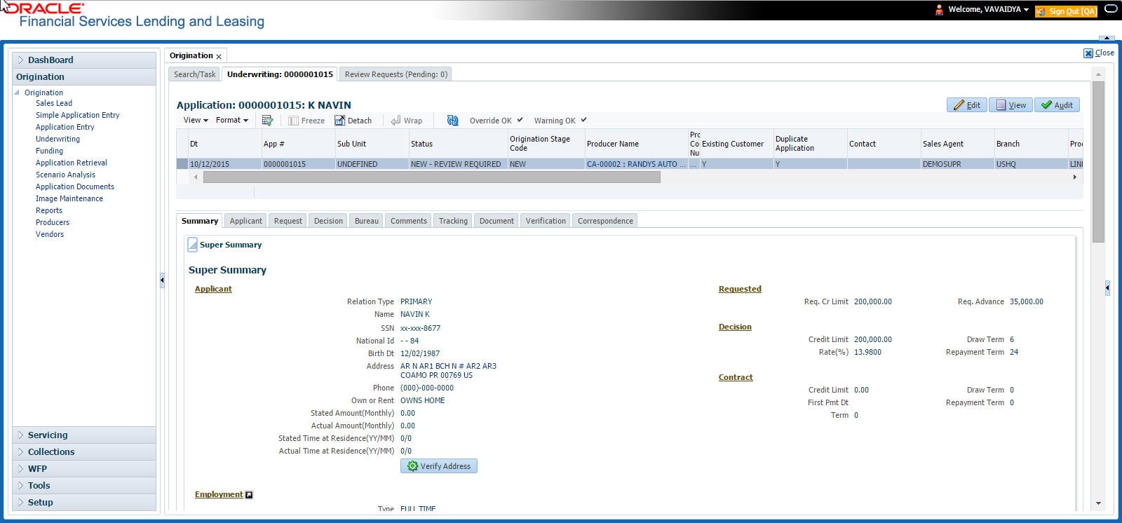

The summary screen provides a unified view of the application details without navigating to the respective screens/ sub-tabs.
Using this screen, you can view the following details in their respective sections:
To view the Super Summary
The Super Summary tab provides a snapshot of all relevant details in a single screen and contains details of Applicant, Employment, Ratios, Bureau, Requested financials, Decision updates, Contract updates and Primary Collateral details. You need not have to navigate to each of these tabs for specific information on the application. Also clicking on the hyperlinks of Address, Employment, Ratios, and Trade-In helps you to directly navigate to respective tab(s),
During the Underwriting and Funding stages, 'verified' button is displayed just below the address and employment details for each of the applicants. This would be enabled only when the Verified by and Verified Dt in the respective tabs are blank. You can verify the details from the Super Summary tab. Clicking on Verified will do the following:
You need not navigate to Address and Employment tab for verifying applicant details.

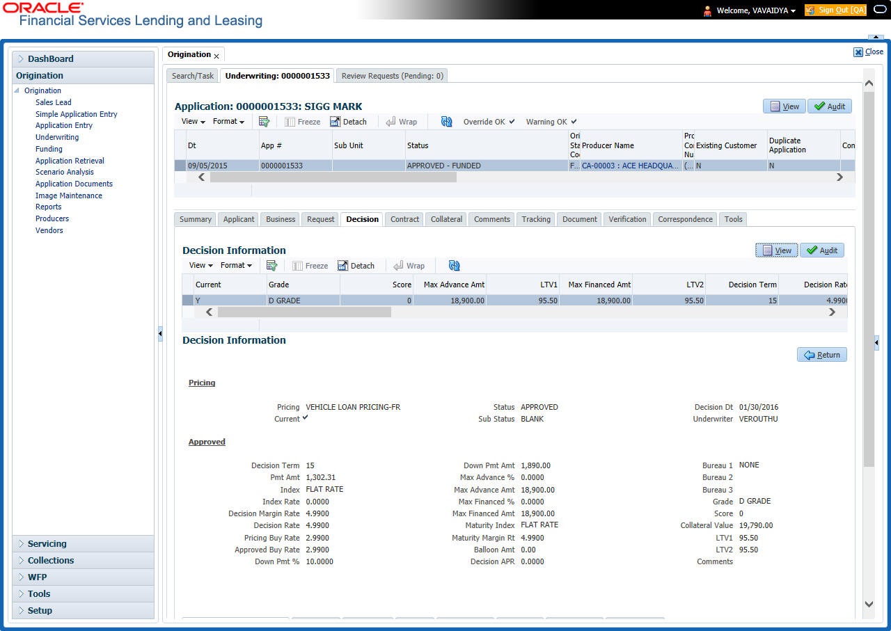

Decision details will be displayed when application has Origination Stage as “Review, Decisioned, Contract or Funded”. In case an application is Rehashed, only Decision information will be displayed and Contract information will not be displayed. Contract details will be displayed when application has Origination Stage as “Contract or Funded”.
The system displays the collateral details maintained in the collateral tab on click of navigation button under the headings Primary Collateral and Secondary Collateral. Collateral details for Unsecured loan also will be displayed if they are maintained.
All the trade-in details, if any, maintained in the application would be displayed on click of Navigation button.

The system calculates debt ratios in the Ratios section on the Summary sub screen (Applicants link) using the data in the Incomes and Liabilities sections. Information in the Incomes section comes from the Employments sub screen and the Other Incomes sub screen during application entry. The information in the Liabilities section comes from the Address sub screen, the Liabilities sub screen during application entry, and the credit bureau pull.
To View Summary sub tab
A brief description of the fields is given below:
Field |
Do this |
What if Pmt Amt |
Specify the payment amount you want to use in the ratios. |
Score |
View the credit score for the application |
Grade |
View the credit grade for the application |
Totals |
Monthly Income- Stated Amt |
The stated monthly income. |
Monthly Debt- Stated Amt |
The stated monthly liability. |
Monthly Income- Actual Amt |
The actual monthly income. |
Monthly Debt- Actual Amt |
The actual monthly liability. |
Assets Amt - Liabilities Amt |
The net worth amount. |
Ratios |
Debt - Stated Before (%) |
The debt amount stated before. |
Debt - Stated After (%) |
The debt amount stated after. |
Debt - Actual Before (%) |
The actual debt amount before. |
Debt - Actual After (%) |
The actual debt amount after. |
Disposable Inc - Stated Before (%) |
The disposable income stated before. |
Disposable Inc - Stated After (%) |
The disposable income stated after. |
Disposable Inc - Actual Before (%) |
The actual disposable income before. |
Disposable Inc - Actual After (%) |
The actual disposable income after. |
Revolving Debt - Stated Before (%) |
The stated revolving debt before. |
Revolving Debt -Stated After (%) |
The stated revolving debt after. |
Revolving Debt - Actual Before (%) |
The actual revolving debt before. |
Revolving Debt - Actual After (%) |
The actual revolving debt after. |
Pmt to Income - Stated Before (%) |
The stated income payment before. |
Pmt to Income - Stated After (%) |
The stated income payment after. |
Pmt to Income - Actual Before (%) |
The actual income payment before. |
Pmt to Income - Actual After (%) |
The actual income payment after. |
Once the payment amount is approved in Decision screen, it will be copied and displayed in the What if Payment field in Summary sub screen.
The system offers powerful tools to the underwriter for analyzing an applicant’s debt-to-income ratios (total of an applicant’s debt obligation divided by that person’s regular income). The system calculates debt ratios in the Ratios section on the Summary sub screen (Applicants link) using the data in the Incomes and Liabilities sections. Information in the Incomes section comes from the Employments sub screen and the Other Incomes sub screen during application entry. The information in the Liabilities section comes from the Address sub screen, the Liabilities sub screen during application entry, and the credit bureau pull.
An underwriter may also add information to the Incomes and Liabilities sections on the Summary sub screen during the underwriting process.
The debt-to-income ratios in the Ratios section can be recalculated by including or excluding information from the Incomes section, Liabilities section and Financials sub screen.

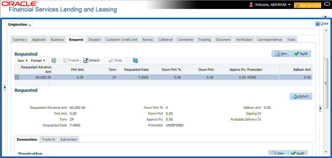

In the Request tab you can define the required Loan parameters and calculate Payment, Interest Rate, Term and Loan Amount using the quick calculator. By default, system calculates for monthly repayment term basis. The payment frequency can be changed only in the Underwriting tab during decisioning.
To complete Request section:
A brief description of the fields are given below:
Field |
Do this |
Requested Advance Amt |
Specify the requested advance amount |
Pmt Amt |
Specify the requested payment amount. |
Term |
Specify the requested term (number of payments). |
Requested Rate |
Specify the requested rate of interest. |
Down Pmt% |
Specify the down payment percentage |
Down Pmt |
Specify the down payment amount |
Approx Prc |
Specify the approximate cash price |
Promotion |
Select the promotion type from the drop-down list. |
Balloon Amt |
Specify the balloon amount. |
Signing Dt |
Specify the signing date |
Probable Delivery Dt |
Specify the probable delivery date. |

To verify the application decision data
Field: |
Do this: |
Pricing section |
Current |
Check this box to indicate that this is the current decision. |
Pricing |
View the pricing. |
Decision Dt |
View the decision date. |
Underwriter |
View the underwriter id. |
Status |
View the application status. |
Sub Status |
View the application sub-status. |
Approved section |
Decision Term |
Specify the approved decision term. |
Pmt Amt |
Specify the approved payment amount. |
Index |
Specify the index type. |
Index Rate |
Specify the approved index rate. |
Decision Margin Rate |
Specify the approved decision margin rate. |
Decision Rate |
Specify the approved decision rate. Note: For Islamic products this field is displayed as ‘Profit Rate’. |
Pricing Buy Rate |
View the pricing buy rate. |
Approved Buy Rate |
View the approved buy rate which is by default the Pricing Buy Rate displayed above. You can also specify the required approved buy rate. |
Down Pmt % |
Specify the approved down payment percentage. |
Down Pmt Amt |
Specify the approved down payment amount. |
Max Advance % |
Specify the approved advance percentage. |
Max Advance Amt |
Specify the approved advance amount. |
Max Financed % |
Specify the maximum amount financed percentage. |
Max Financed Amt |
Specify the maximum amount financed. |
Maturity Index |
Select the approved post maturity index. |
Maturity Margin Rt |
Specify the maturity rate. |
Balloon Amt |
Decision APR |
Specify the decision APR. |
Bureau 1 |
Specify the Bureau 1. |
Bureau 2 |
Specify the Bureau 2. |
Bureau 3 |
Specify the Bureau 3. |
Grade |
Select the credit grade. |
Score |
Specify the credit score. |
Collateral Value |
View the collateral value. |
LTV1 |
View the loan to value ratio. |
LTV2 |
Comments |
Specify comments, if any. |
The system determines the best pricing match of all enabled Loan pricing strings in the Setup menu and displays the results in the Pricing and Approved sections.
In the ‘Decision Information’ section, there is a drop-down list adjacent to the ‘Calculate’ button with following options to auto calculate different Loan decision parameters based on the data provided. Select the required option from the drop-down list and click ‘Calculate’:
The system displays the requested calculation in the respective field.
A 'Re-Score' button is available next to 'Calculate'. Whenever any sensitive Financial or Collateral information is amended in the Application, OFSLL displays a warning message 'Scoring sensitive information is changed. Re-score the application'. You need to click on Re-Score to re-validate the grade and pricing accordingly.
The display of the warning message to Re-score the application can be controlled using the respective System parameter. If the defined System Parameter is flagged 'Y', only then the message is displayed.
