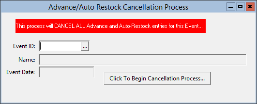

Figure 1-39 Cancel Auto Restock
This figure displays the Advance/Auto Restock Cancellation Process window.
  1. On the toolbar, click Warehouse, click Auto Restock, and then click Cancel Automatic Restock.
  2. Click Click to Begin Cancellation Process, and then click Yes when prompted for confirmation.
