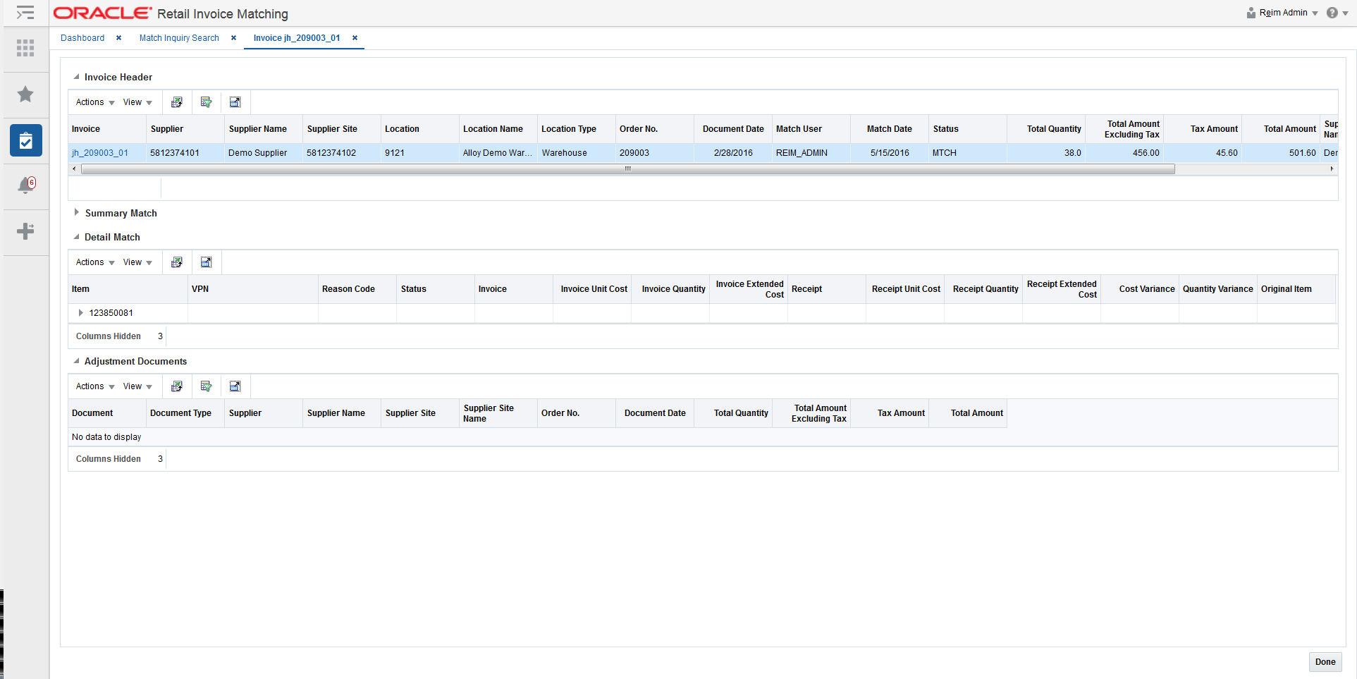

  2. In the search results, click the invoice you want to unmatch. The Matched Invoice screen is displayed.
    Figure 3-2 Matched Invoice Screen

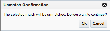

  3. Select Unmatch from the Action menu. An Unmatch Confirmation dialog is displayed.
    Figure 3-3 Unmatch Confirmation Dialog

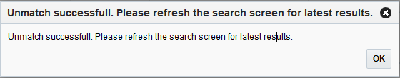

  4. Click OK to confirm the unmatch. A dialog is displayed confirming that the unmatch was successful.
    Figure 3-4 Unmatch Successful Dialog
