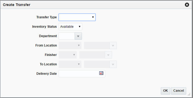

To create a transfer:
From the Tasks menu, select Inventory > Transfers > Create Transfer. The Create Transfer pop-up appears.
In the Transfer Type field select the type of transfer. The options are: Administrative, Book Transfer, Confirmation, Intercompany, Manual Requisition, Reallocation Transfer, and Return to Vendor.
In the Inventory Status field, select the inventory status. The options are: Available and Unavailable.
In the Department field, enter, select or search for the department from which the items will be transferred. If items from multiple departments are to be transferred, then leave this blank.
In the From Location field, select Store or Warehouse. Then enter, select or search for the location.
In the Finisher field, select either Internal or External option. Enter, select or search for the finisher ID, if the transfer will pass through a finisher.
Finishers are required for transfer that will have work orders, transformations, or packaging instructions.In the To Location field, select Store or Warehouse. Then enter, select or search for the location.
In the Delivery Date field, enter the earliest date that the transfer can be delivered to the store or warehouse or use the Calendar icon to select a date.
Click OK to save any changes. The Transfer page appears.
Click Cancel to return to the Tasks menu without saving changes.

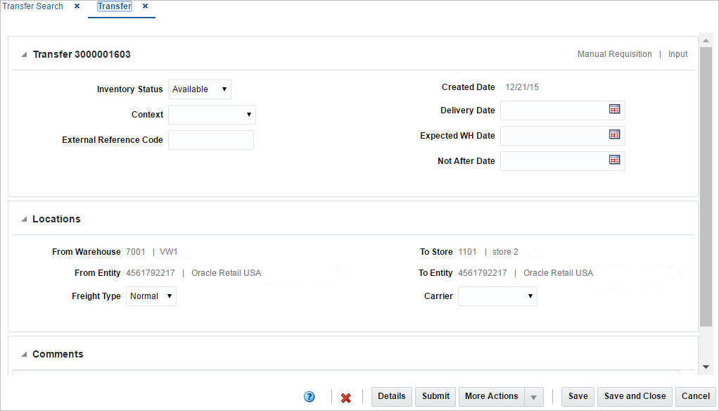

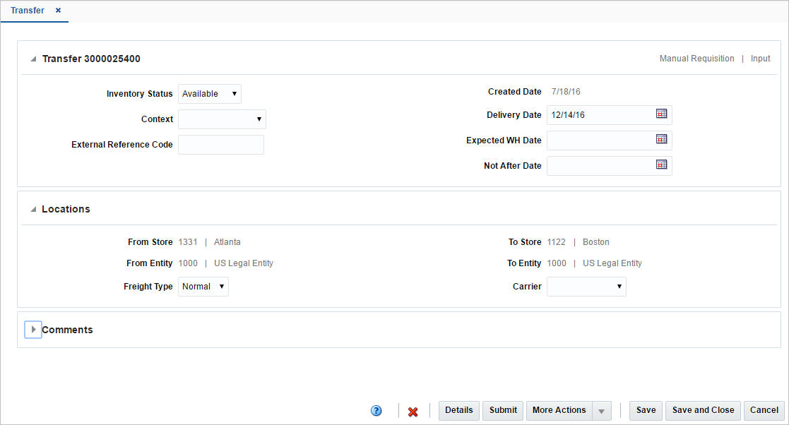

Once a transfer is created, the Transfer page appears. The Transfer page allows you to enter additional information about the transfer.
Table 3-1 Transfer Header - Fields and Description
| Fields | Description |
| Title | The title displays the Transfer ID to the top left of the header. The Transfer Type and Status is displayed at the top right of the header. |
| Department | This field displays the department ID and the department. |
| Inventory Status | This field displays inventory status. The options are Available and Unavailable. |
| Context | Select the context from the list. The options are: Promotion, Customer Transfer, Store Requisition, and Repairing. |
| External Reference Number | Enter the external reference number. This can be used to specify audit trail reference to external system when an external transaction initiates master record creation in Merchandising. |
| Created Date | This field displays the date on which the transfer was created. |
| Delivery Date | The date on which the transfer is expected to be delivered at the location. |
| Expected WH Date | The date on which the transfer is expected to be delivered at the warehouse. |
| Not After Date | The last day upon which a location can ship the requested merchandise. |
The Delivery Date, Expected WH Date, and Not After Date fields are editable. However, the remaining fields are displayed based on the information entered in the Create Transfer pop-up.The Locations section includes the following fields.

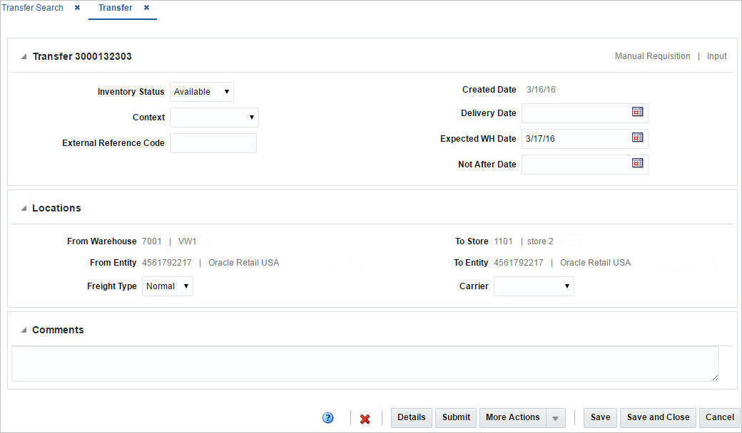

Table 3-2 Locations - Fields and Description
| Field | Description |
| From Store/Warehouse | This field displays the ID and description of the source location on the transfer. |
| From Entity | This field displays the transfer entity ID and description. |
| Freight Type | This field displays the type of freight. The options are: Normal, Expedite, and Hold. |
| To Store/Warehouse | This field displays the ID and description of the destination location on the transfer. |
| To Entity | This field displays the transfer entity ID and description. |
| Carrier | Select the carrier type from the list. |

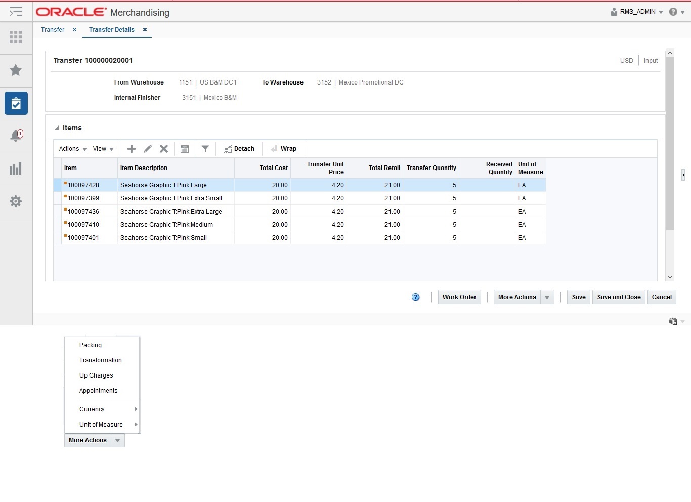

Use the More Actions menu to navigate to the following pages. The More Actions menu contains the following options.
Table 3-3 Transfer - More Actions Menu and Description
| Icon/Buttons | Description |

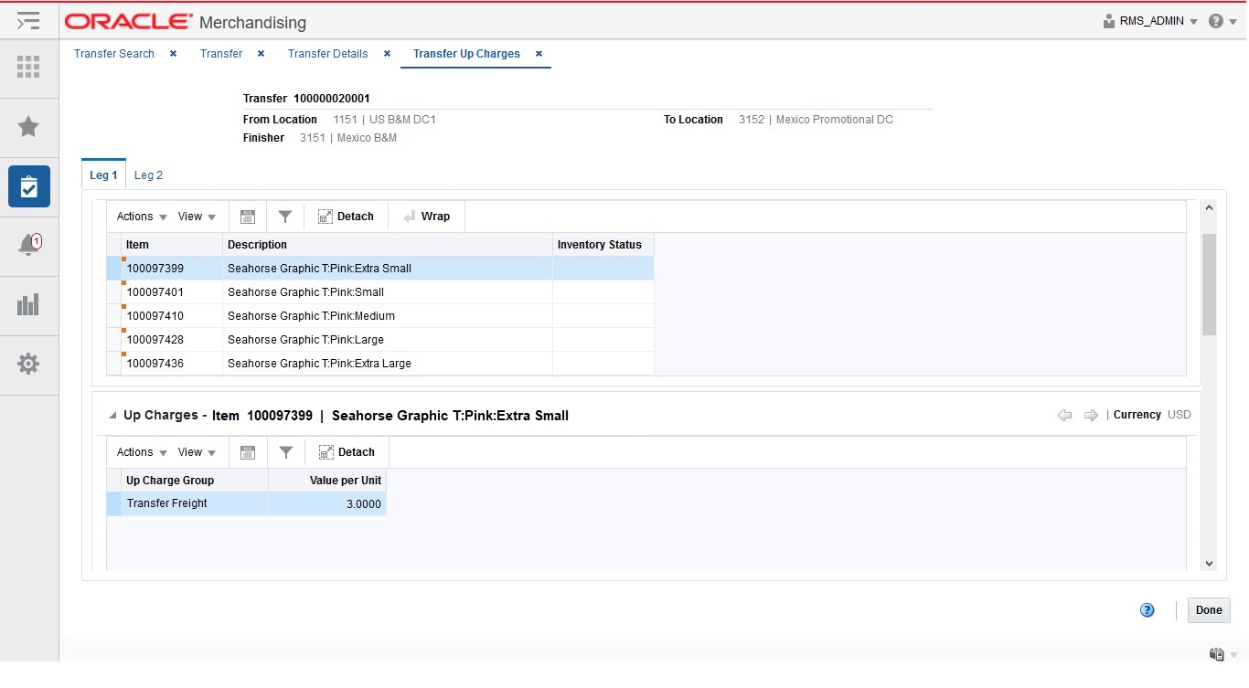

| Delete Up Charges | This option allows you to delete all the up charges associated with this transfer permanently. |
| More Actions | You can navigate to open the following pages by clicking the More Actions menu:
The Transfer Detail page allows users to add the list of items to be transferred.
You can access the Transfer Details page by clicking Details on the Transfer page.
In the Items section you can maintain the list of items on the transfer.

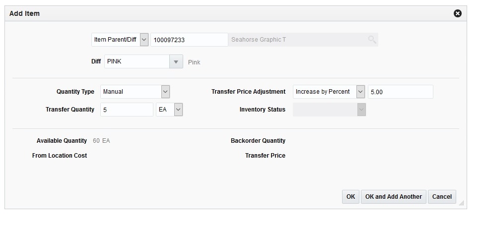

To add items to a transfer:
From the Actions menu, click Add or click the Add icon  . The Add Item pop-up appears.
In the Type field, select how you would like to add items to the transfer. The options are: Item, Item Parent, Item Parent/Diff, Item List and Upload List.
Depending on you selection, the next fields will change to allow you select items by desired level.
Item – You can enter, select or search transaction level items to add to the transfer.
Item Parent – You can enter, select or search items that are at the parent level to add its transaction level children items to the transfer.
Item Parent / Diff – You can enter, select or search parent level items, further there will be option to select differentiator. Based on the selection, all transaction level items associated with selected diff will be added to the transfer.
Item List – You can enter, select or search item list to add transaction level items contained therein to add to the transfer.
Upload List – This option allows you to upload data file containing items to add to the transfer. The file must be in csv format. There will be validations to ensure that only valid items are added.
In the Quantity Type field, select the quantity from the list. The options are Manual and Total Stock on Hand.
In the Transfer Quantity field, enter the quantity of the item that has to be transferred.
In Transfer Cost Adjustment field, select the type of transfer cost adjustment you want to make. The options are: Decrease by Percent, Decrease by Amount, Increase by Percent, Increase by Amount, Set Price.
Transfer Cost Adjustment is only enabled for the Intercompany transfer type.In the Inventory Status field, select the inventory status from the list.
In the Available Quantity field, the quantity that is available for transfer is displayed.
The From Location Cost field displays the cost for transferring an item from the location.
The Backorder Quantity field displays the customer back-orders for an item.
The Transfer Cost field displays the transfer cost and the cost varies based on the selected Transfer Cost Adjustment Type and the Adjustment Value.
Then choose one of the following options.
Click OK to add the item to the table and close the pop-up.
Click OK and Add Another to add additional items.
Click Cancel to reject all entries and close the pop-up.
Use the More Actions menu to navigate to other pages or to change the view of the items added to the transfer.
Table 3-4 Transfer Details - More Actions Menu and Description
| More Actions |
You can toggle between following currencies:
From Location
To Location
Primary
The currency toggle determines that the monetary values on the screen will be shown in From Location's currency or To Location's currency or Primary Currency.
You can toggle between the following units of measure:
Unit of Transfer - indicates the multiple of the standard UOM used for transferring
Standard UOM - is the unit of measure used for inventory for the item, such as eaches, meters, or pounds.
The UOM toggle determines weather the quantities on the screen will be shown in standard UOM or Transfer UOM.

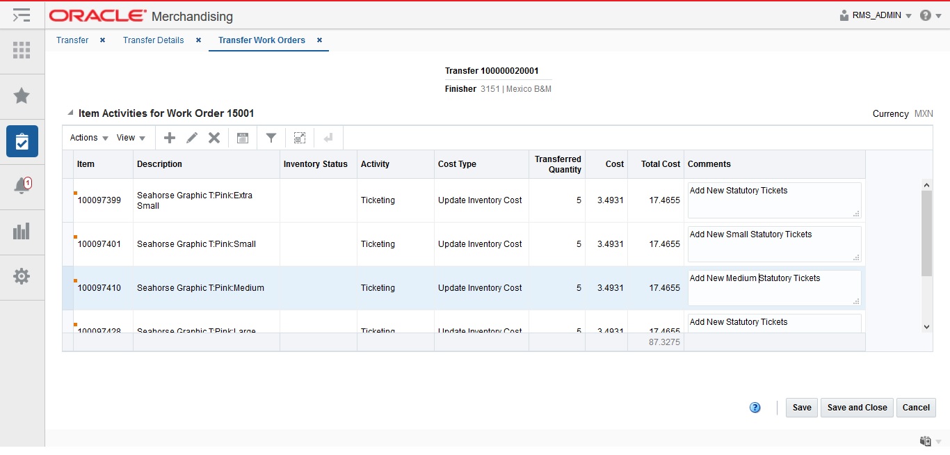

The Transfer Work Order allows you to define activities that are completed by the finisher before the transfer is completed. You must select a finisher when creating the transfer in order to access the page. Work order activities are required for each item when a transfer contains a finisher. To add a work order to a transfer, select the Work Order button on the Transfer Details page to display the Transfer Work Orders page.
At the top of the Transfer Work Orders page, the transfer number and finisher are displayed. Below this, the label of the Item Activity section displays the work order number. In addition the currency is displayed in the top right corner of the section label. Once activities are added, you can add comments for the item activity directly in the table.

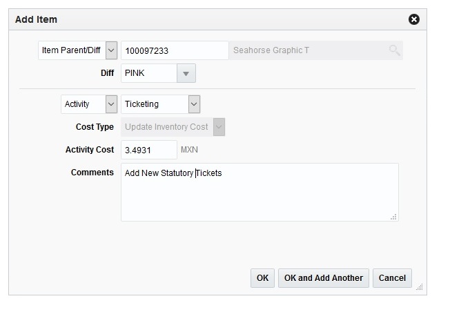

To add an activity for one or more items to the current work order, follow the steps below.
In the Item Activity section, select Actions > Add, or use the Add icon  . The Add Item pop-up appears.
Select an item type from the list. Then enter or search for the item.
In the Diff field, enter, select or search for the diff.
This field is only enabled, if you select the item type Item Parent/Diff.Select if you want to add an activity or template (a template is a pre-defined set of work order activities). Then select the corresponding activity or template.
In the Cost Type field, select the cost type from the list.
In the Activity Cost field, enter the costs.
In the Comments field, enter a comment, if necessary.
Click OK to add the item activity/template to the table and close the pop-up.
Click OK and Add Another to add additional item activities/templates.
In the Transfer Work Order page, save your changes.
To edit an item activity previously added, follow the steps below.
In the Item Activities section, select Actions > Edit, or use the Edit icon  . The Edit Item pop-up appears.
Edit the activity cost and/or the comments.
Click OK to add your changes to the table and close the pop-up.

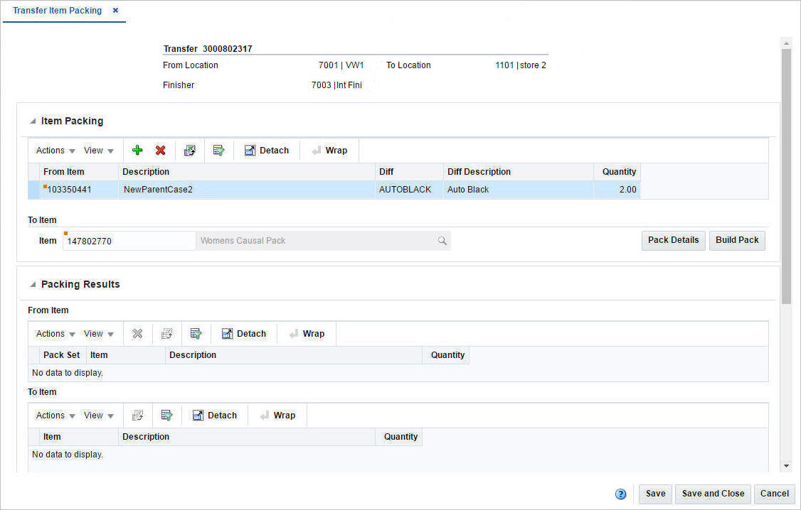

The Transfer Item Packing page allows you to send instructions to the finisher to tell them how items and packs should be shipped to the final location. For example, you may elect to have the finisher take individual bulk items and have them re-packed into specific pre-pack configurations.
The following packaging combinations may occur:
Pack to Components
| Pack 1 | becomes | Item 1 |
| Item 2 | ||
| Item 3 |
Pack to Pack
Complete Packs:
| Pack 1 made up of: | 2 of Item 1 | becomes | Pack 2 made up of: | 2 of Item 1 |
| 3 of Item 2 | 2 of Item 2 | |||
| 3 of Item 3 | 2 of Item 3 |
Packs with Remainders:
| 3 of Item 3 | 1 of Item 3 | |||
| Remaining items | 1 of item 2 | |||
| 2 of item 3 |
Components to Pack
| Item 1 | becomes | Pack 1 |
| Item 2 | ||
| Item 3 |
At the top of the page, the transfer number, from and to locations, and the finisher are displayed. The page also contains:
Header
The header displays the transfer number, the from/to location and the finisher.
The Item Packing section contains a table listing the "from" items that have been added and will be the starting point of the packing. It also contains the "to" item, which defines how the from items will be packed.
The Packing Results section shows the results of building a pack based on the information that was entered in the Item Packing section.
To pack an item on a transfer, follow the steps below.
Create a transfer.
For more information about how to create a transfer, see the start of the Transfers chapter.
Add a transfer work order activity.
For more information about how to add a transfer work order activity, see the Add a Work Order section.
In the Transfer Details page, select More Actions > Packing. The Transfer Item Packing page appears.
To add a pack and explode the pack item to its components, follow the steps below.
In the Item Packing section, select Actions > Add, or use the Add icon  . The Add Item pop-up appears.
In the From Item field, enter or search for the from pack.
Select the Explode Pack checkbox, to explode the pack.
The pack item will be exploded to its component items and displayed as a new pack set in the Packing Results section.

To change the pack, follow the steps below.
Click OK to add the item and close the pop-up.
In the To Item area, enter or search for the to pack item that is on the transfer.
Then click Build Pack. The new pack is created and displayed in the Packing Results section.
To view the pack details, click Pack Details. The Pack Item Details are displayed.
Then save your entries.

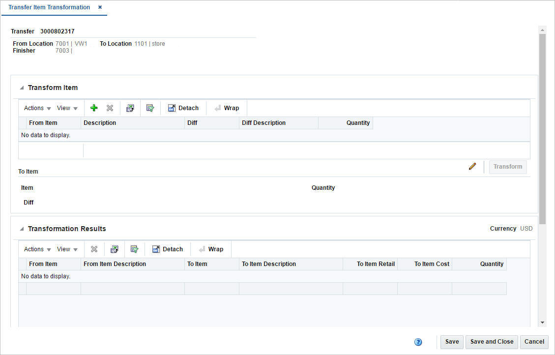

The Transfer Item Transformation page allows you to convert one item to another item at a finisher. You may change one item to a different item or you may consolidate multiple items into one item.
There are certain conditions that must be met before you complete an item transformation. When you transform the first item into a second item, both items must exist in approved status before you can complete the transformation. The entire quantity of item on a transfer must be transformed into the same item.
There are two types of item transformation that can occur:
| Item | becomes | item |
| One to One | ||
| Item 1 | becomes | Item 2 |
| Item A | becomes | Item X |
| Item B | becomes | Item Y |
| Item C | becomes | Item Z |
| Many to One | ||
| Item B | becomes | Item X |
| Item C | becomes | Item X |
The Transfer Item Transformation page displays the transfer number, the from and to locations, and the finisher at the top of the page.
The Transform Item section is visible if you are not in View mode and the Status is Input, otherwise the section is hidden.
The Transform Item section contains two sub-sections, the From Item table and the To Item area.
The From Item table displays the following fields by default:
From Item
Description
Diff
Diff Description
Quantity
The To Item area displays the item, item description, diff and diff description as well as the quantity.
You can edit the to item and diff in this area by clicking the Edit icon  .
You can finalize the transformation of the items in this area by clicking the Transform button.
The Transform button is only enabled if From Item and To Item sections are populated. When you click the button the Transform Item section is cleared, the items are transformed and displayed in the Transformation Results section.
From Item
Description
To Item
To Item Description
To Item Retail
To Item Cost
Quantity
To transform an item, follow the steps below.
Create a transfer.
In the Transfer Details page, select More Actions > Transformation. The Transfer Item Transformation page appears.
To add a from item, follow the steps below.
In the Transform Item section, select Actions > Add, or use the Add icon  . The Add Item pop-up appears.
In the From Item pop-up:
In the Item field, enter or search for an item. This field is a required field.
In the Diff field, enter, select or search for the diff. This field is only available if the parte item has diff.
In the To Item section:
In the Item field, enter or search for an item or parent item that you want the from item to become.
The to item you select must be an approved item.In the Diff field, enter, select or search for the diff. This field is only available if the to item is a parent item.
Click OK to add the from/to item and close the pop-up.
Click OK and Add Another to add additional from/to items.
Then click Transform. The items that have been transformed for the transfer are displayed in the Transformation Results section.
Save your entries.
To edit the "to" item before transforming, follow the steps below.
In the To Item area, click the Edit icon  . The Edit Item pop-up appears.
Edit the fields as necessary.
Click OK to add your change to the table and close the pop-up.
Click Cancel to reject the entries and close the pop-up.

The Transfer Up Charges page allows you to view the up charges that are associated with a specific transfer/item/from location/to location combination. Up charge groups are a combination of up charge components.
The Transfer Up Charges page displays the transfer and the from and to locations at the top of the page. And also includes the following sections:
The Item section displays the items on the transfers that have up charges defined, including information such as item, item description and Inventory Status.
For transfers with finishing, select the tab Leg 2 to view the item information of the second leg.
The Up Charges section displays up charge group and value per unit for the highlighted item.
The Next and Previous icon is displayed in the top right corner of the section, if the selected item is as pack to see the up charges for each item in the pack.

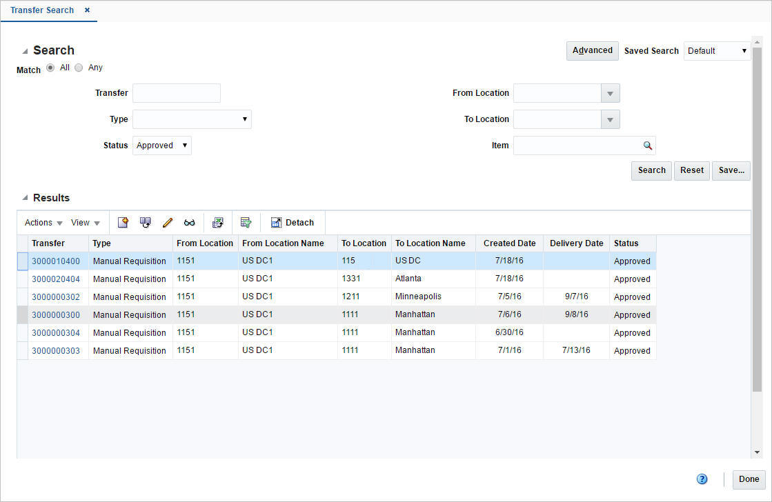

To manage transfers, access the Transfer Search page by selecting Inventory > Transfers > Manage Transfers, the Transfer Search page appears.
To search for a transfer:
Provide search criteria in the search section. The criteria can be provided either in Basic or Advanced mode, depending on the requirement. Basic is the default mode when the search page is entered.
Click Advanced to access the search panel in advanced mode. You can return to Basic mode by clicking Basic.
To search for a transfer through the basic search criteria.
Enter or select one or all of the following basic search criteria.
Table 3-6 Transfer Search - Basic Search Criteria
| Match option | Check radio button All or Any. All - only transfer matching all entered search criteria are shown. Any - transfer matching any of the entered search criteria are shown. |
| Transfer | Enter the transfer ID. |
| Type | Select the transfer type from the list. |
| Status | Select the status of the transfer. The options are: Input, Submitted, Approved, Closed, Deleted, and In Progress. |
| From Location | Enter, select or search for the location ID. |
| To Location | Enter, select or search for the location ID. |
| Item | Enter the item number or search for the item. |
For more information about searches, see Search Screens in the Oracle® Retail Merchandising Do the Basics User Guide.Click Search. The transfers that match the search criteria are displayed in the Results section.
Click Reset to execute the saved search.
Click Done to close the page.
To search for a transfer through the advanced search criteria:
Enter or select one or all of the following advanced search criteria. Click Add Fields to add more fields for the advanced search. To remove the field from the search, click the x right next to the field.
Table 3-7 Transfer Search - Advanced Search Criteria and Description
| Department | Enter, select or search for the department. |
| Class | Enter, select or search for the class number. |
| Subclass | Enter, select or search for the subclass. |
To narrow down the search, use the list next to the search fields. For example, determine if the entered value should equal or not equal the search result.
Click Reset to clear the search section and results.

To edit a transfer:
From the Tasks menu, select Inventory > Transfers > Manage Transfers. The Transfer Search page appears.
Select the transfer you want to edit.
From the Actions menu, select Edit or click the Edit icon.  . The Transfer page appears.
Make the necessary changes and click save your changes.
To maintain transfer Details follow the steps below.
Enter or select search criteria as desired to make the search more restrictive.
In the Transfer column, click the transfer link, or mark a record and select Actions > Edit, or use the Edit icon  . The Transfer page appears.
Editing Transfer Details Items
To edit transfer details items:
In the Items section, select the transfer details of the item you want to edit.
From the Actions menu, click Edit or click the Edit icon  .
Edit the quantity type and the transfer quantity as necessary.
Click OK to save the changes and close the page.
Click Cancel to reject your entries and close the page.
