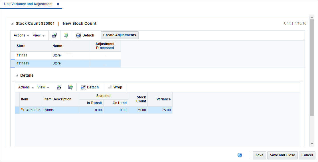

Unit Variance and Adjustment – this page allows you to view by location the count variances for each item. Only items that are outside the variance tolerance defined in system option will displayed. This is also the screen where you can accept the results sent from the store or warehouse so that the inventory adjustments are applied in Merchandising.

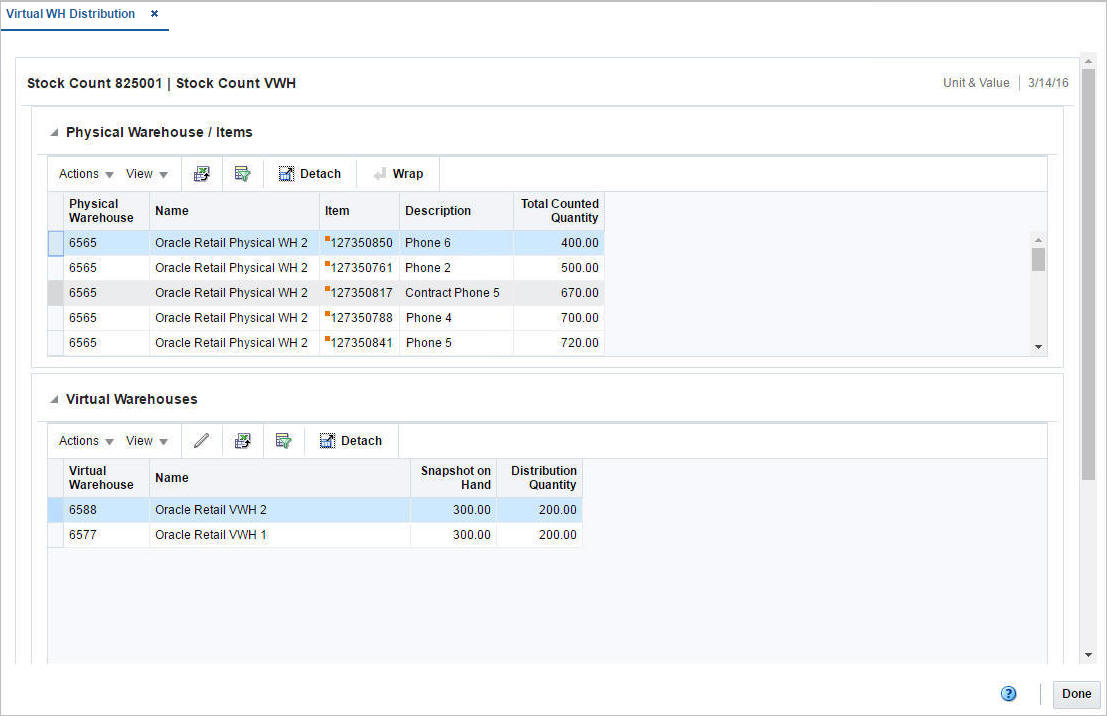

Virtual Warehouse Distribution – if the count is for a warehouse, then this page allows for adjustments to be made to how the results were distributed to virtual warehouses.

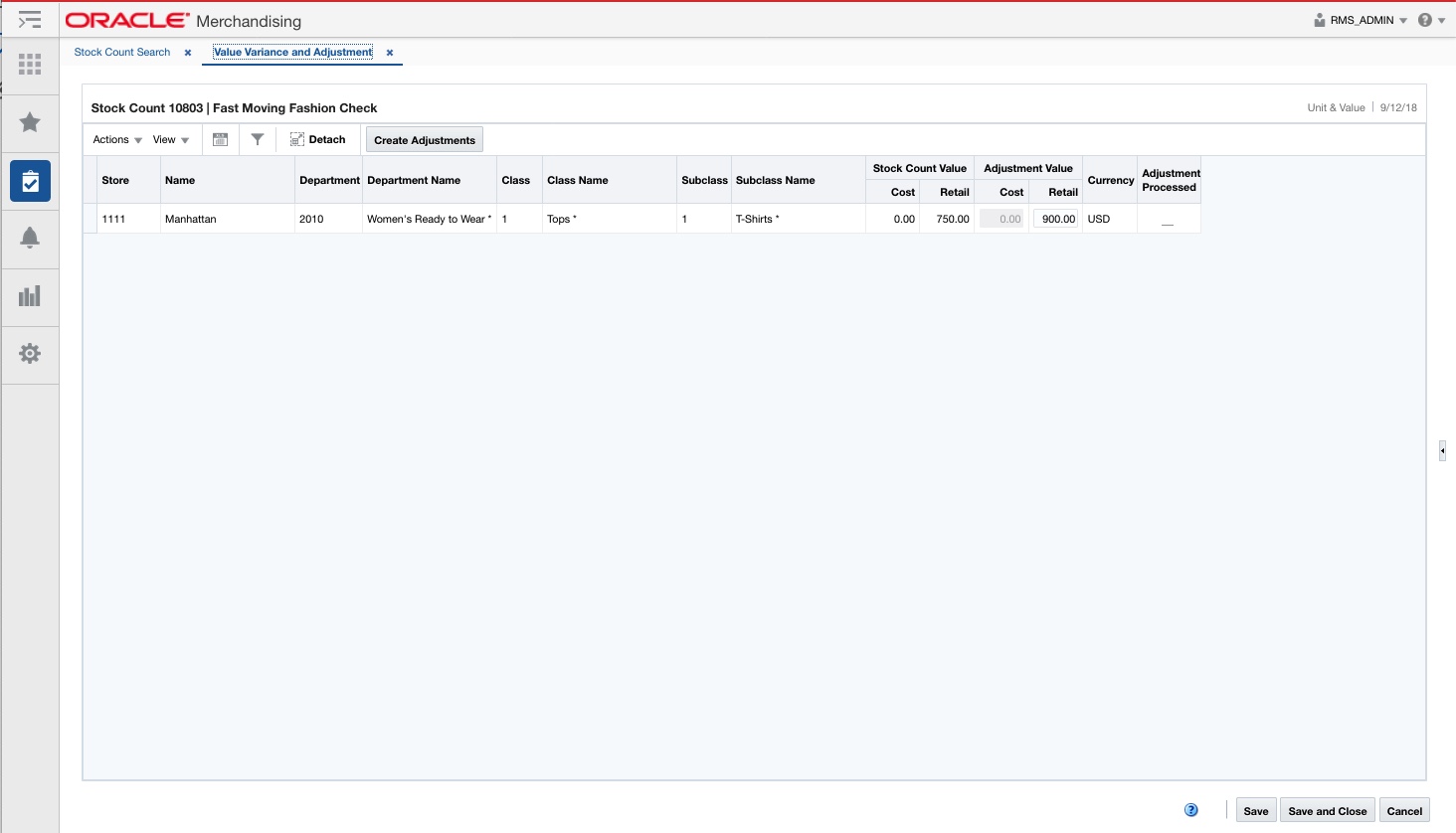

Value Variance and Adjustment – this page allows you to view the calculated value of the count results (cost or retail) by subclass/location and apply adjustments, as needed. The calculated value will be displayed only after the unit variances have been applied, however adjustments can be made and accepted in this page prior to that calculation occurring.

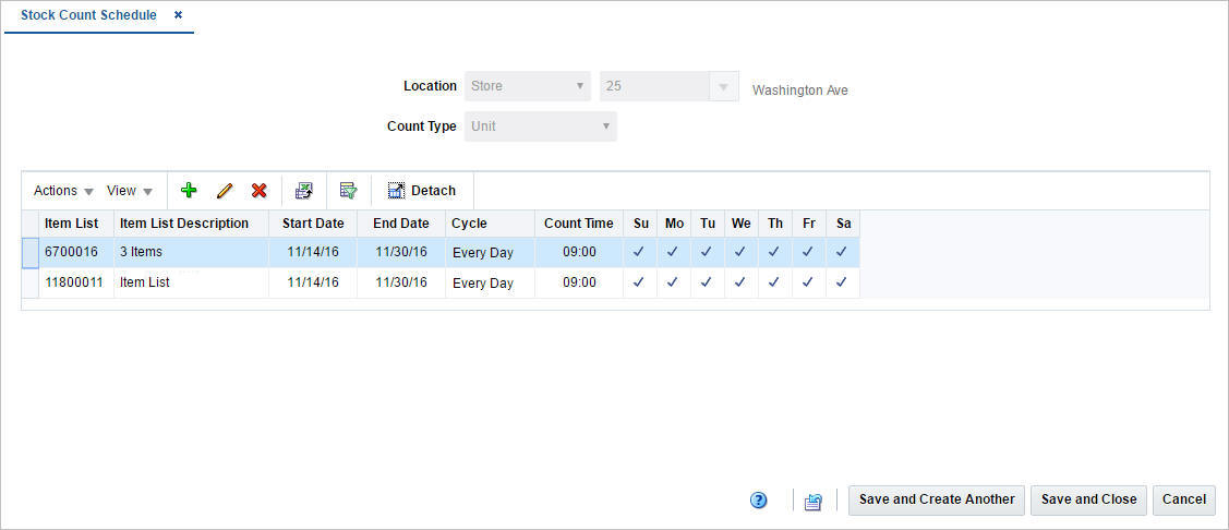

The Stock Count Schedule page allows you to maintain schedules for stock counts. You can schedule stock counts for a stockholding store, a warehouse, or all locations on a location list. The stock can be counted in units or in units and monetary value. Depending on system options, the monetary value may be either retail or cost. You can schedule stock counts for every day, every week, or every two or more weeks. You can also designate the dates on which a schedule becomes effective and expires.
To access the Stock Count Schedule page:
From the Tasks menu, select Inventory > Stock Counts > Stock Count Schedule. The Stock Count Schedule page appears.
In the Location field, select the location type from the list. Then enter, select or search for the location.
In the Count Type field, select the type of count. The options are: Unit, Unit & Value.
Once you have selected a location and count type, the table will display all currently scheduled stock counts for that combination. If no stock counts have been scheduled, the table will be blank. You can add, edit or delete stock counts in this table.

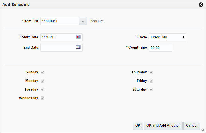

To add a stock count schedule, follow the steps below.
Select Actions > Add, or click the Add icon  . The Add Schedule pop-up appears.
Based on the selected count type you need to enter, select or search for either an Item List or a Department/Class/Subclass. The fields Item List and Department are required fields.
In the Start Date field, enter the date on which the schedule becomes effective, or click the Calendar icon to select a date.
In the End Date field, enter the date on which the schedule expires, or click the Calendar icon and select a date.
In the Cycle field, select the frequency of the stock counts. This is a required field.
In the Count Time field, select the day of the week for the stock count. This is a required field.
Select the days for the stock count below.
If the cycle is every day, all of the days are automatically selected. If the frequency is every week, you can select more than one day.Then choose one of the following options.
Click OK to add the stock count schedule to the table and close the pop-up.
Click OK and Add Another to add additional stock count schedules.
Click Cancel to reject all entries and close the pop-up.

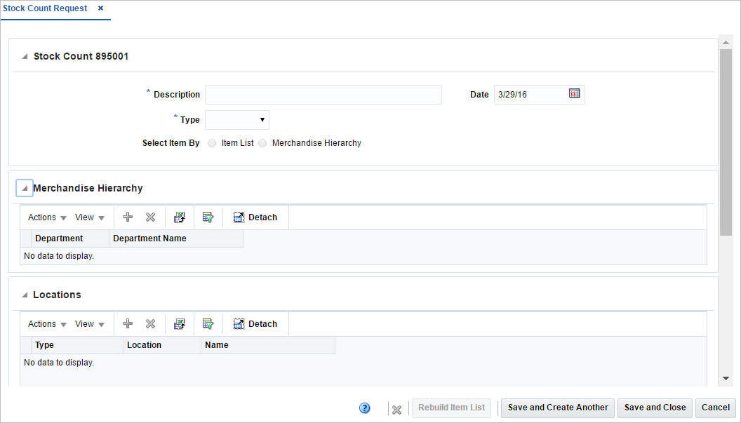

The Create Stock Count Request option opens the Stock Count Request page. In the Stock Count Request page you can request stock counts. You can create unit counts by item list level or product group level (all departments, department, class, or subclass) and unit & value counts by product group level. If a department, class or subclass is selected for either of the count types, one or more departments, classes or subclasses can be added to the count.
For unit counts, you can only select the option All Departments for the product group level for warehouse.Locations are added to the count individually or by selecting a group of locations, such as a location list or all stores. A count can be for either stores or warehouses, but not both. Any stockholding store can be added to a count, including both company and franchise stores. If multiple locations are added to the count, then the count will only be able to be finalized once the counts for all locations are completed.
To request a stock count:
From the Task menu, select Inventory > Stock Counts > Create Stock Count Request. The Stock Count Request page appears.
In the Description field, enter a description for the stock count. This field is a required field.
In the Date field, enter the scheduled date for the stock count, or use the Calendar icon to select a date.
In the Type field, select the stock count type from the list. Possible options are Unit and Unit & Value.
In the Select Item By section, select either the Item List or Merchandise Hierarchy option.
If you select Unit > Item List:
The Item List field appears. Enter, select or search for the item list for the count.
If you select Unit > Merchandise Hierarchy:
The Hierarchy Level field appears. Select the hierarchy level from the list.
If you select Unit and Value:
The Select Item By section defaults to Merchandise Hierarchy. In the Hierarchy Level field, select the hierarchy level from the list.
If you select All Departments in the list, the Merchandise Hierarchy section is not available. If you select Department, Class or Subclass, the Merchandise Hierarchy section is displayed so that you can then add items to the count through the department, the class and the subclass.The top of the Stock Count page contains the following fields.

To add a merchandise hierarchy to the stock count request, follow the steps below.
In the Merchandise Hierarchy section, select Actions > Add, or use the Add icon  . The Add Merchandise Hierarchy pop-up appears.
In the Department field, enter, select or search for the department. If you select the hierarchy level Department, Class, or Subclass, this field is a required field.
In the Class field, enter, select or search for the class. If you select the hierarchy level Class, or Subclass, this field is a required field.
In the Subclass field, enter, select or search for the subclass. If you select the hierarchy level Subclass, this field is a required field.
Then choose one of the following sections.
Click OK to add the merchandise hierarchy and close the pop-up.
Click OK and Add Another to add additional merchandise hierarchy levels.
To add locations to the stock count request, follow the steps listed below.
In the Locations section, select Actions > Add, or use the Add icon  . The Add Locations pop-up appears.
In the Location field, select a location type from the list. Then enter, select or search for the location. This field is a required field.
Click OK to add the location to the table and close the pop-up.
Click OK and Add Another to add additional locations to the stock count request.
Stores, Warehouses and External Finishers cannot be added to the same Count.Click Cancel to reject all entries and close the pop-up.

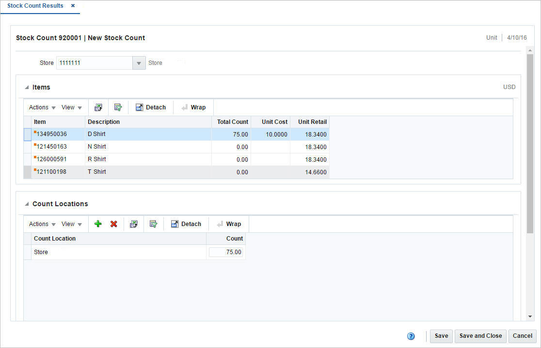

The Stock Count Results page allows you to manually enter the results of a stock count. You can also view and edit unprocessed stock counts at a location.
Corrections can be made to the physical count quantities received from the store or warehouse in this page. However, to actually adjust the quantities, you must go to the Unit Variance and Adjustment page.
The Stock Count Result page contains the following sections.
The top of the Stock Count Results page displays the stock count and the stock count name. In addition the type and the date of the stock count are displayed in the top right corner of the section.
Below the location type, the location and the location name are displayed, once you select the location. Other sections on the screen include:
The Items section displays the items in the count and the total count quantity for the item at the location, as well as the basic item information such as item description, unit cost and unit retail.
The Count Locations section displays the location inside the store or warehouse where the item was counted and the quantity counted at this location.
You can edit the Count column directly in the table to update the count quantity for a count location. If the count quantity for a location is updated, the Total Count column in the first table is updated to reflect the new total.
To edit the result of a stock count, follow the steps below.
From the Tasks menu, select Inventory > Stock Counts > Manage Stock Counts. The Stock Count Search page appears.
Enter or select search criteria as desired to make the search more restrictive.
Click Search. The stock counts that match the search criteria are displayed in the Results section.
Select a stock count in the table.
Then select Actions > Results. The Stock Count Results page appears.
You can also access the Stock Count Results page through the Unit Variance and Adjustment page.The stock count ID, description, type, date, location type and location of the selected stock count are displayed. In addition all of the items at the location appear in the tables by default.
For more information about this page, see the Review Unit Variances and Accepting Unit Counts section.
The stock count ID, description, type and date are displayed. The location type defaults to either Store or Warehouse. Enter, select or search for the location.
In the items section select an item. The count locations and counts for the selected item are displayed in the Count Locations section.
In the Count column, update the count quantity as necessary.
Save your changes.

In the Stock Count Results pop-up, save your entries.

To adjust the stock on hand after a stock count, follow the steps below.
Then select Actions > Unit Variance and Adjustment. The Unit Variance and Adjustment page appears.
In the Stock Count section select a location. The item information is displayed in the Details section.
Select Actions > Create Adjustment, or use the Create Adjustment button.
You are prompted, if you want to create a stock adjustment for the selected location. Confirm with Yes.
The adjustment are made during the nightly batch process.
Save your entries.
When a stock count is performed for a warehouse, an adjustment can be made if the distribution of inventory to the virtual warehouse performed during the upload of the count to Merchandising was incorrect. You can carry out this adjustment in the Virtual WH Distribution page.
The Virtual WH Distribution page displays the stock count ID and description at the top of the page, along with the type of count and the count date. It also includes the following sections:
The Physical Warehouse/ Item section displays all the physical warehouse/items pertaining to the selected stock count on entering the page.
The Virtual Warehouses section displays all virtual warehouses associated to the physical warehouse that is selected in the Physical Warehouse/Items section, and displays a snapshot of the inventory when the count occurred.
You can distribute the on-hand inventory at the physical warehouse into the virtual warehouse inventory.
To adjust the distribution, follow the steps below.
Restrict your search to stock counts for warehouse.
Then select Actions > Virtual WH Distribution. The Virtual WH Distribution page appears.
In the Physical Warehouse/Item section, select a physical warehouse. All virtual warehouses associated with the selected physical warehouse are displayed in the Virtual Warehouses section.
In the Virtual Warehouses section select Actions > Edit, or use the Edit icon  . The Edit Distribution pop-up appears.
The table displays all of the virtual warehouses for the selected physical warehouse. The snapshot on hand and current distribution quantity are displayed for each virtual warehouse. The new distribution quantity column defaults to the current distribution quantities.
In the New column, update the new distribution quantity, if necessary.
Click OK to add your changes to the table and close the pop-up.
In the Virtual WH Distribution pop-up, save your entries.
A Unit & Value stock count is often an annual count that can be used to adjust the financial systems in a corporate merchandising system, in addition to updating inventory positions. Unit & Value stock counts are carried out either for an entire location or by product hierarchy, that is department, class or subclass level.
Once the units have been accepted for Unit & Value counts, the value of the count must also be reviewed and accepted.
The page displays the total cost and total retail as calculated in the stock count and the total adjusted cost and retail, if any adjustments have been made, for each department/class/subclass at a location.
If adjustments need to be made, you can make adjustments to the total cost or retail value of the count, based on the accounting method for the department, for each subclass/location. You can also accept the value of the count.
The label at the top of the page displays the stock count and the stock count name. In addition the type and the date of the stock count are displayed in the top right corner of the section.
The table displays the location and stock count value information. The table contains each location and department/class/ subclass combination of the stock count.
Based on the used accounting method for the Department, you can either edit the Cost or Retail column directly in the table.
To save the adjustments, click the Save/Save and Close button. This will check the Adjustment Processed checkbox for all selected locations and disable the Adjustment Value – Cost or Retail field.
To adjust the cost or retail after a stock count, follow the steps below.
Then select Actions > Value Variance and Adjustment. The Value Variance and Adjustment page appears.
In Cost or Retial column update the values of the locations as necessary.
Select one or more records in the table.
Then select Actions > Create Adjustment, or use the Create Adjustment button.
You are prompted, if you want to create adjustments for the selected location(s). Confirm with Yes.
Save your entries.
