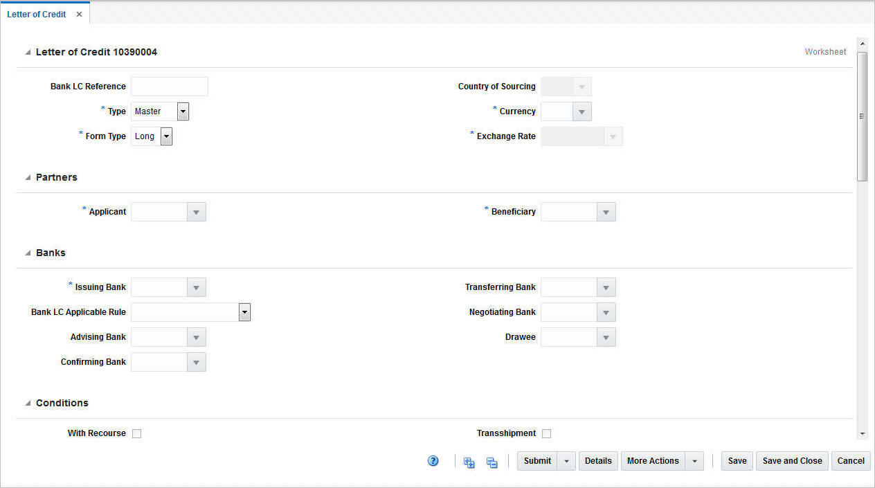

The Letter of Credit window allows you to view, create and edit a letter of credit. The window contains the following sections:
The Letter of Credit ID is populated automatically. The status of the letter of credit is displayed in the top right corner of the window, for example, Worksheet.
In the Letter of Credit section enter the following data.
Table 2-1 Letter of Credit - Fields and Description

In the Partners section enter the following data.
In the Banks section select, enter or search for the banks that are involved with the letter of credit transaction.
