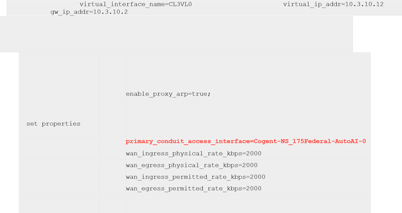

This feature may be set in the Configuration Editor, as shown in Figure 11 below. Note that the first configured WAN link access interface is set to be the Primary by default and additional access interfaces are defined to be excluded. The user would then be expected to verify the primary access interface link, as well as any interfaces to be configured as secondary. When the primary access interface gateway is not reachable, the appliance would use the access interface configured as secondary.
For more information on the Oracle SD-WAN Edge Configuration Editor, please see the APN Configuration Editor User's Guide.
These interfaces are used to define which gateway the appliance would use to forward conduit frame for the corresponding WAN link. These options are defined under the WAN link, Set Properties field of a WAN link definition.
To edit the configuration manually, the options associated with this feature are included below:
add access_interface name=CL3_WL0_access_interface_1
The Proxy ARP capability is configured under the Access Interface and is shown above. “True” would indicate Proxy ARP is enabled and “false” would indicate that the feature is disabled for the Access Interface. Proxy ARP needs to be enabled for local side subnets.
primary_conduit_access_interface = Text
The name of the access interface to be used as the primary access interface for this WAN Link. Mandatory.
secondary_conduit_access_interface = Text
The name of the access interface to be used as the secondary access interface for this WAN Link.
