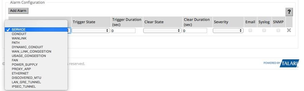

Edge 5.1 introduces a new Alarm System that streamlines the configuration and number of severity based alerts for network administrators. Now you can configure contextually-based alarms with specific criteria for triggering and clearing alarm states. To configure an Alarm:
- Under Integrate Configure Alarms, click the Add Alarm button.
- Select an Event Type from the drop-down menu.
Figure 1: Select Event Type
