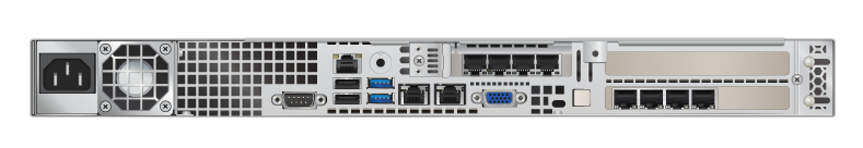

7.1 introduces three hardware variations for the E1000 in the form of optional expansion cards. Customers may order either four additional fail-to-wire Gigabit Ethernet ports or two 10 Gigabit Ethernet fiber ports. To determine which expansion card (if any) is installed on the appliance, check the number of Ethernet interfaces under Manage Appliance > Local Network Settings:
Hardware Option |
Ports |
E1000 without expansion card |
AUX, MGT, interfaces 1-8 |
E1000 with 10G expansion card |
AUX, MGT, interfaces 1-10 |
E1000 with FTW expansion card |
AUX, MGT, interfaces 1-12 |

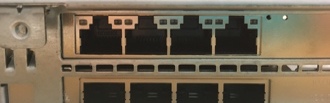

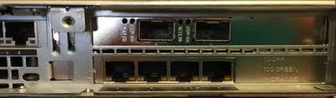

Port Labelling for Expansion Cards
Port 9
Port 10
10G Fiber (2 Port) Expansion Card:
The E1000 with 10G fiber expansion card does not ship with SFPs. The following modules are supported in conjunction with this card:

Port 9
Port 12
Port 11
Port 10
Fail to Wire Copper (4 Port) Expansion Card:
The configuration editor will not detect which expansion card (if any) is installed on an E1000, and will offer port 1 – 12 for all E1000s. Before beginning configuration for an E1000, please verify the physical ports on the appliance. For an E1000 with no expansion card, only configure ports 1 – 8. For an E1000 with the 10G fiber expansion card, only configure ports 1 – 10; ports 9 and 10 should not be configured for FTW. For an E1000 with the FTW expansion card, all 12 ports may be configured.If a configuration that does not match the available hardware is applied to an E1000, the Talari service will be disabled. Once a mismatched configuration has been applied to an E1000, a corrected package must be applied through Local Change Management before the service will start. Alternately, the appliance may be factory defaulted and a corrected configuration applied using the Easy 1st Install process. The Talari service will be disabled until a corrected package is applied.
