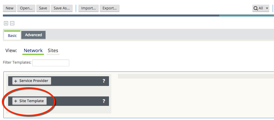

To create a Site Template using Aware, begin on the Basic tab, select the Network view, and click the + Site Template button.
Figure 1

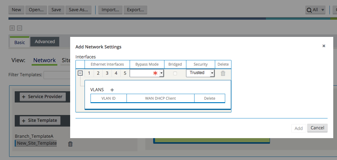

Here, you will select which Ethernet Interfaces should be used, set the Bypass Mode, choose whether to bridge the Interfaces, pick a Security setting, add any required VLANs, and set the WAN DHCP Client option. Click the Add button and observe the New_Site_Template now appears on the left-hand side of the page. To change the template name or edit any of its settings, simply click on it.
Figure 2

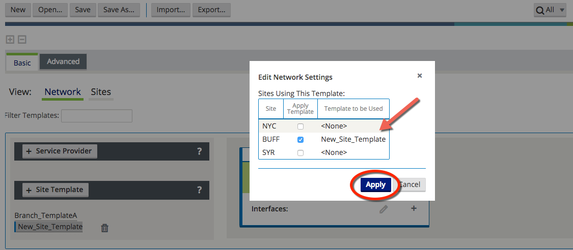

The user will then select which sites should begin using the template.
Figure 3

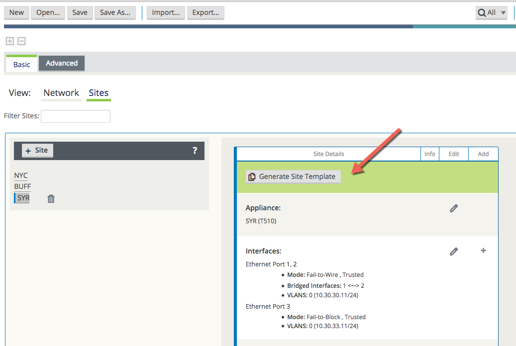

Additionally, users may create a Site Template based on an existing site within the configuration. To do so, change the view to Sites, select the branch site name, and click Generate Site Template.
Figure 4

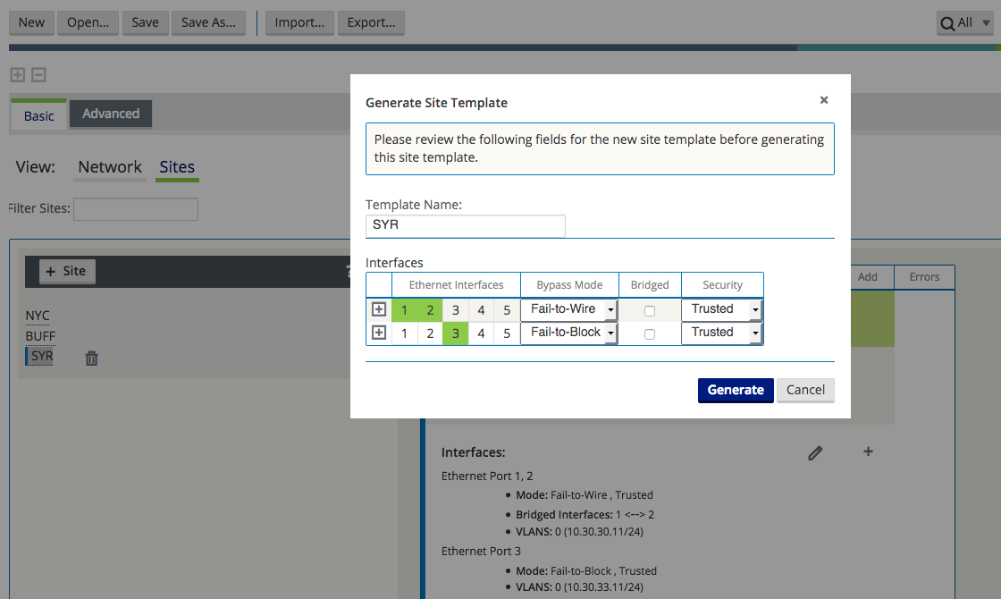

In this example, a new Site Template from the existing site, “SYR”. You can confirm the settings in the pop up window and change the template name. The new template has been named Branch_TemplateA.
Figure 5

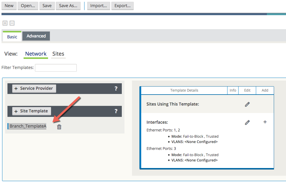

Observe Branch_TemplateA now appears on the Network view page.
Figure 6

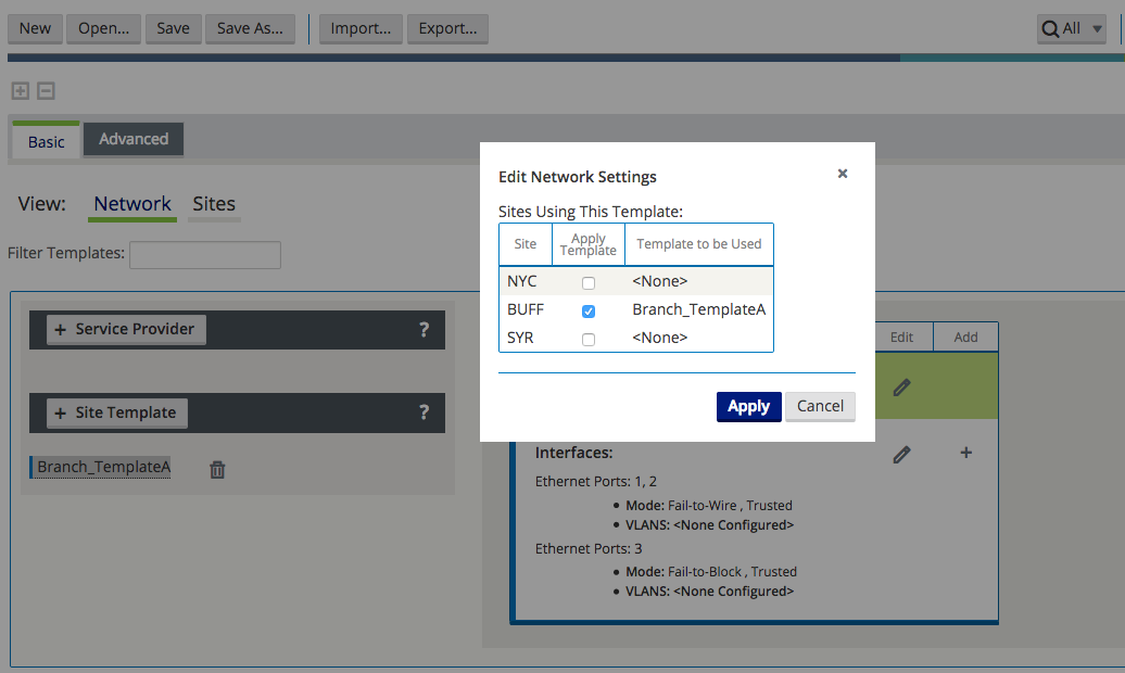

Assign the new template to a site. In the example below, Branch_TemplateA has been assigned to branch site “BUFF”.
Figure 7

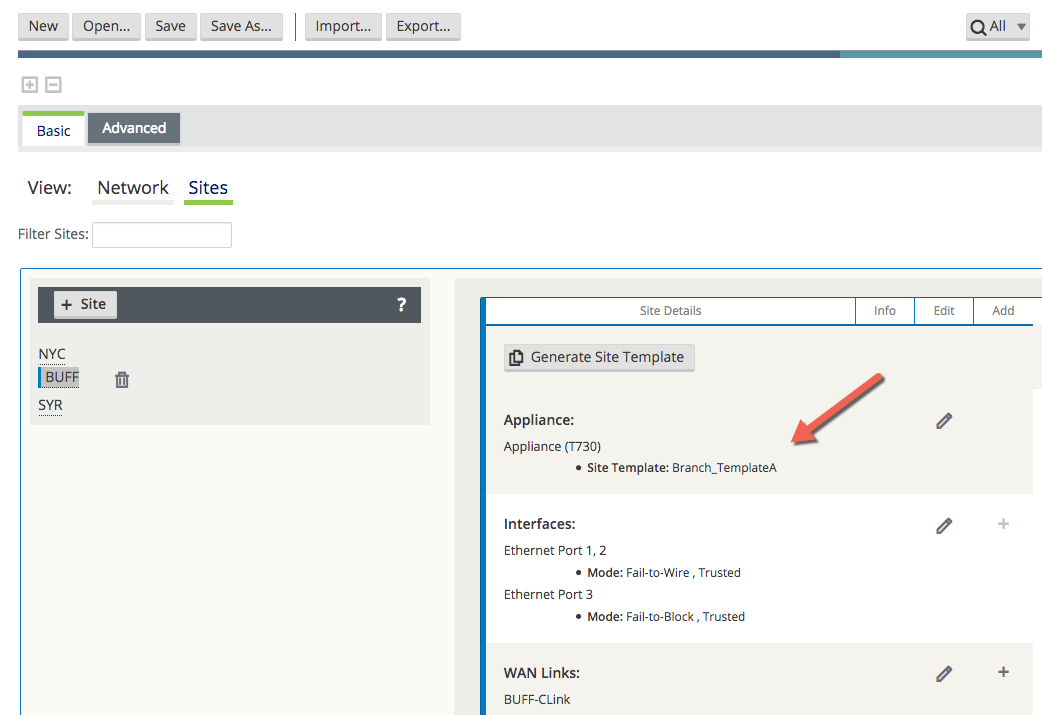

Back on the Sites view, site “BUFF” shows it has been assigned to Site Template Branch_TemplateA.
Figure 8
