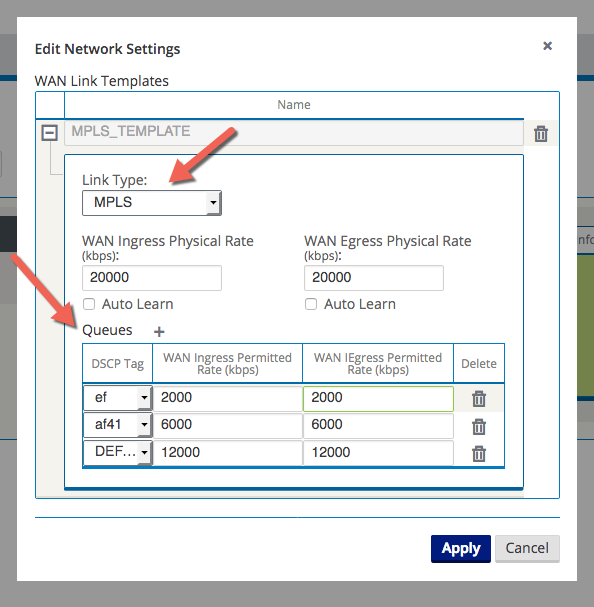

Select the Link Type from the drop down and enter the WAN Ingress and Egress bandwidth rates. If your WAN Link is an MPLS link, you will have the ability to enter up to 8 queues based on DSCP Tag.

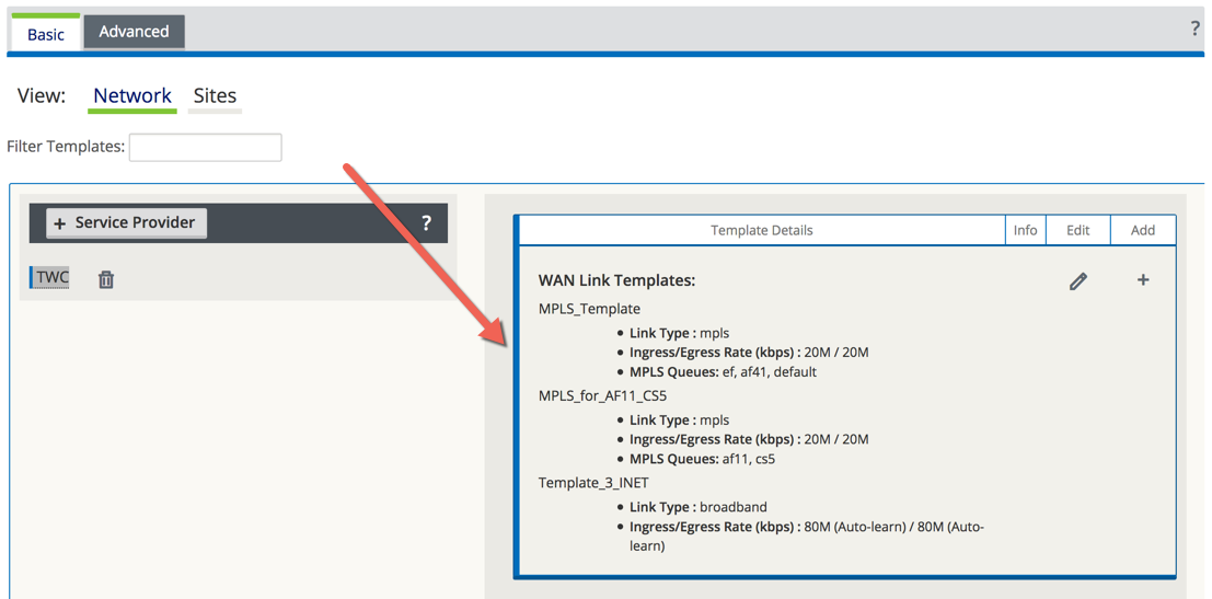

The user may define multiple WAN Link Templates per Provider. Three Templates are shown in the example below for Provider “TWC”, but the user may configure as many as thirty-two.

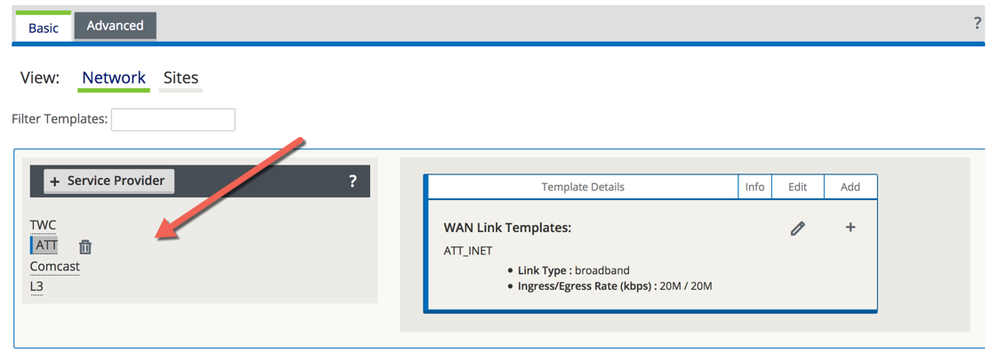

The user may also define up to twenty Service Providers, although only four are shown in this example.

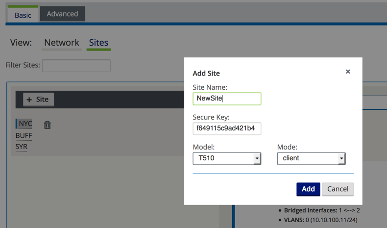

To create a new Client site using your WAN Link Templates, select the Sites view then the + Sites button.
Name your new Client site, select the Model and Mode, then click Add. A box will appear on the right-hand side of the screen allowing you to select some basic configuration options for your new Client. Click the + icon next to WAN Links then choose which WAN Link Template to use.
