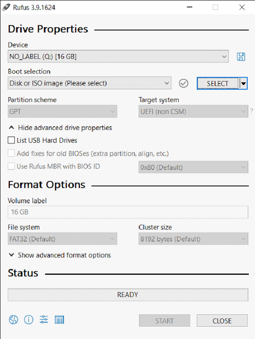

  6. Click SELECT and choose the file that you downloaded from MOS. The downloaded file is in compressed format (.gz). Do not uncompress it.
    Create a USB Drive from Windows - Drive Properties
  7. Click Start.
