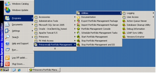

The Start Menu and Server Utilities
PPM can be installed on a single computer (server), or in a scale-out configuration. In a scale-out configuration, different components run on different servers. For detailed information about scale-out configurations, including the definition of front-end and back-end servers, refer to the Primavera Portfolio Management Install and Upgrade Guide.
Some of the operations described below apply only to front-end, only to back-end, or to all servers. Also, some of these operations need to be performed on all the servers that participate in a scale-out environment. This is specified in a note for each operation.
PPM administrators will perform common tasks, such as using the PPM console, scheduling tasks, and so on.
Related Topics
Using the PPM Console
Scheduling Tasks
Starting PPM
Stopping PPM
Stopping PPM and IIS
Changing Global Configurations
