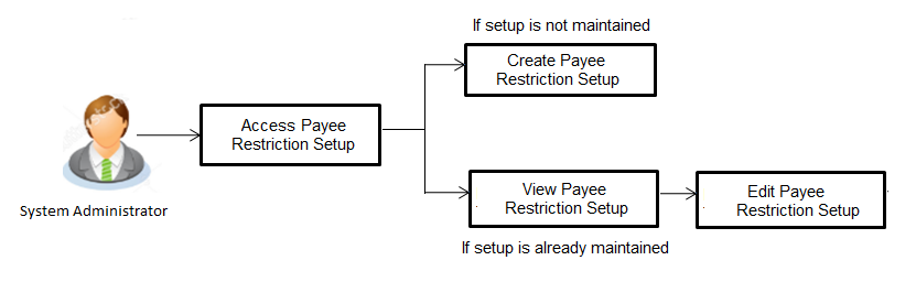

Features supported in Application
Payee Restriction Setup maintenance is created only once at the 'Day 1' configuration by the System Administrator. However it can later be viewed and modified.
This option allows an administrator to:
Workflow
How to reach here:
System Administration Dashboard > Payments > Payee Restrictions
OR
System/ Bank Administration Dashboard > Toggle Menu > Payments > Payee Restrictions
